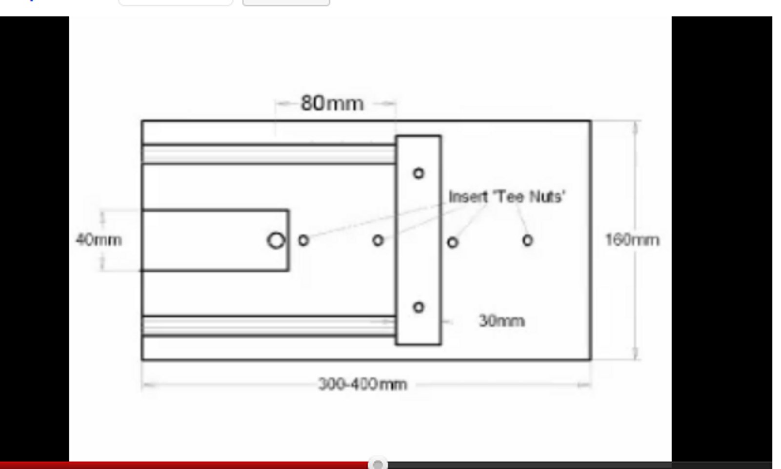

I've built a circle cutting jig for my plunge router based on the attached. I've added aluminium guides down each side of the base plate and it is very secure.
What I need is a pivot pin; one that canned be screwed into place into several points along the length of it.
Does anyone have any suggestions, please?
Frank

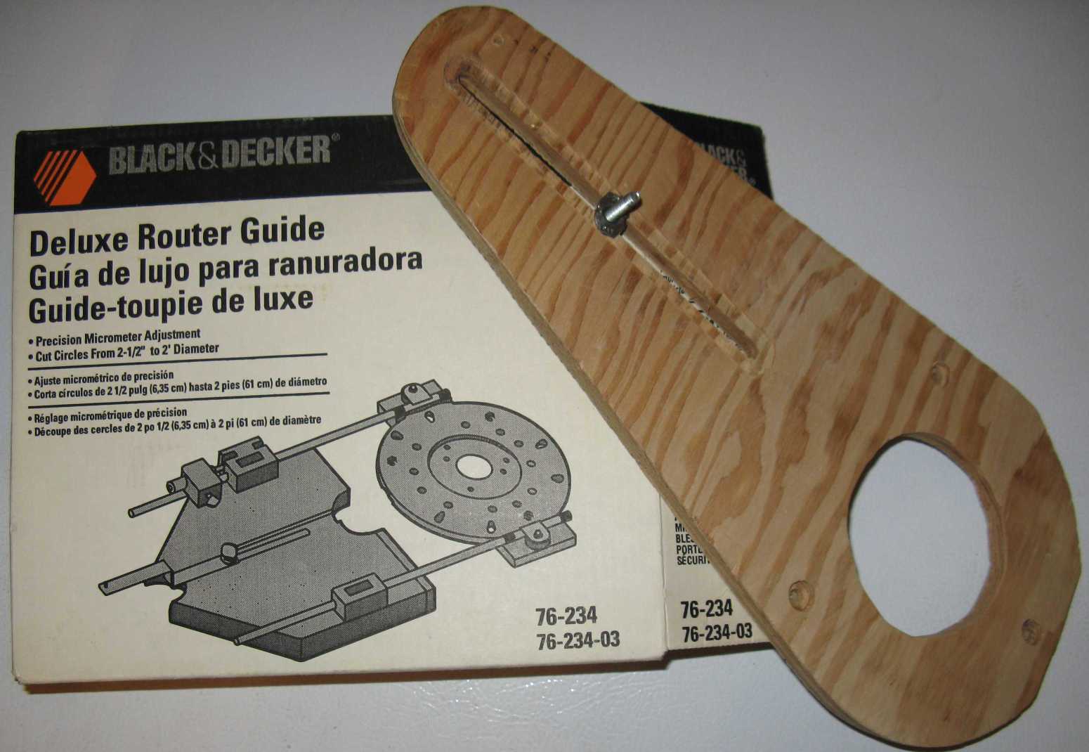

I use a non-plunge router, but it's a vintage B&D Pro (same as DeWalt but not yellow) with the rack and pinion depth adjust which can be lowered easily. A quarter-inch straight carbide bit does the job. I've tried a spiral upcut bit, which ejects material from the groove, but doesn't make as clean a cut on some materials.
For big driver holes, I use a DIY circle guide based on something I saw in Speaker Builder. Scrap plywood with a 1/4" slot and a wider recess. In the slot goes a T-nut with the barbs cut off, a long bolt and a washer. The bolt is the pivot. Easy to make if you have a router and a 1/4" straight bit.
For small drivers, I bought a Black & Decker guide that has an offset pivot that allows putting the pivot under the router footprint. Not my first choice for big holes.

See the picture of my plywood circle guide. Just a slot with a T-nut and a bolt. Infinitely adjustable. It needs a relatively big pivot hole, but it fits securely with very little play.
Apart from that... stick a bolt through the T-nut and lock it in place with a wingnut.
