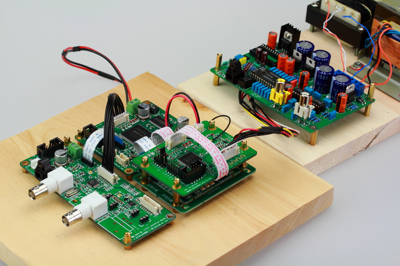

Ian,
Testing 24/192 with PCM1704 NOS was succesful.
Aparently, I can reproduce 24/384 because a 192 kHz Track was reproduced with SoX and upsampling 2X was enabled.
Regards.
Luis.

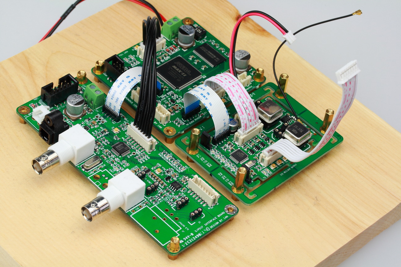

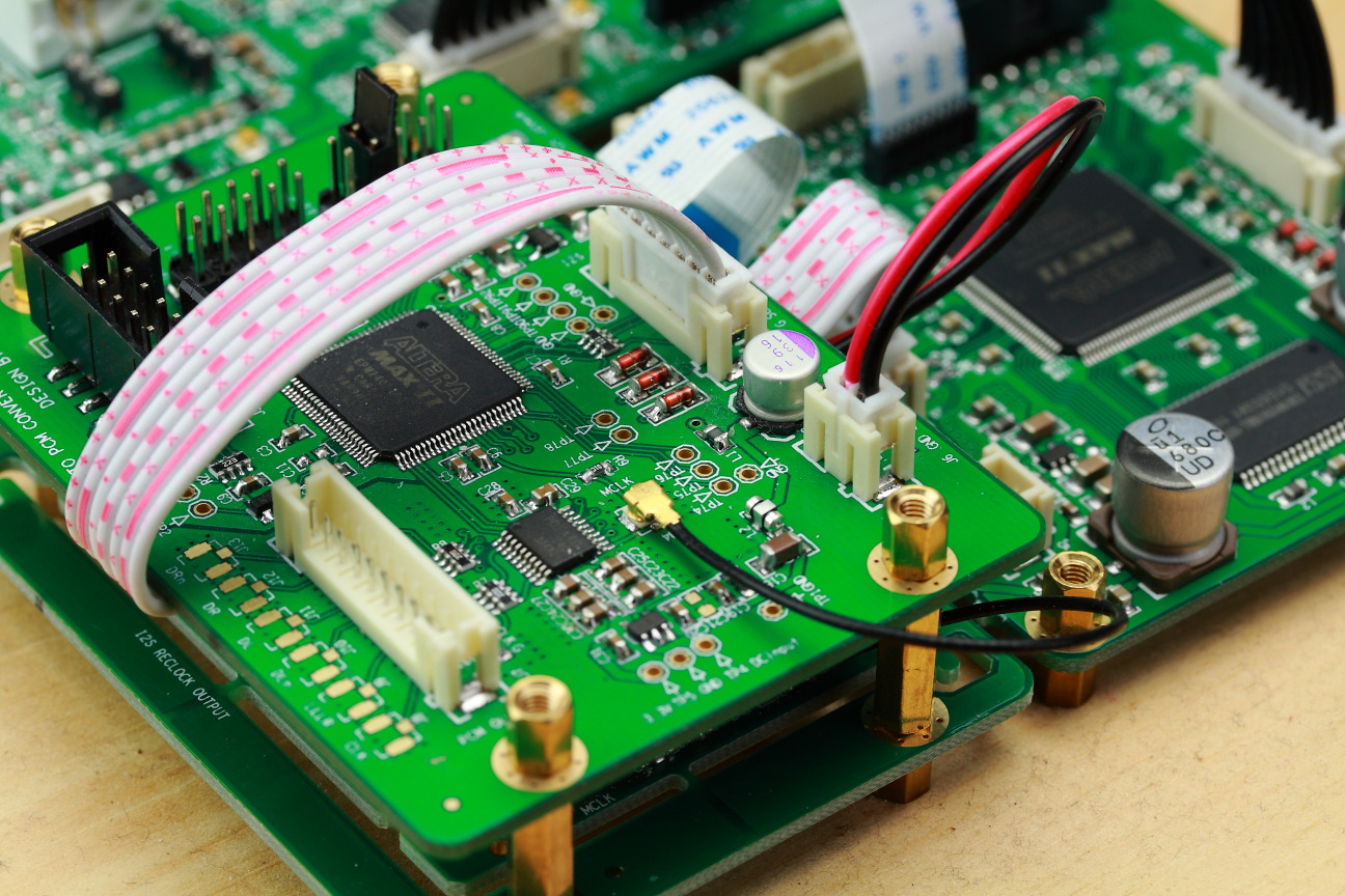

Confirmed TDA1541A works fine with the PCM daughter board from 44.1 to 192 KHz
I just came across getting a TDA1541A DAC board, so I can confirm the daughter board TDA1541A logic by myself.
TDA1541A configurations:
Pin27 connected to -5V (VDD1): simultaneous mode
Pin1 LE to LLLR
Pin2 BCK to CLK
Pin3 DATAL to DL
Pin4 DATAR to DR
I2S to PCM daughter board configurations:
JOB(IO7) short (offset binary format),
all other jumpers keep open (16bit mode)
Testing went through all the conditions:
Fs: 44.1KHz, 48KHz, 88.2KHz, 96KHz, 176.4KHz, 192KHz,
MCLK: 22.579, 24.576, 45.158, 49.152 MHz,
Without and with FIFO.
It works perfect on all conditions. 192 KHz sounds much better than 44.1 KHz, impressive. This 1541 board used to work with SAA7220P digital filter, so I think it doesn’t have good NOS LPF. That might be one of the reasons. Just hope good software based up-sampling plug-in can boost 44.1K play back perfromance. That’s one of the goals of the I2S to PCM daughter board.
Some comment:
1, Continuous clock mode doesn’t work for TDA1541, has to be at stopped clock mode, no sound otherwise.
2, JTAIL and JLEAD are also no work for TDA1541, Have to keep all of them open.
3, To get better signal quality, u.fl coaxial cables are highly recommended for the connections between DAC and the daughter board
This DAC was just for confirming the PCM daughter board logic working for TDA1541. Just hope somebody else can do more research on it with higher standard 1541 DAC and better clock.
