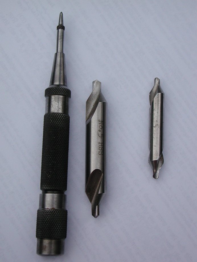

My drill bits no longer wander off........
A few accessories that will help with your hole placement:
An automatic center punch. These are very handy; a spring loaded gizmo that goes "snap" when you push it into the material leaving a nice little center mark to aim the drill bit into. Turning the barrel changes the spring load & force making larger or smaller divots in the material.
Home Depot and others sell General brand punches, they usually work fine, although sometimes they get finicky and do not want to snap when you press them, requiring adjusting the spring load or just repeating the pressing action. IIRC General brand punches come in two models, with the budget one around $16 or so.
For more cash, Starrett also makes these, and they have at least 2 models, a small one and a large one. I've used a General Brand one for years, but recently picked up a Starrett and it's the cat's pajamas. They are around $35. The higher end ones have replaceable tips, although if you are mostly working with aluminum, they will take years to dull. These will leave a center mark in steel with no problem. A malfunctioning center punch is a frustrating tool to work with.
The other indispensible tool is a center drill (the ones on the right in the pic). These come in a few sizes and are stiffer than a groom's pr*ck. Use these to start a hole; they make a beautiful tiny countersunk starter hole to help keep the twist drill on target.
