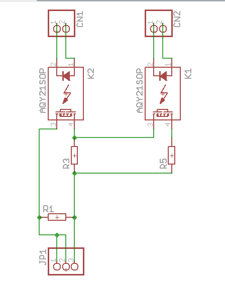

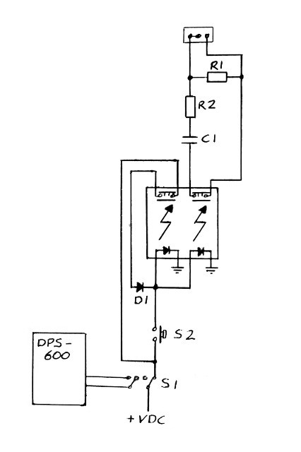

Had a good think about this and am going to play safe and do a basic bias switch to help the dps-600's on start-up. Will have a fixed bias of 50mA on start-up then a switch to 400mA bias.
Will use the dps-600 stanby swich to activate the circuit and separate swich to bring up the bias. Putting the dps-600 into standby will deactivate the bias circuit, resetting it to 50mA on start up...
Will post a quick diagram latter to see if what I'm thinking of will work and that the additional bias circuit is correct...

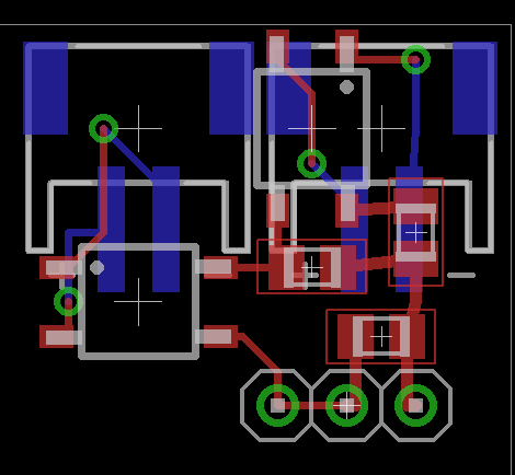

I have created a separate PCB that will be mounted straight on my bias trimmer position on the pcb. I've attached screenshot(s) of what that part looks like at the moment. It has two control lines and two separate SMT opto-isolated relays to allow for a summer/winter bias level setting. Can of course use just one of those and leave the 2nd unpopulated. The goal was to use low EMI opto-isolated relays and ensure that the bias current path is still as short as possible. Use NC relay contacts, open them after appropriate delay. That way if bias control circuit fails or is off for whatever reason, the amp will start with very low bias but still be 'working'.
When I'm done with a design I'll share details of what I'm doing and offer a short run of PCBs for DPS-600 + The Wire users.
It should be fairly easily adapted to other uses and leave out the bells and whistles that I've put in mostly for myself and may not be of interest to everyone.

  • Screenshot 19:11:12 10:13 PM.png
  • Screenshot 19:11:12 10:26 PM.png
Very nice, I've read through the block diagram and thought there's no way I could implement something like that, though a lot of the features are quite desirable. Certainly be intresting to see how you and qusp get on with incorporating these contols...
The bias circuit I've penned is simmiler to yours, but with a SPDT relay, a momentery switch as a trigger and the circuits power turned on/off via the dps-600's standby switch... I'll have to find a circuit design program to generate a proper diagram rather than a few hand drawn squiggles. :)

One thing I hadn't realised before I started digging deeper is this, the DPS600 Enable pin is set after 250ms, which is before the PSU is fully stable. This means that you can't use it to trigger the bias setting delay time. I've got a 555 timer adding an extra delay in my design at the moment. Though you could of course just manually trigger that delay time by hand, but that isn't foolproof enough for my liking (my amp needs to sit in the main lounge room and be totally foolproof for rest of the family ...)
