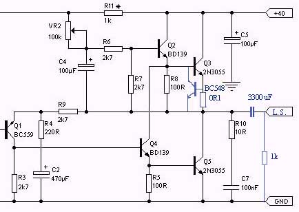

SOA protection
1. Build a speaker protection circuit with time delay.
2. Current limiter for Q3. See attached circuit. The collector of the BC548 might well be connect to base of Q2. Could someone comment on this suggestion.
The 1K ohm resistor is for charging up the output capacitor in case the loudspeaker is not connected and essential for the speaker protection circuit which should be connected right after.

DC speaker protection is really not a problem considering the output is capacitor coupled, unless you are using a very small and sensitive speaker - otherwise, most speakers are capable of withstanding the 50-something ms pop if the output suddenly fails, as long as you do not repeatedly try it. That being said, a delay + relay may be a good idea, however, if you are using one, you might as well use a DPDT relay and while the speaker is disconnected, connect an 8 ohm resistor instead. That way only a very small delay is sufficient.
As for your current limiter - it is another form of current source, so if you are inserting a resistor and another transistor in there, you may as well limit the current at it's proper value, in which case you actually only need to connect the existing transistor differently. You should keep in mind that the limit operates only when there is ~~0.5V across the resistor so this is how much of the potential output voltage swing you lose. On the plus side, the current source would be very stable. On the minus side, limiting the current at 5A already violates the SOA for the transistors Echo used. Slower transistors are much more fogiving in this regard, but also offer less performance.
My idea was to avoid the Surge current at switching on to destroy TR2 ( see the first post of this topic). Tr2 should seldom goes beyond 2Amp (??) in my own steady state setting. The current limit transistor would not work normally but only at switching on.
Correct me if I am wrong that TR2 seldom goes beyond 2 or 3 amps.
TR2 (Q2) is only the current source...it's current is Q3/beta. Q2 isn't really in any danger...Q3 is. And the simple 'n easy solution is to make C4 a 2200µf 10V cap, and make C6 220µf. As long as the recommended zener modification is on the board, turn-on thumps should not be a problem.
Sorry folks, I mixed up the transistor designation in JLH with Doz.
I meant the current limiter (as shown on the attached diagram is connected to base and emitter of Q3) is for protecting Q3. If there is a surge current larger than 5 to 6 amp flowing through Q3, then the current limiter will bypass the Q3 base current limiting Q3 collector(emiter) current to 6 amp utmost.
Of course, the suggestion by Echoware are fine too.
Hm, I believe you are missing the point of the whole circuit.
Q3 _IS_ supposed to be a current source which is NEVER supposed to source more than the idle current. The only reason it does is because with the original parts the reference current for it becomes excessive. But there are many ways to make a current source - or, to be more precise, a current limiter. So, in essence you are proposing a current limiter for a current limiter. Why not just fix the first one?
That being said, the current limiter you are proposing has some virtues compared to the one in the DOZ - and one problem, up to 1V loss of headroom. There are also other topologies that avoid this.
ilimzn ,
thanks, understand.
Can you comment on the JLH Iq control circuit (1996 sep issue Fig 3) ?? It used a MJE371 with emitter connected to a 0R33 which is in series with Q3 collector (Tr2 in JLH) and its base to a reference supply....seems like a control loop by itself. Would it smooth out the start-up surge ??
thanks, understand.
