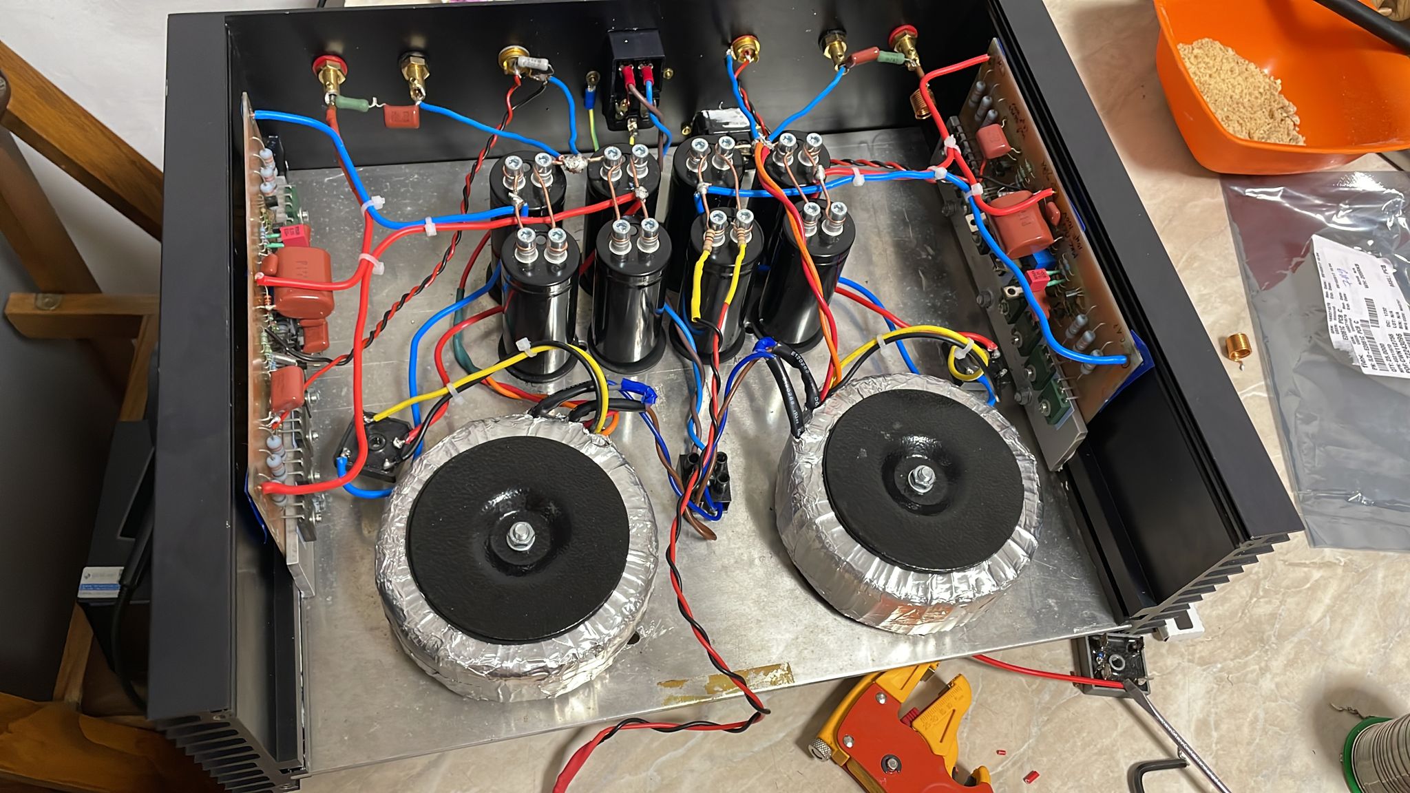

Hello, thank you for the enlightenment Lucky for me I have one. I am refurbishing it right now. I'm not an electronics specialist. maybe you can help me bias it properly, if you know how.:D

That does not at all look like a standard early Doxa 70
Maybe it's an early version or a heavily modified.
I have a couple of Audio 60 amp's that are fairly close while not identical in design.
Also on these the year of manufacture should be on the PCB.
Unlike the later Doxa 70's these are with NEC Ring-emitter power transistors which are very fast, Ft 60Mhz.
The zobel network across the output is a must and the resistor must be 5w. I remember many years ago having had to substitute for a 2 or 3w resistor and it would emit a puff of smoke whenever the AGI Preamp volume was lovered :p
Wonderful sound btw.
Would expect roughly 32vac on the Doxa, it's 28v on the Audio60 transformers. I would be very careful going much higher on this circuit.

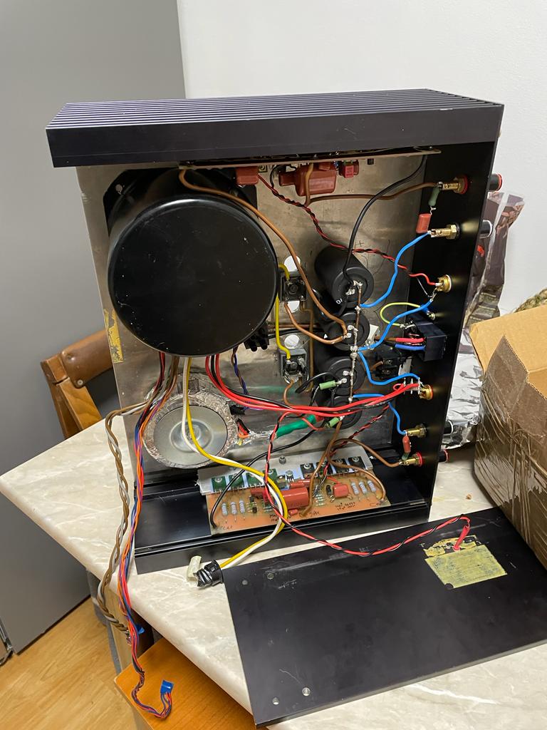

I cannot find a schematic on this amp, finally I user dual 35V-0-35V 300VA transformers with an upgraded filter capacitor network. The amp is running quite hot now and I am pretty sure the amp is biased to high. I have 2 pots on each amplifier module, i suppose one is for dc and one is for bias. I do not know which one does what and I do not want to blow something up. Also I do not know where to measure the bias to set it up and at what value.

Hi.
By looking closer to your pictures and and comparing them to the my notes I found, this amp is a Doxa 70 Mk1.
This have not any regulated PS for the input circuits as Mk2 have, 3 output pairs and 4 pairs on the later one.
If there are any other differences, I don't know.
My knowledge to the Mk1 is limited.
But if you look at the PCA, you'll find two trimmers.
The one closest to the output is the Iq and the other one close by, is the Offset.
Put a V-meter over one of the emitter resistors and one at the output to gnd with no speaker connected, and adjust the two pots for the desired values.
