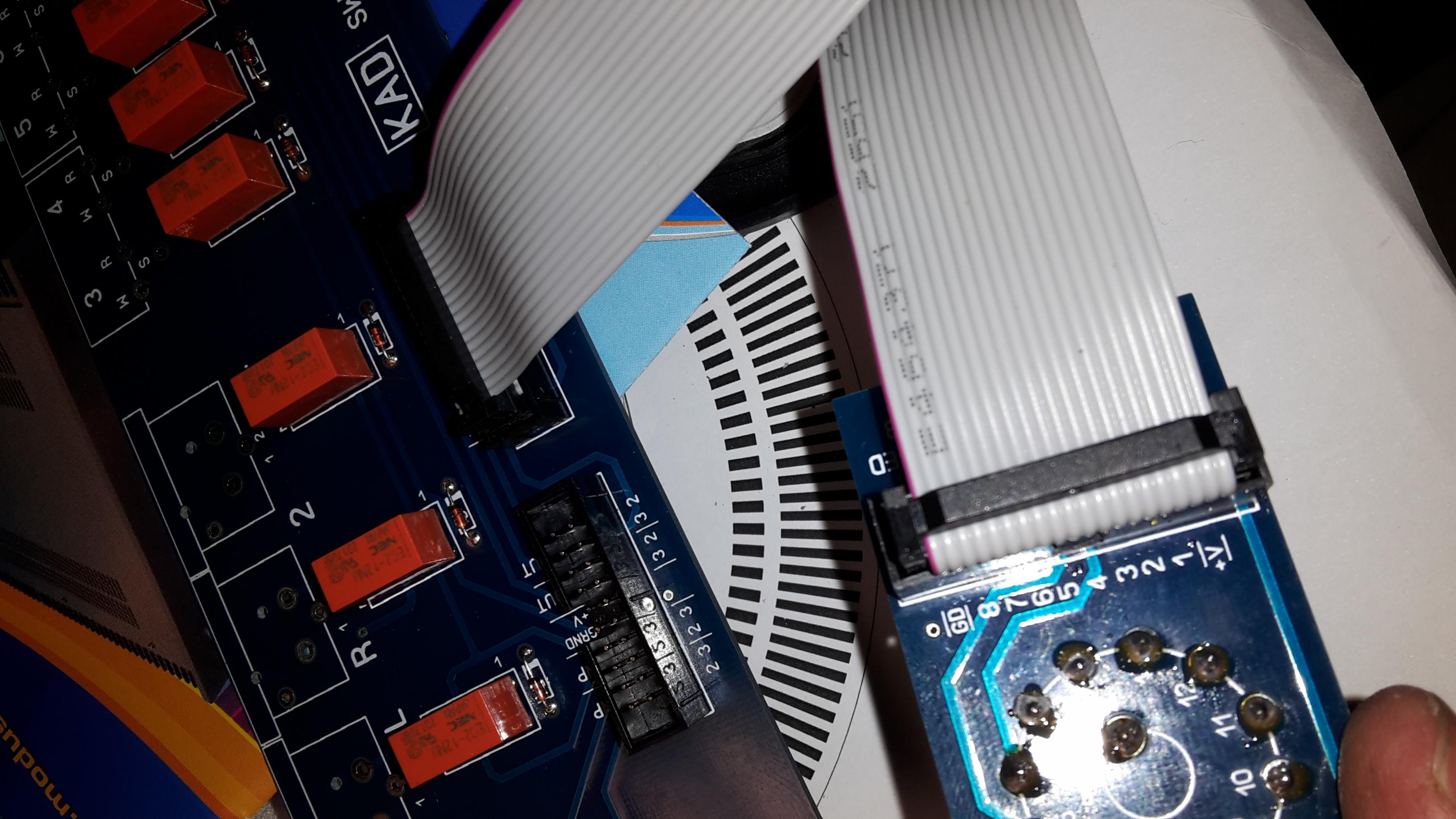

Hi,I'm in the middle of building the preamp and now I have a question about the input selector pcb. I soldered it first on the wrong side of the pcb but i have corrected this. But now the cable leaves in the wrong direction if i compare it with other builds. The red mark is from gd to gd marking on the silkscreen so that seems allright. Both notched point towards the numbers on the silkscreen. It could be that the cable i bought was folded the other way around, but i'm not sure what is standard. Please have a look at the picture then you see what i mean. So the question is if it will work OK like this. Thanks for your time.
Best wishes, Vincent
Hi,I'm in the middle of building the preamp and now I have a question about the input selector pcb...
Vincent,
The easiest way to check to your cable is to use a multimeter to verify that you have plus 12 volts on the pin pair that is marked '+V' on the switch PCB silk screen. If you do you should be good. If you don't your cable is backwards. The easiest way to fix that is to nibble a slot on the long edge of the IDC connector (opposite side if the switch) that you have soldered to the switch PCB. That will allow you to reverse the ribbon cable on the switch end.
Thanks Carl, I'll check tomorrow, it's getting late on this side of the ocean. The pcb's are a real pleasure to work with b.t.w.Vincent,
Great! Be sure to let me know if you need help.

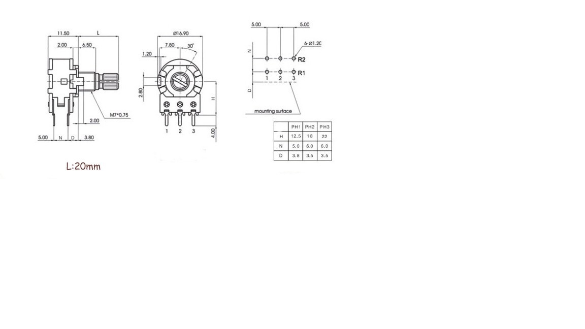

Question for Carl -
What is the pitch and row spacing of the B5K Alpha pots used on the pcb? I've tried looking up the data sheets for them but can't find anything that matches. They're too small for me to measure reliably with anything I have in my toolbox.
I'm considering panel mount pots to allow more front panel design options and would like to mount connectors on the board to keep the wiring neat. Assuming I can find something that matches the pitch and row spacing on the pcb.
Thanks!
Thanks!
Question for Carl -
Thanks!
The PCB pinout that I used is an industry standard for thru board pots. There are 2 rows of 3 pins.
The pins in each row are spaced 5mm apart and the two rows are spaced 6mm apart.
I hope this is what you are looking for. Let me know if you need more.
That's what I was looking for. I figured it was something basic like that - But was having trouble locating it. Thanks Carl!
