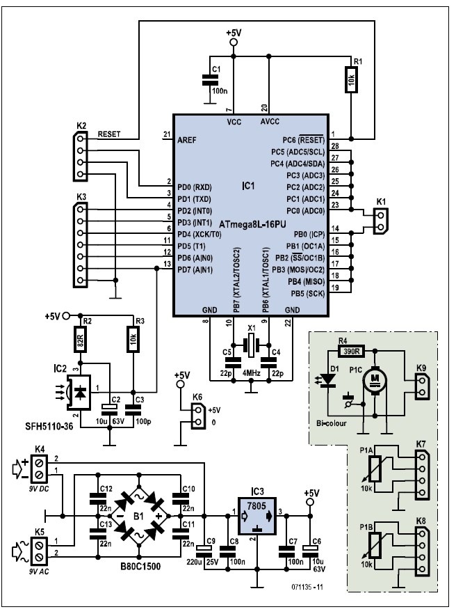

Elektor project 071135 (Motorized volume control) using Atmel ATmega8

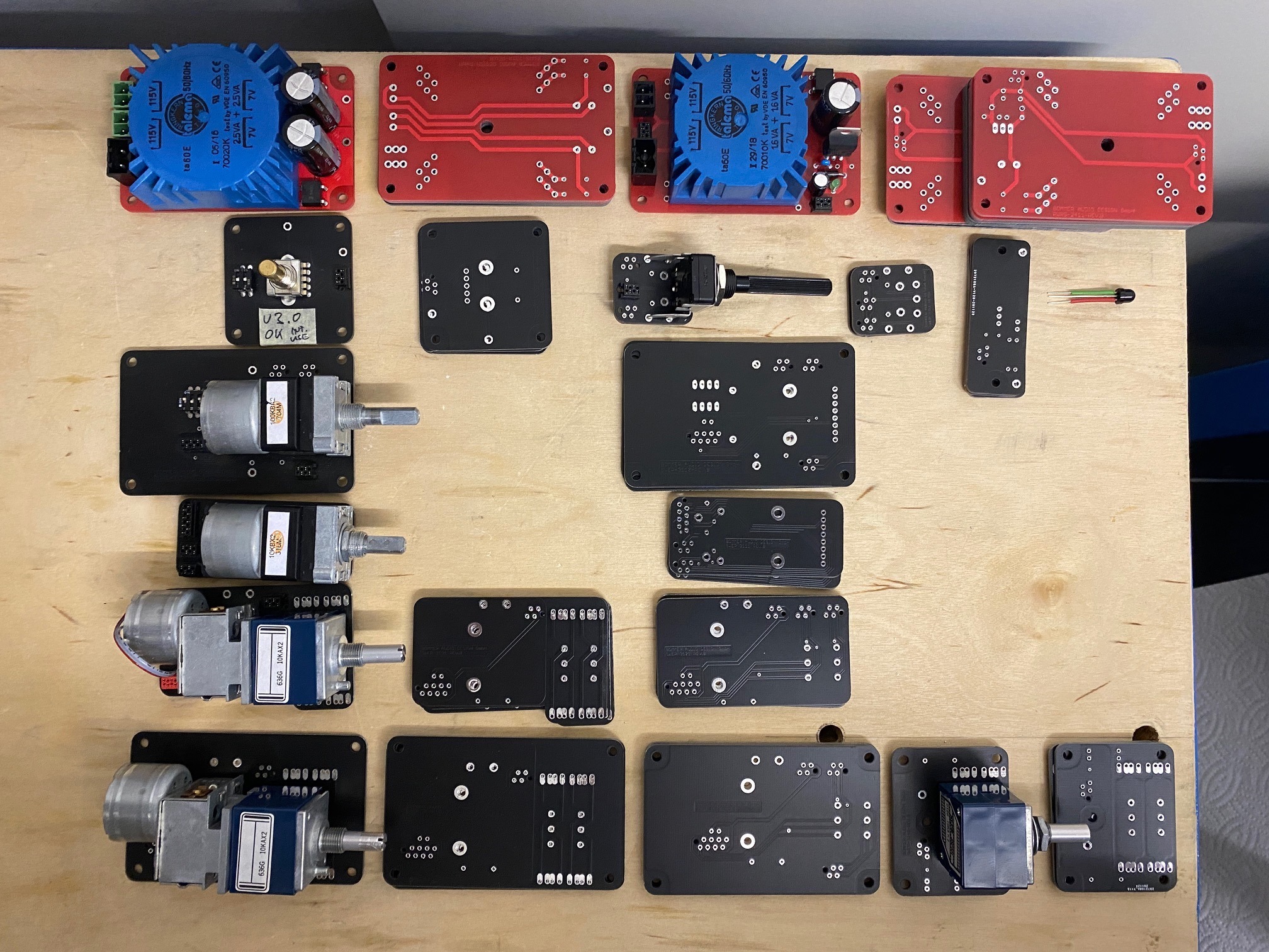

Sorry for being a bit off-topic, but this is related to some posts above, re:motorized pots + PCB:
I have a bunch of such PCBs for a variety of potentiometers, prototypes from a developer working on a solution (for an ELMA "Relatt" relay attenuator of which I also happen to have a spare board w/o resistors)… If anyone is interested...

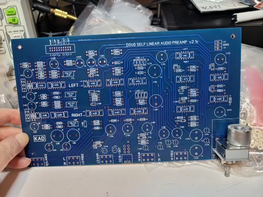

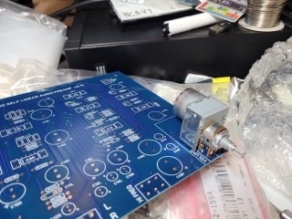

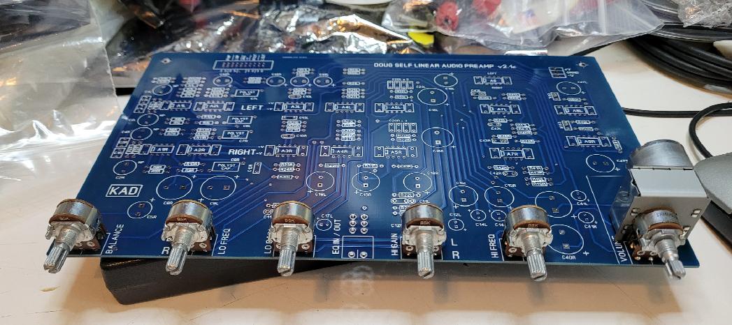

For those of you that are interested in a remote controlled volume, I now have main PCBs that are intended for use with the BOURNS 5K motorized pot.
BOURNS #PRM162-K415K-502B1 motorized pot, in stock at Mousers USA.
The revised PCB is identical electrically to the non-motorized version.
PLEASE NOTE: This is a modified main PCB that accepts the described motorized pot. The processor board and Infra-Red receiver are not included.
Please message me if you are interested in this new PCB.

What would be the centre-to-centre distance between the volume pot and the pot next to it? And do you have any idea of how much higher the axis of the motor pot is compared to the other pots?
The dimensions affecting the front panel remain the same. Any successful front panel design that worked for the 'non-motorized' version will work for this version. The PCB is the same depth. However the width has been extended 5mm. A 5mm change in the PCB width should not affect any chassis requirements.
If I'm understanding you right, we can now buy any remote-controlled-motor-pot kit or module from anywhere, desolder the motor pot which is part of that module, extend the two wires which went to the old motor pot's motor so that they now stretch to your Bourns pot's motor leads, and then we're good to go. The electrical drive currents, speeds, etc, which drive one motor pot should be pretty much the same for another, right?
