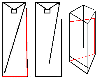

I am using M. King`s sheet (original version without offset) to construct an enclosure for the Ciare HX201 in an "omnidirectional" setting (driver looking to the ceiling). What I don`t like so much about a standard folded TL is the direct line from the driver to the bottom, which should make a lot of dampening necessary. So I also considered to separate the box into two TLs. I started with the special case of a diagonal through the box separating the box into two identical TLs. I expected the peaks and holes to become more extreme with two identical resonators in series, but the opposite happened.

From your description I would expect the resonators in PARALLEL. What did I miss? You probably need to a supply a drawing of your construction.:xeye:

Here it is.
Aaaah, I see!
But I don´t believe, this will work as wanted. The influence of the second half of the line as a "resonator for the resonator" is negligible.
The only workable arrangements for the partition would be the ones shown in the second and third drawing.
I simulated both versions more detailed with the "sections"-sheet using minimal values for the closed end. Rolloff is similar, frequency response of the double-TL is still slightly less peaky.
The main difference is in the terminus velocity.
In the standard folded TL it is continuously falling. In the double-TL there is a steeper decline first and over 100 Hz it is fairly constant with slight peaks and holes.
