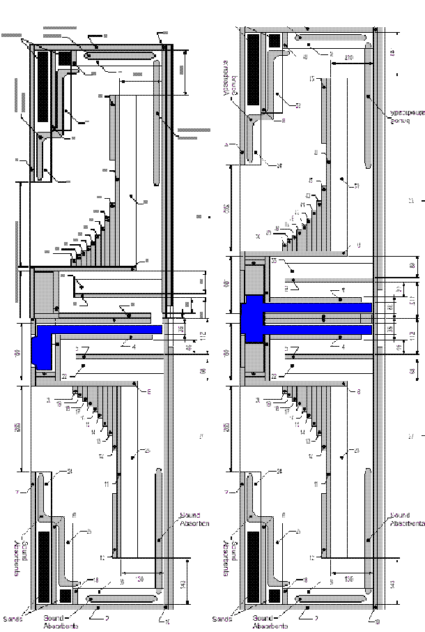

'Found a picture. I didn't draw this myself -this is from that AA discussion I mentioned that I'd run across some time ago. I'd forgotten that I'd saved it -no idea who it was who drew them though (apologies if it's someone here!). There's two ideas here for a double horn -doubled versions of the Fostex Factory FE108ESigma enclosure in this case. I woudn't choose this layout myself I I was designing one obviously, but for doubling the existing horns as Terry suggests is possible, there isn't a while lot of choice.
Now, I'm leaning toward the right-hand design as being the more logical. However, you can see what bothers me a bit on it quite clearly; the throats are almost directly behind the driver. And with the CC being a shallow, vertical type, I'm thinking this might affect things a bit. Or am I worrying about nothing in that regard and it'll work just the same?

Scottmoose said:Now, I'm leaning toward the right-hand design as being the more logical. However, you can see what bothers me a bit on it quite clearly; the throats are almost directly behind the driver. And with the CC being a shallow, vertical type, I'm thinking this might affect things a bit. Or am I worrying about nothing in that regard and it'll work just the same?
Greets!
Neither is the correct way to make a DBLH, at least WRT splitting up a single path design. Once you move away from doing that, then either will work depending on the gain/BW desired.
WRT the throat behind the driver, this is no different than in a BR or FLH, i.e. it will exhibit max loading on the vent/throat. My attitude is that for 'FR' driver BLH designs, the CC should be calc'd as a MLTL for theoretically best performance.
GM
