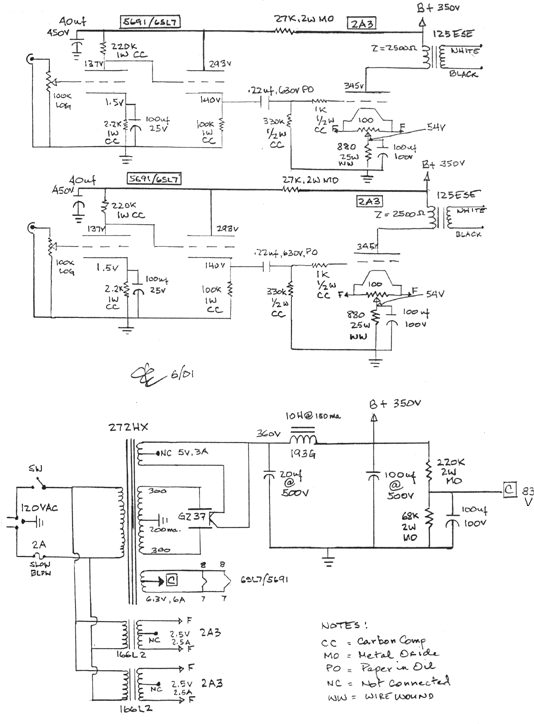

Hello Im building the attached amp in a mono mode and the B+ will be
300 v instead of 350. to keep the preamp voltages and currents the same I calculated the the 27K feed resistor to be now 3333 ohms
Does this seem kosher ?
Thanks Jeff
