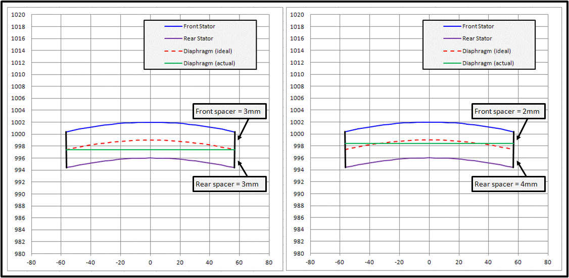

Has anyone tried mixing silicone dots and strips?
I've been thinking to try out an arrangement (with big curved FR panels) that I would add silicone dots only on the back stator to support the membrane from behind.
The dots I have are 3,5mm and the spacers are 3mm so the membrane would be constantly against the dots even when the membrane is moving quite a bit. Curved membranes also tend to flatten ~0,5mm towads the back stators by nature.
My goal is:
1) to be able to use highest possible biases with 3,5µm membrane without a fear that the membrane is going to get sucked into the back stator and prevent membrane slapping the stators near it's resonant frequency (which moves the membrane quite much because the Fs is ~35-45HzHz and resonance's Q is quite high due to low-ish tension that 3,5µm is capable to support in big panel).
2) Make the membrane's resonant behaviour better/smoother, hoping that silicone dots would smooth out the panel resonances quite a bit. I predict silicone dots would dampen/distribute the main resonance and also smooth the horizontal/vertical standing waves that each segment has..
I'm going to try antistatic spray + acrylic lacguer combo for the membrane coating (now I have graphite boosted Licron Crystal but it's resistance is little on the low side), as it feels good on my sample piece, and I though I could also try out new spacing technique if that would yeald some benefits.
Any thoughts?

When you add silicon dots within a panel section, you will increase the effective stiffness of the diaphragm so the resonance Frequence, Fs, of that section will increase. To keep the same Fs you will need to make the section wider than if no dots are used. So, for the same Fs, the gain in stability with dots may not be as much as you desire.
As Calvin mentioned, trying to make curved ESLs with Fs < 100Hz is problematic. The best approach is probably to use facets similar to Soundlab. Attachment #1 shows a layout you proposed back in post#10. You had mentioned that with 3mm spacers, the larger 11-12cm wide sections had the diaphragm positioned within 1.5mm of the rear stator. This was because you were using some amount of side-to-side tension which resulted in flat facets rather than curved sections.
Attachment #2 shows that if you kept the same layout, but used 4mm spacers for the rear stator and 2mm spacers for the front stator you would position the diaphragm closer to the middle of the gap even with the side-to-side tension.

Steve, the flattening towards the rear stator is quite minimal, maybe 2,5mm/rear and 3,5mm/front at the worst parts.

I understand that you have minimal flattening to the rear with your current horizontal sectioning configuration. I was suggesting a way to that you could return to the vertical sectioning your mentioned in post#10 for which you were having the flattening problem....the flattening towards the rear stator is quite minimal, maybe 2,5mm/rear and 3,5mm/front at the worst parts.

Using vertical sections with flat diaphragm facets allow the use of uniform tension which works better at LF where the diaphragm is moving a large % of the gap.
