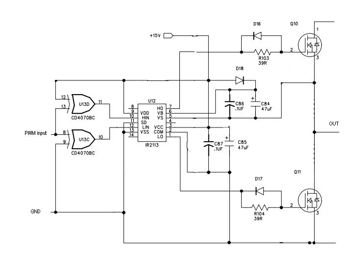

Here is the simplified class D output stage from one very known schematic of an commercial amplifier. This stage has very good timings matching and low distortions. Diodes in series with mosfet gates can be popular cheapest 1n4148. The dead time is produced because charging/opening of mosfet gate capacitance via resistor takes more time, than discharging/closing of mosfet via diode.
To make the fullbridge configuration it is needed to built one more output stage, and connect HIN and LIN inputs of second driver in parallel to the first driver, but in swapped fashion. No any additional XOR elements or invertors are needed.
Also, do not forget to post the complete schematic

That IC in your schematic will simply my life a whole lot.
I can have the entire circuitry on one supply rail then. Just a single +12V supply rail controlling everything.

I attempted the XOR approach, with the IC Eva suggested and am satisfied. The signals coming out of the XOR are much cleaner then the comparator, but might just use the other IC to avoid the 5V rail.
Only problem i had is, my gate driver didn't bootstrap, but I'm not gonna bother with that for now. Some dumb mistake on my part which isn't bootstrapping it.
Would like to know how to implement deadtime otherwise though, without the schmitt trigger.

Hi!
Why do you need to provide the deadtime BEFORE the driver? It can be done AFTER driver too: simply place the RD networks between driver and mosfets... And this should satisfy your teacher too: you will have an deadtime circuit (between driver and mosfets) and this is what he asks you for.
Also, the ringing occurs because of shoot through over both mosfets, this is obvious. And how the shoot through can occur? This happens in the following moments:
1. if both mosfets are opened simultaneously: this case is obvious and can be solved by adding of deadtime.
2. if the body diode of opposite mosfet is opened, and switching under load occurs: this happens if there is TOO BIG deadtime.
3. if mosfets are having bad dv/dt capability and/or switching occurs too fast: then switching time (ie opening time of mosfets) must be done longer by increasing of gate resistor.
So using of RD network BETWEEN driver and mosfets can solve all of these problems: this produces an adjustable deadtime, and rise/opening time is limited (because of R), whereas the fall/closing time stays at minimum (because of diode), providing better efficiency.

He said something about current flowing back into the gate driver, because of the diode in parallel.
But in all honesty I didn't understand what he was talking about.
500Ohms*50pF=25 ns. (Actually a little more.)
Do not forget to add output resistance of CD4000 CMOS series too
