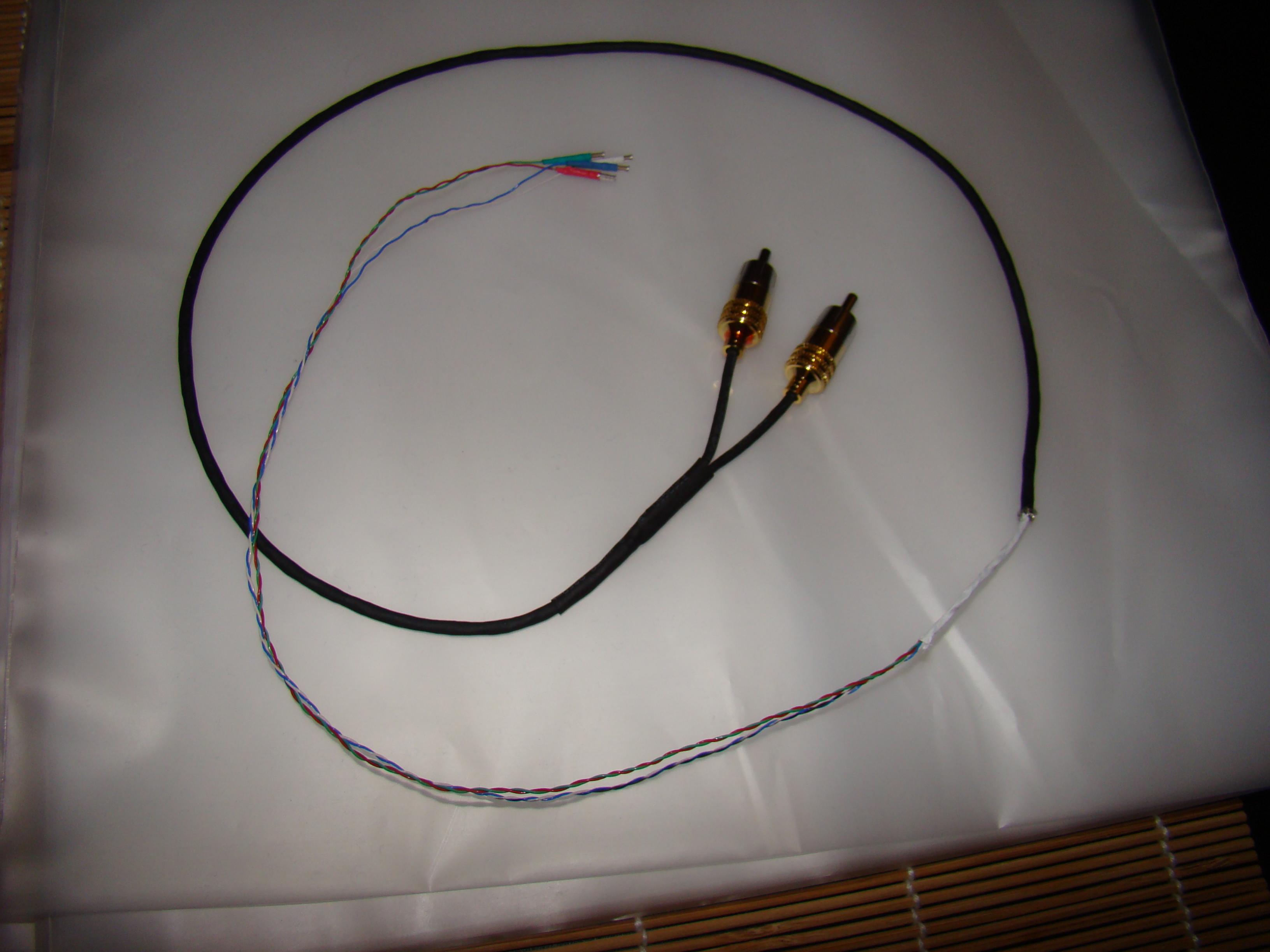

fdegrove, everything in the cable is cardas, from the clips to the phono plugs and cardas eutectic solder has been used exclusively throughout.
I did a cleaner double blind test earlier this evening, using two brand new records. Neither myself, nor my brother, nor my girlfriend could detect a difference.
I'm quite sceptical towards the thesis that the "veiled" nature of the mixer prevents us from hearing a difference that would otherwise be audible...if more or better information were to travel from the cart to the phono section, I would expect to hear some difference anyway.
Nevertheless, my next project is to make an audiophile mixer by wiring two decent valve driven phono stages into a valve summing circuit and into a line-level pre-amp stage. So, to extinguish all possibilities, I'll keep the wire till then, give it another chance and sell it afterwards.
In the mean time, here's a picture of the wire I made.

Intersting stuff.
I make lots of vibration measurements using piezo-electric accelerometers for a living. there are two types of accel's, charge type and voltage type. for charge type, a charge signal is output. This charges a capacitor at the other end and you measure the voltage on the capacitor. (with a bunch of op-amps) For these accelerometers, very special co-ax cables are made that reduces changes in capacitance in the co-ax wire itself that might add noise to the signal. these co-ax cables are about .06 in dia. The voltage mode accelerometers have a amp built in and you measure voltage at the end of the cable.
These cables are on the heavy side and maybe on the stiff side compared to what is being discussed here. You could probably negate the stiffness issue by looping the cable up 10 inches or more so you are twisting or bending a long length.
But they are probably among the best for rejecting external noise.
you might check out PCB.com and search their cables. besides single co-ax cables, they have a cable with 4 wires in a shield. Their cables have funky micro-dot and BNC connectors, but you might be able to buy a length of bare cable.
If someone is willing to try it out and report back, I can probably find some bad single co-ax cables and send out several feet.
One final note: for a co-ax cable to work, you have to ground the shield only at one end.

Do you mean the shield should be connected to ground at the other end? In this case suing the individual coaxial wires to do this sounds like a massive pain... If anyone does try the experiment, cannot recommend enough that you use the four-in-one conductor construction. Shielding will still be in place for the part of the construction that matters, i.e. outside of the tonearm. The inside bit is by default shielded, assuming tone-arm is made of metal (and often connected to ground). I guess you could connect the shield to ground either at the turn-table end or at the phono plug end. Thinking about it, I should have done the same with my Cardas construction...eh well!
Basically the shield works as a Faraday cage and any external magnetic flux is reflected away. There is also a basic need for a shield to work is to have the shield grounded at one end or the other, but not at both ends. If the shield is grounded at both ends, it is possible for a current to run thru the shield and reflect noise on the inner wire. With the shield grounded at only one end, no current can run from one end to the other.
The other way to reduce the noise from other wires is to twist the wires as mentioned. The theory is that the flux will impinge on each of the two wires of a signal equally and opposistely and and cancel each other out.
Some day I may try the two co-ax cables since this would shield one channel from the other the best. I don't have any means to test it quanatively and my ears are old and damaged from doing vibration testing in noisy enviorments. Not that the rock concerts of my youth had anything to do with it.
I have however noticed changing plugs making a huge difference.
I think this is because the shiny new metal gave a much better contact, phono plugs really do seem to have a finite life, although I suspect gold plating helps..
Makes sense, although in the experiment I (and the other two that helped) couldn't tell any difference between the construction, which featured brand new cardas phonos and the beat-up non-gold plated stock stuff.
