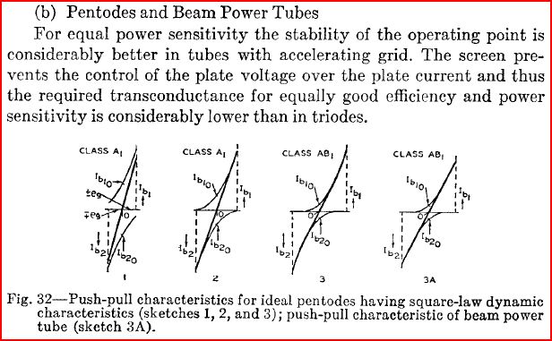

Schade points out the problem with AB triodes in his 1938 paper (page 357 in the journal) - and proposes why pentodes are more suited, also showing the well-known illustration of the mirror-image load line showing best composite linearity.

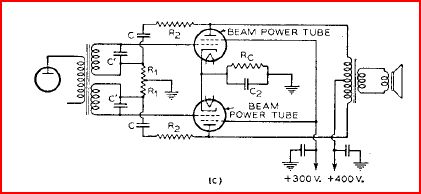

He proposes a class AB design using a phase splitting transformer and voltage summing of drive signal and feedback, which provides the feature of combining the feedback signals from the 2 sides through the transformer common core.

"which provides the feature of combining the feedback signals from the 2 sides through the transformer common core."
Hmm, I'm not seeing any combining of feedback signals in Schades schematic thru the driver xfmr. Although the two sides of the OT should nominally be the same anyway. What seems to be the main problem to me is the disparity in gm when handing over control from one tube to the other. Schade's biasing graphs seem to address that for smoothest net gm.
Oh, so right. The feedback signals are subtracted separately from a common drive voltage. There is no feedback current in the transformer.
So if the drive signals are mirrors of each other, the main issue must be the gm bump, which can be addressed by selecting an op point for best composite gm.
