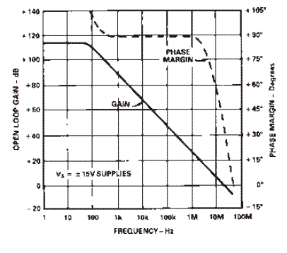

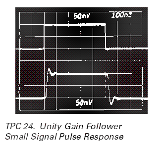

It's unity gain stable, but the stability margins look too close for comfort to me. I think I'd want to throw away some loop gain in the interests of better stability and transient response.
YMMV, but I hear Mooly's other thread calling. ;)
