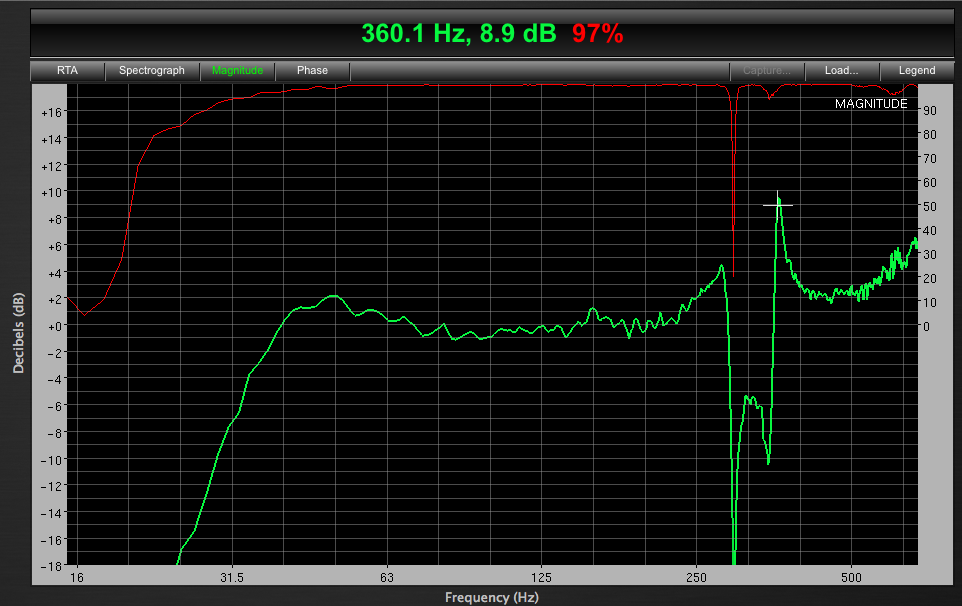

I read a lot about pipe resonance [IE 4" port with 20" length] but does it apply to slots?

Sorry, I need to correct my statement there, the resonance is a function of the physical length of the port. Tuning frequency is a function of cross section area vs its length vs internal cabinet volume.

Port resonance is not the same as box tuning, Fb.
An example of a port resonance can be seen in the chart below, the box Fb is 36 Hz, the triangular corner slot ports used to make that tuning have a resonance that cause the dip centered around 320 Hz and the peaks at 280 and 360 Hz.
Using round or rectangular ports might change the "look" of the port resonance slightly, but as the resonance occurs over an octave above the sub's pass band, the resonance is of little concern.
When designing for a speaker where the port resonance is within the pass band, the port resonance may be of concern.
As Moonfly mentioned in post 30, a program like WinISD will calculate port resonances, as will Hornresp.
These programs also simulate the port velocity, so rather than "pressing a button" and being spoon-fed a port size, you can make your own choices based on power demands, available size, and desired frequency response.

Port resonance and port tuning are different things. Although the port tuning is a function of a resonance, in as much as the port and cabinet form a Helmholtz resonator, this isnt the resonance talked about when talking about port resonance. Port resonance is higher frequency resonance present in the port during use which will be excited by the subwoofer under normal use. If you use a program like WinISD, you can see this as a figure it calculates called first port resonance. This would manifest itself as a kind of audible echoing within the port, and you dont want this. All ports will resonate in this way but the trick with subwoofers is to ensure this resonance is up at frequencies that are not within the subwoofers working range, so they become a non issue.
