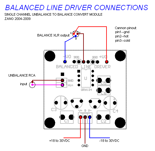

Our man Digi has the balanced line driver with DRV134 or the bridge module version with opamp chips.
These are DIY kits either boards or kits...
assemblycraft.com
assemblycraft.com
You have to buy the software ($10) to get access to the download.
