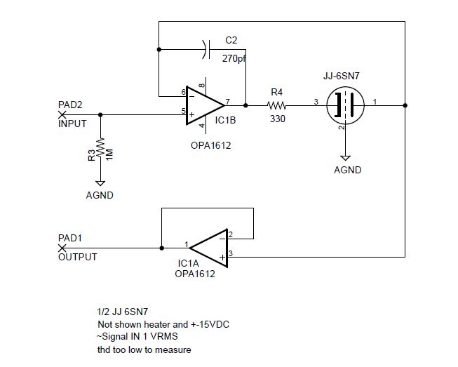

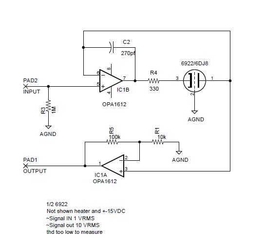

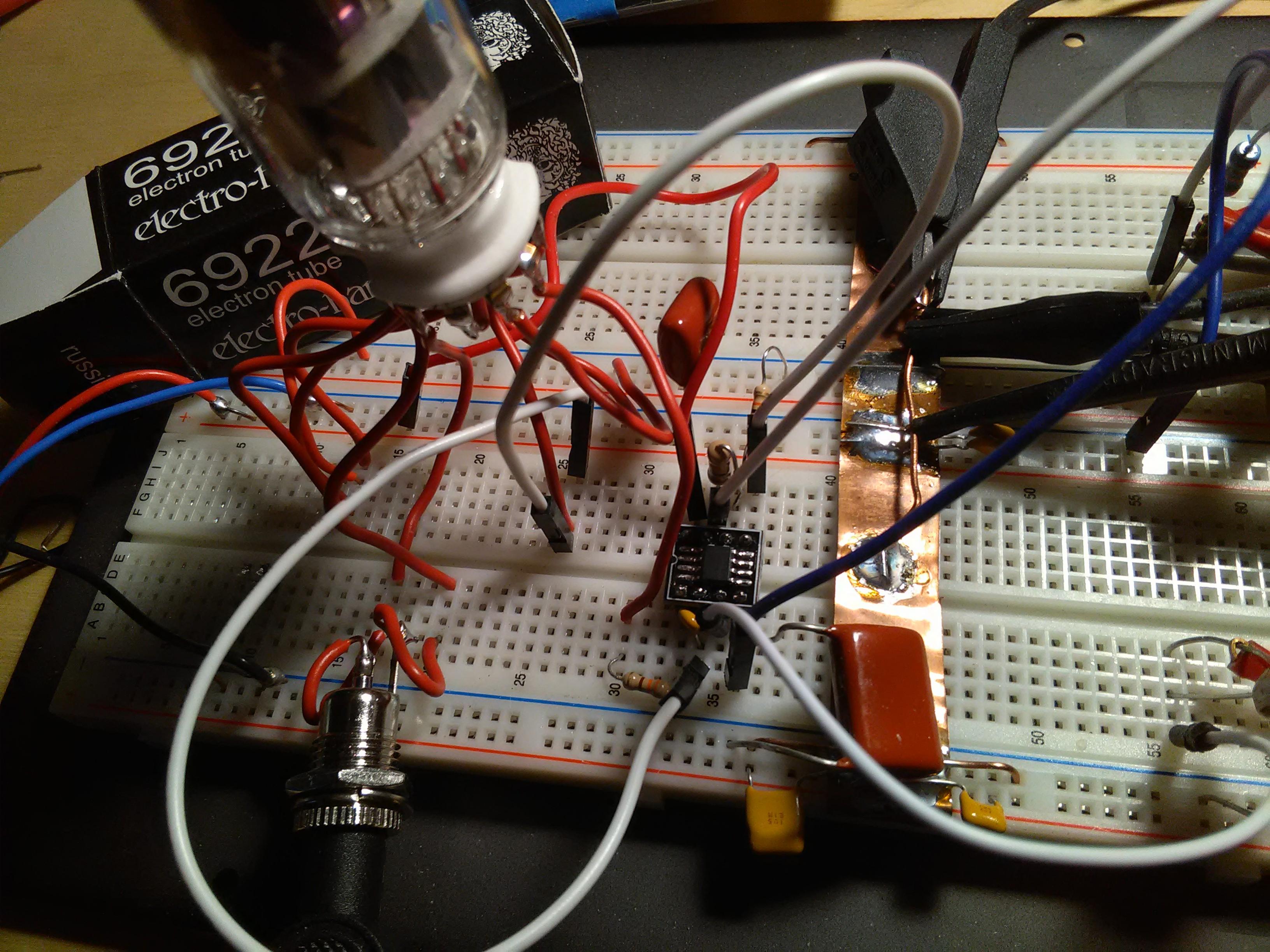

Curious circuit. Because the first stage is a unity gain follower, it's not immediately apparent to me the exact effect that the triode's non-linearity has on the net output. Since the input stage is a follower and so doesn't feature voltage gain, and the total THD is low, the triode may be affecting the bandwidth and/or the distortion spectrum of the op-amp. So, my first thought is that, in conjunction with capacitance at the inverting input, maybe the triode is modulating the op-amp GBW as a function of the signal level? Whatever effects the triode is producing it would interesting to see the distortion spectrum of the output.
It's still unknown how the anode is powered and too if/how the electrons are avoiding the grid.
I reduced the heater to 4.35vdc and no sign of degradation. Below that no emission.
Different tube and different opamp can't be an anomaly.
Bandwidth is good for DC to 50-100khz in unity depending on opamp.
I looked at the opamps schematics no clue.
The first stage output is hi-z but always voltage correct.
Maybe some sort of charge pump effect but it's dc correct.

I think I'm conceptualizing it incorrectly.
If the anode is held at a constant virtual ground, then modulating the cathode will cause the anode to follow. The overall graph shows anode voltage but for a follower it is aprox the same for a cathode adjusting for bias offset. The opamp takes care of that.
I measured grid current under normal operation and it was below what my meter could measure. During clipping it rises to about 200uA.
The available potential is 30V so looking at the 6DJ8 plot for zero volt grid, it begins to make sense.
The first plot is with grid at signal ground. It is very linear. The 330 ohm resistor helps the opamp remain in SOA.

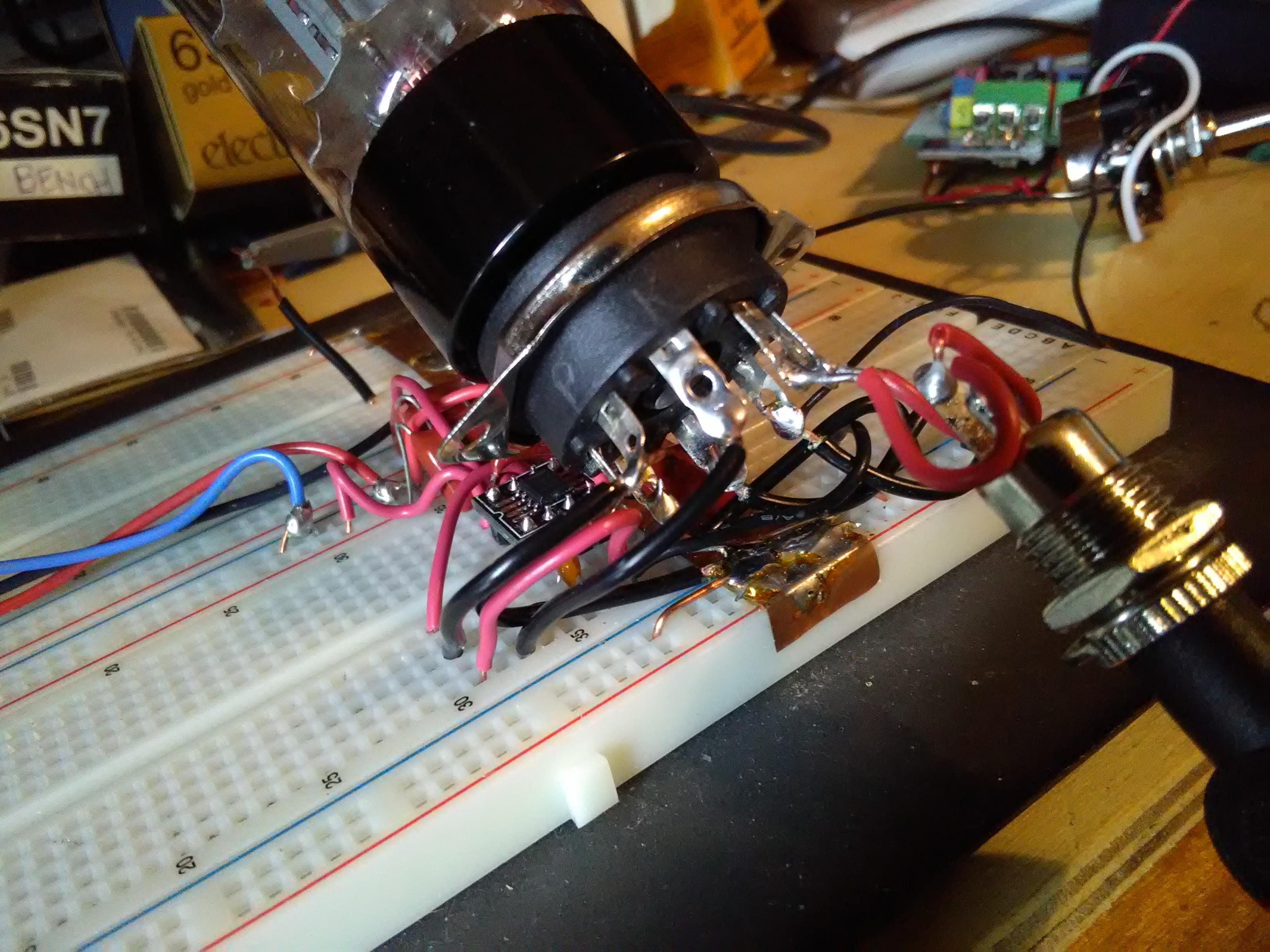

Why not test 6SN7 so here is. Same stellar performance.
Cleaned up the connections for better layout.
No time now for additional tests. Heading out to the Gulf of Mexico on new ship the VISTA , back in a few weeks.

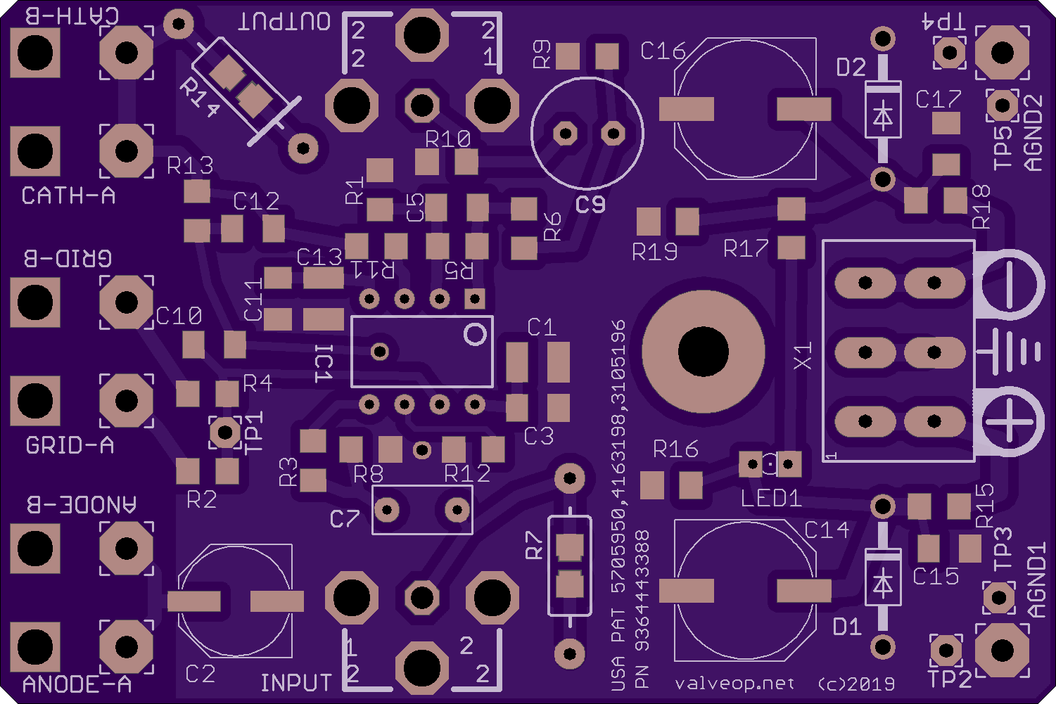

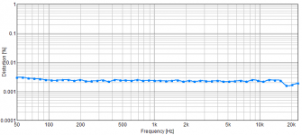

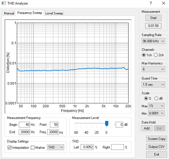

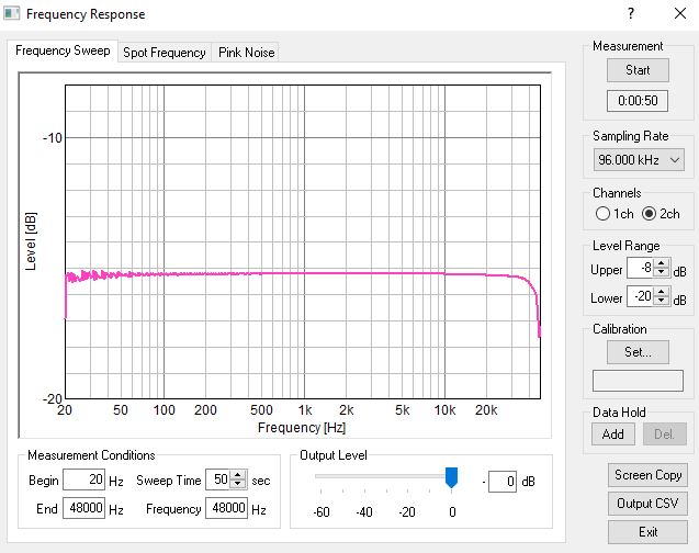

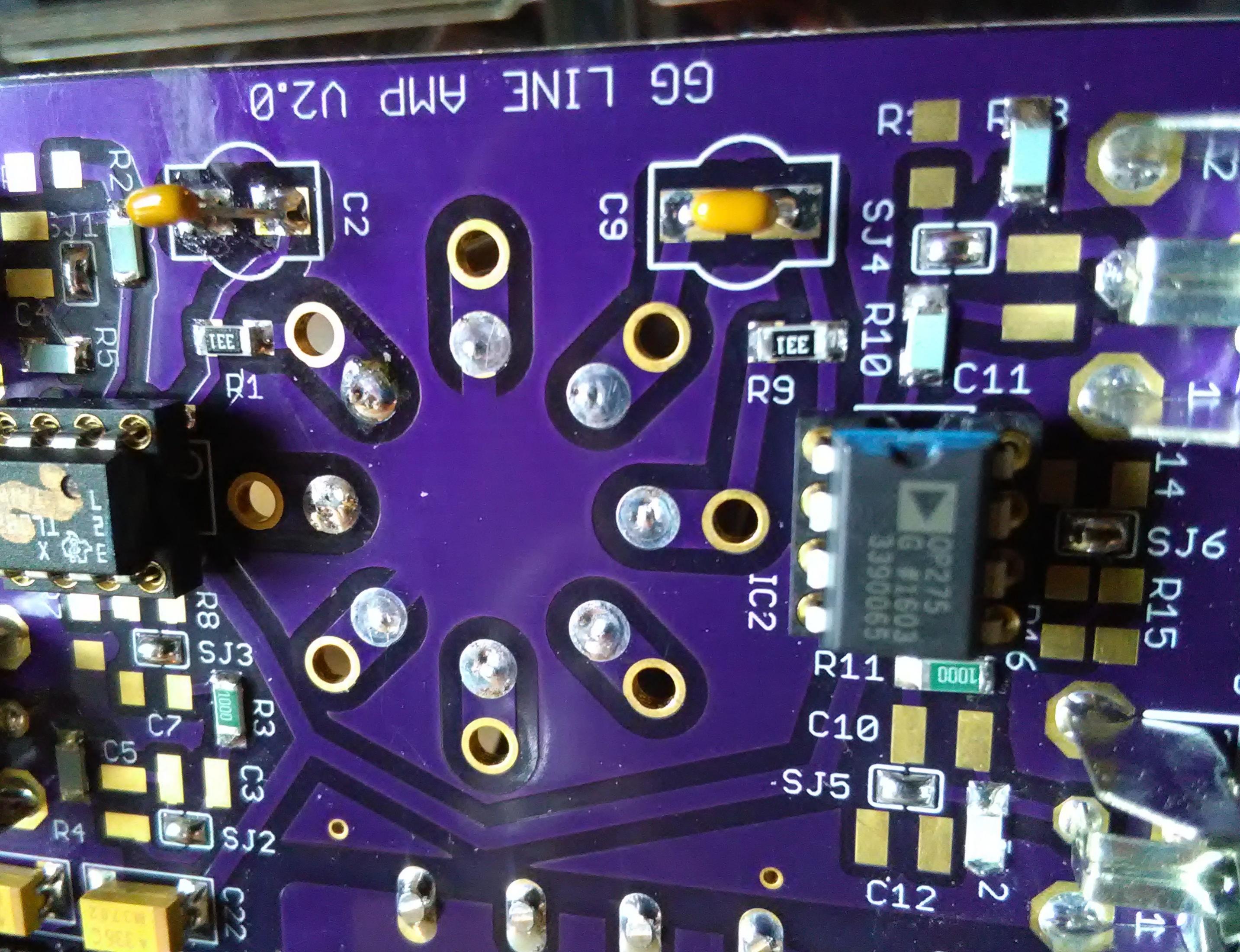

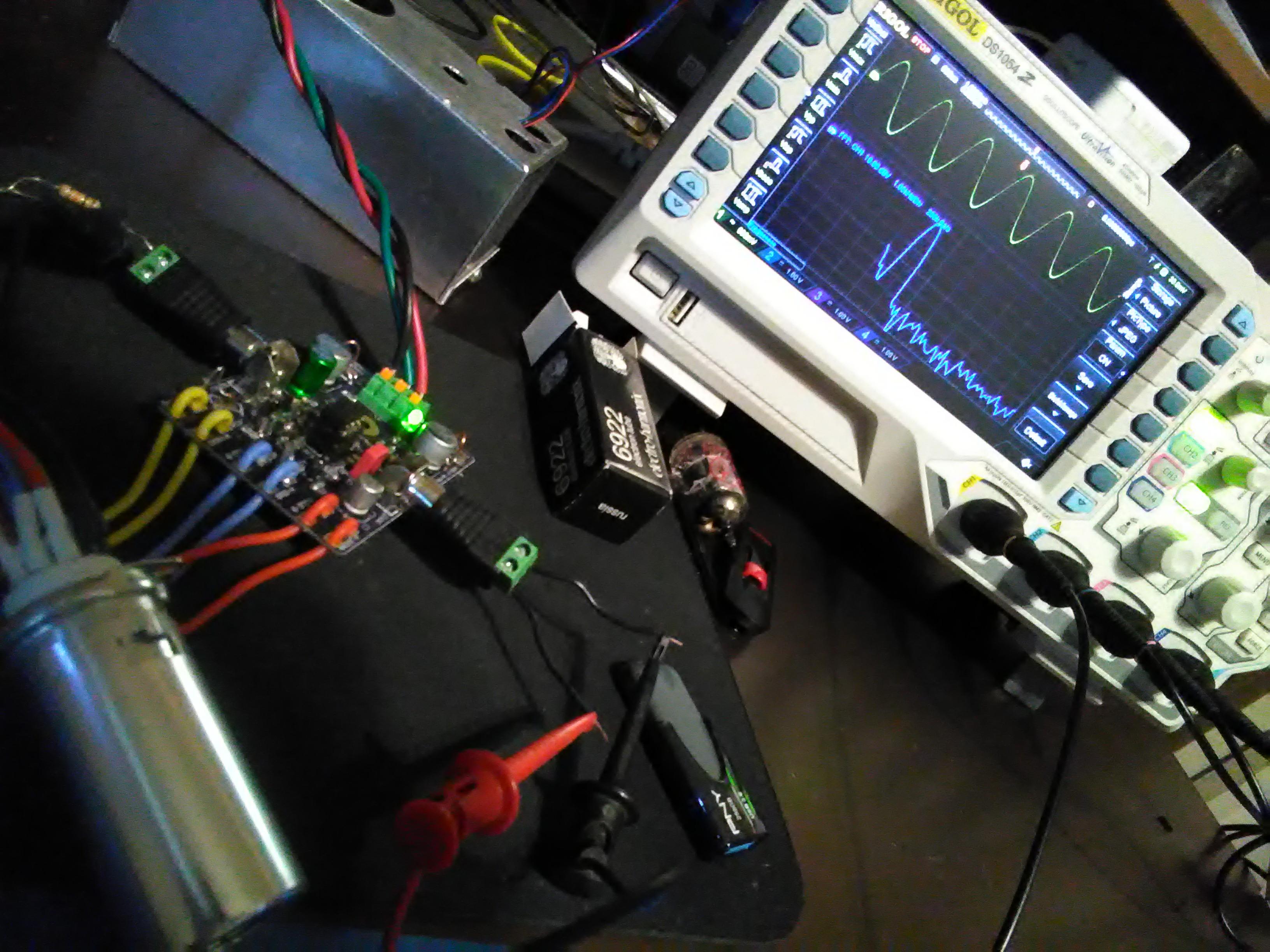

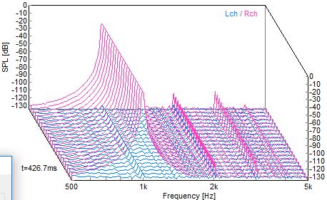

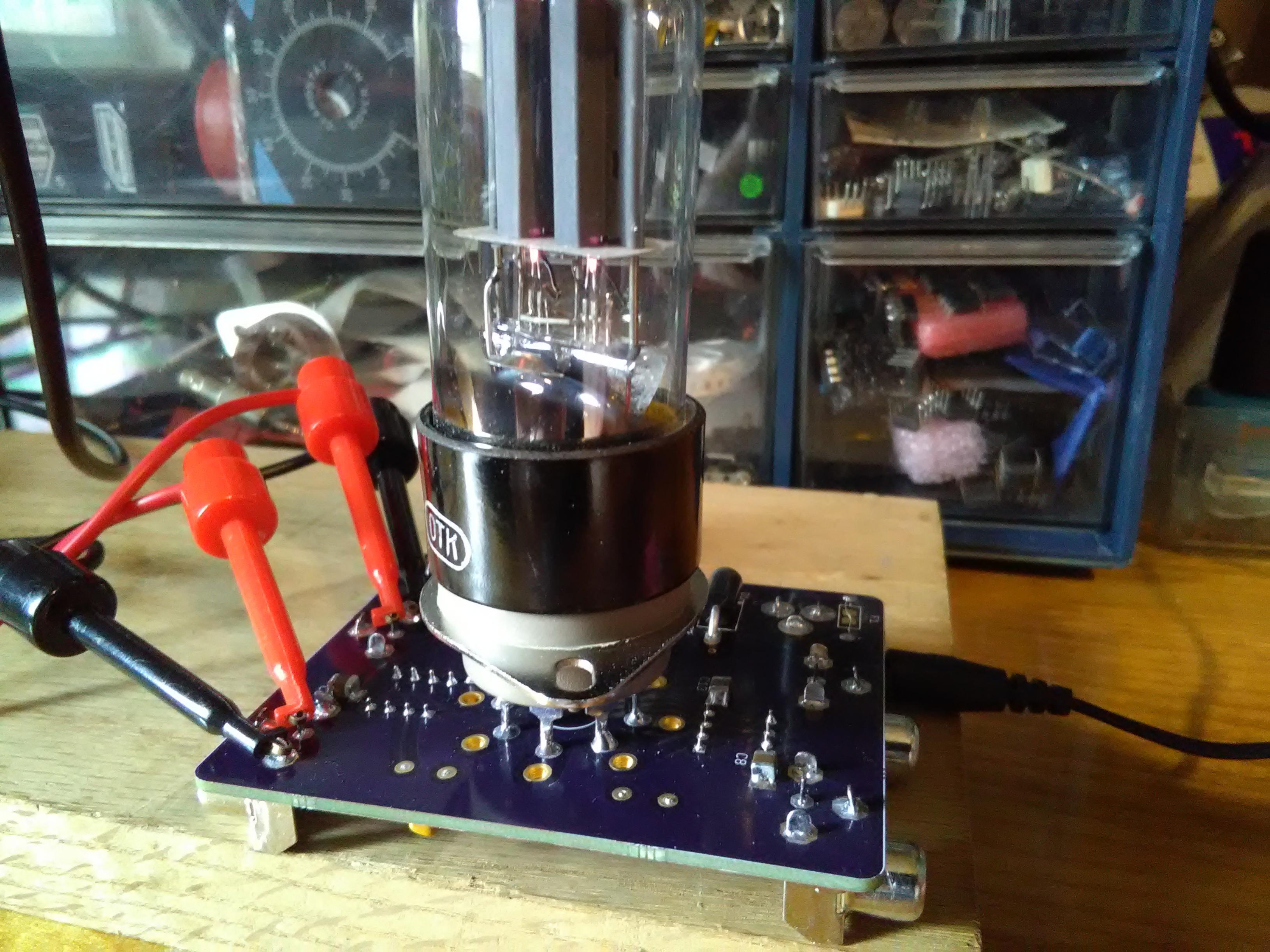

I decided to do a simple pc board to evaluate this circuit before proceeding.
This particular 6SN7 design is beyond the scope of a DIP8 plug-in but it is reducable to very small form factor using the sub-minature triodes.

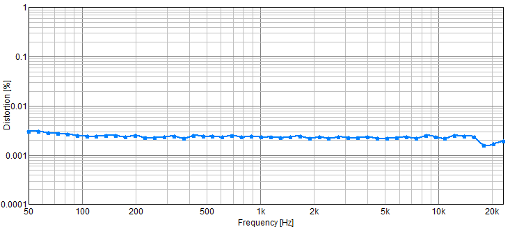

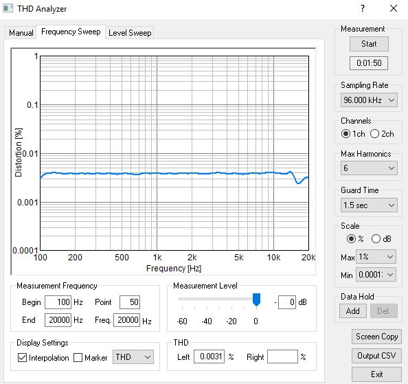

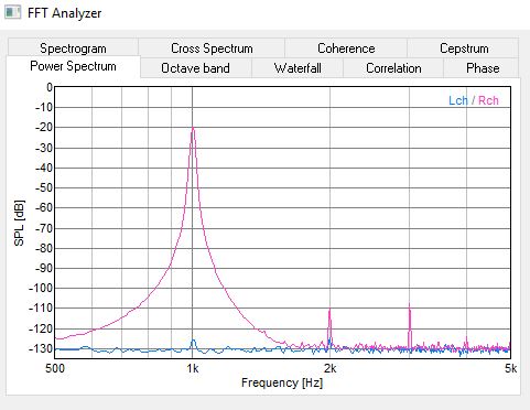

Note on measurements, my test interface has 0.003-4% THD as shown in loopback test. The proto board measures around same so I cannot measure the actual THD using this equipment.
These plots have a TL072 in one socket and OP275 in other. See filenames.
I'm still puzzled as to why the circuit even works. ( some opamps do not work at all)
An old vacuum tube text from 1947 mentions that some electrons will still get to the anode with open plate, even low energy slow electrons. Maybe that is the explanation. Or maybe it the op-amp input bias current, don't know.
plots attached.

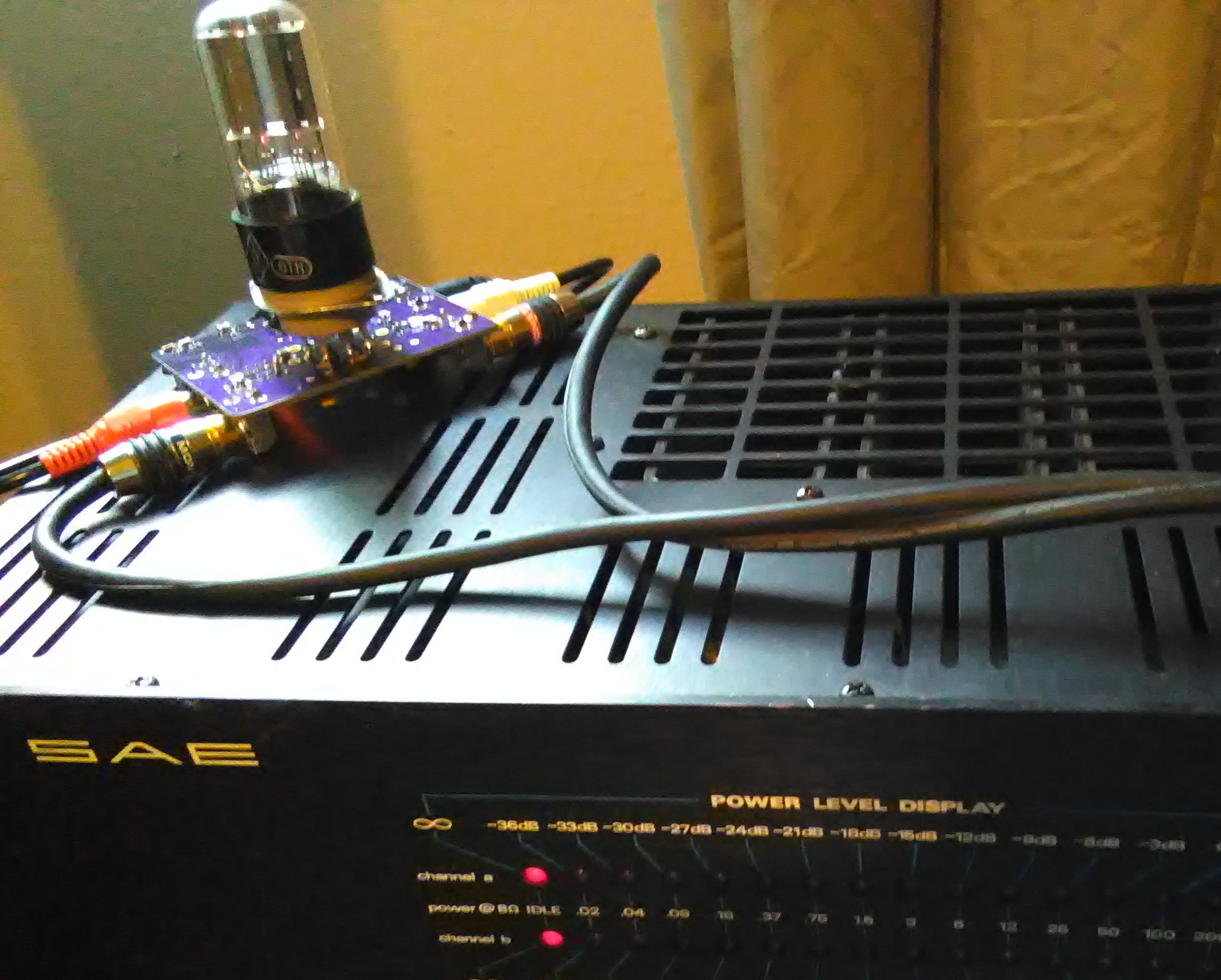

Thanks, looks intriguing. This pcb is using a medical grade wall wart, working out nicely.
I'm tweaking schematic slightly will put up here once done.
Been auditioning for a week or so using different power amps.
It's a keeper.

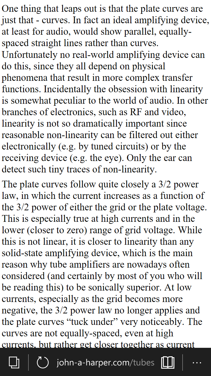

...I'm still puzzled as to why the circuit even works. ( some opamps do not work at all) An old vacuum tube text from 1947 mentions that some electrons will still get to the anode with open plate, even low energy slow electrons. Maybe that is the explanation. Or maybe it the op-amp input bias current, don't know....
I think you are right. There is "NO!" DC current in the plate; also the two opamp inputs need "NO!" DC current. There's always current. nA, pA, fA..zeptoAmps. I would expect some FET-input amps to drive with vacuum leakage, and most BJT-input amps to go off in the weeds.
Is there some reason to take signal down to infinitesimal levels yet squander 2 Watts in a heater?
Yes as expected it was hit/miss on the opamps that did work. The tl072 for example might work until Tc increased bias current. Odd the dc out was correct dc-100khz.
I put the ccs back in (700uA) and so far all opamps work as expected.
Reason for doing that was fA,pA currents alter the tube 3/2 power characteristic.

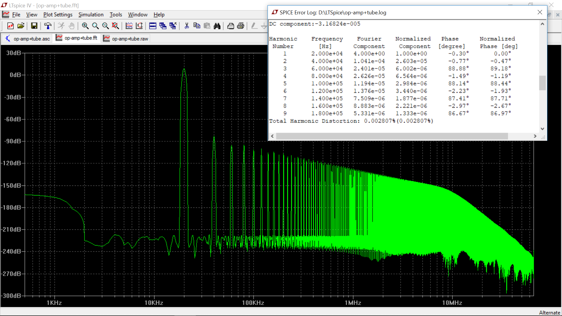

That is interesting because it matches closely to actual measurement.
One thing that may be artifact is the distortion decreases with increasing amplitude.
I did not mention it earlier because possibly it was my test set-up. Still looking at that.
Thanks for the sim. I did not think it was possible in grounded grid topo.
My measure system bottoms out at .003-4.
Your spectra numbers I've been lookin at, have a hunch on the golden ratios.

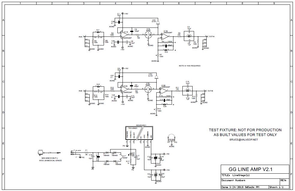

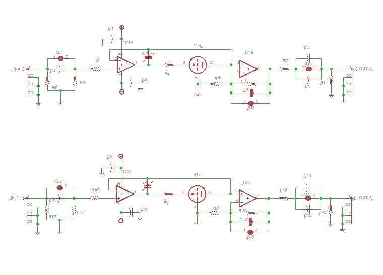

One more rev of the test board to 2.1 and then its locked.
Added CR1,2 (E-701 700uA) and some additional 0.1uF bypass caps.
Changed R1,R9 to 100 ohm for more output PP, changed the comp caps to 100pf fixed.
Opamp is specified as SA5532AP and power supply is now shown.
The pdf is good for printing.
Cheers

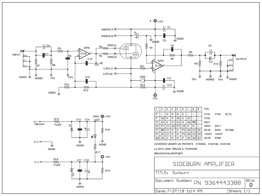

The last version of DOA valve hybrid was a failure, I used a 14pin thin quad op amp , the two additional op amps used for buffer since original DOA had hi-z output. The quad package oscillated badly and could not calm it down. I breadboarded same circuit and worked perfectly so chalked up to a bad layout.
Taking baby steps now backed up and did a stand alone board ( not DIP 8 compatible ) with buffers.
Ordered some boards, 2oz copper too for some other reasons. They should be here in week or two.
Two triodes in parallel are supported so reduced high Ra 12AX7 can be used.
