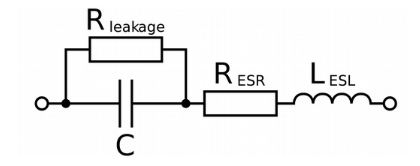

The equivalent circuit doubtless has some aspect of reality, and microphony can't be discounted, but we would suspect rattling coils as being far worse offenders. It's really not possible to make a 10uF capacitor out of pure gold foil and polyethylene without it being the size of a car battery though...

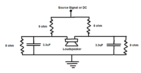

There's a very interesting and simple apparatus you could make to test capacitors sound quality, in fact I'm surprised no-one has done it yet!
You use the thermocouple idea to balance a system of two capacitors:
You then apply DC or maybe a 3KHz sine wave to this system. The loudspeaker (which may need a little balancing with potentiometers or varicaps to get exactly balanced) should then produce NO OUTPUT.
If the capacitors are microphonic, tapping one should produce an output on the speaker exactly like the distortion a capacitor might make. In fact you could place capacitors of different types (maybe even an electrolytic) in each arm, and the difference will be audible. Oh, I amaze myself sometimes!

Well.........one problem with the above is that if the two caps being compared are not exactly the same value then of course you will get some sound out of the speaker. If the capacitance and ESR differ then yeah you will get sound out of the speaker. For the tapping test it sounds like a good idea.I would think a much better "test" would be doing a SBT or a DBT if you think one cap sounds different from another.

It's just the old null-impedance idea familiar to all radio engineers. It assumes you make some effort to balance the bridge, but the surprising thing is it can be done in the resistive arms which is rather straightforward.
AC bridge circuits : AC METERING CIRCUITS
What makes it particularly powerful, is you can balance a series and parallel LCR circuit, for instance, which is useful to equalise a loudspeaker impedance or fit a impedance matching LC circuit.
