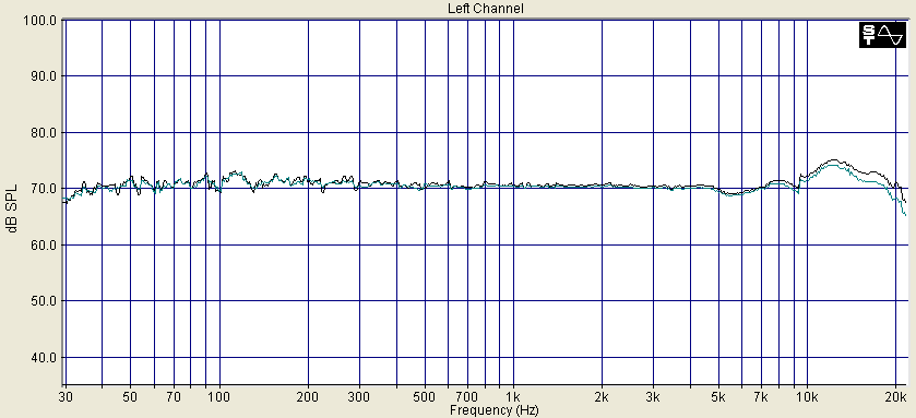

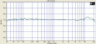

Most MCs of its era had a common coloration, a slightly depressed upper midrange and a peaked high treble.
The last octave peak is due to the tip mass on vinyl resonance. It varies in Q, centre, and amplitude between needle shapes, downforce, cantilever and its damping, ambient temp, actual vinyl mass / quality per record. As it is unmasked by the extended response due to low inductance, its there to measure. Few models overcome that. If mated with a trigger happy near there metallic tweeter's oil can resonance you are in for HF youth fountain.

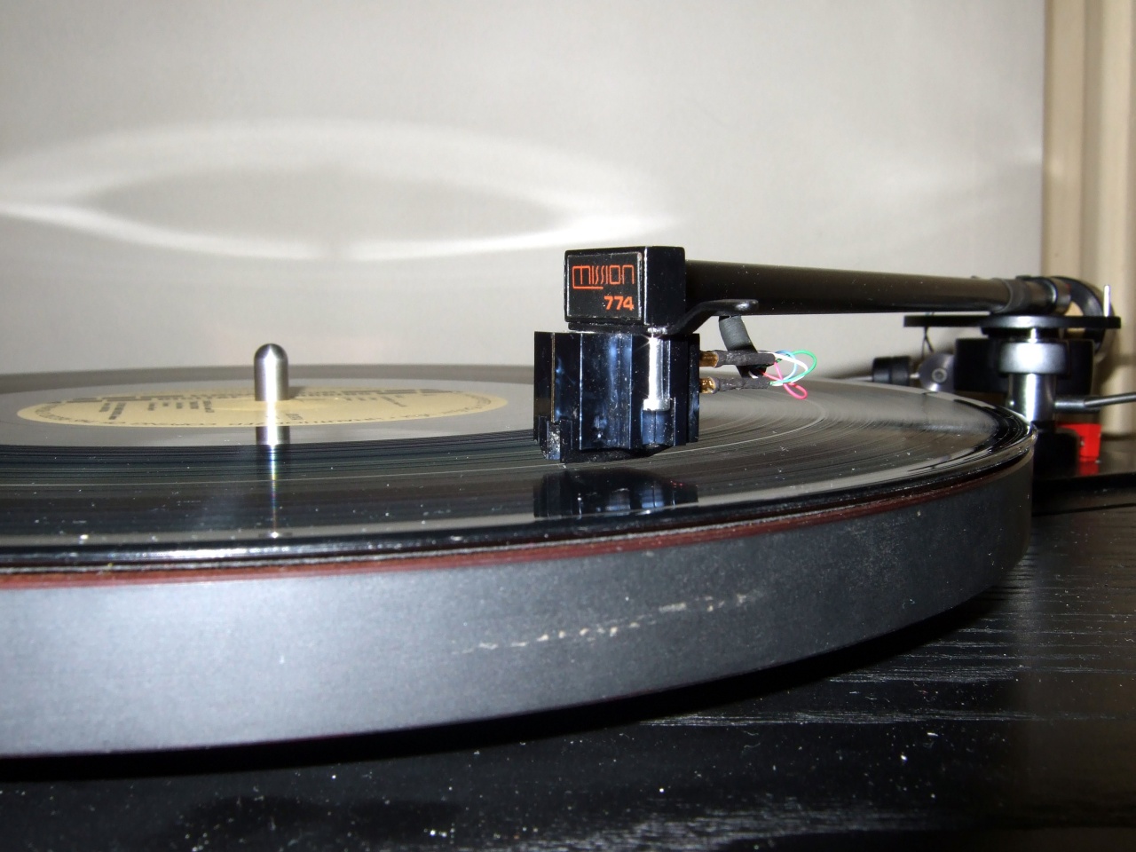

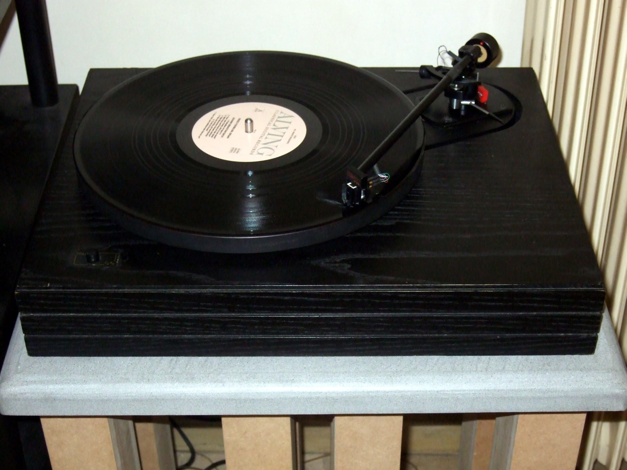

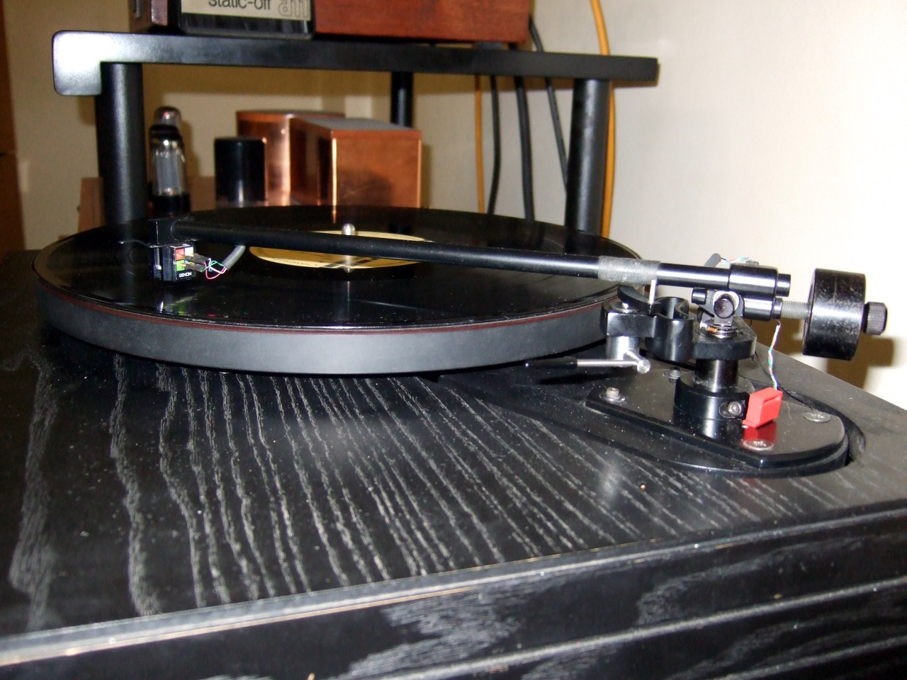

Here is a measurement I made sometime ago between two ambient temps (dif 10c with hair dryer aid ). Its for Denon DL160 on Mission 774 at 1.6g VTF on Telarc Omnidisc wideband pink. 1/24 octave resolution.
... on Mission 774....
Wow, I still have one in storage. Always looking for applicable (sealed, unpacked) replacement bearings. It just wasn't oddball enough so I swapped for a Grado tonearm.
Most suitable ULM arm to mount again those high compliance MMs for an RL/pF loading tune on FFT and give em a fresh ear on new gear. I expect its used vintage market price to keep on rising.
