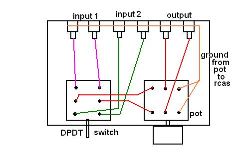

I have a t-amp (power amp) that I like to use but has only one RCA input. I want to use it for my PC (music files) and my desktop CD player and want to add volume/input selector.

For $50 you can build a nice passive attenuator with input selection. An Alps pot, three sets of RCAs and a toggle switch [...]

For $50 you can build a nice passive attenuator with input selection. An Alps pot, three sets of RCAs and a toggle switch should sound much better than a beat up old preamp and be far more compact.

any chance on the website that has the correct parts for the items u mentioned?, I have several RCAs, but no toggle switch, and do have a Alps pot laying around.

Heres a quick wiring diagram. The best toggle around is the Tocos sold by Percy Audio and the worst are the ones sold at Ratshack.
Keep the wiring as short as possible and make sure the RCAs are isolated from the chassis (if its metal).

thanks so much!, even I can follow this diagram, will order the DPDT (on/on, NOT on/off/on, right?) as u suggested. It will be in a small wooden case, the grounds on the RCA has to be soldered together? Thanks, again, I will do this. gychang

It works!!, I managed to follow your diagram, and soldered the RShack cheapie and Alps pot and it is dead silent in the background and music is glorious!!, thanks. Now I want to try 3RCA input, can u recommend a part?, seems like RShack and Partsexpress don't carry and I would like some recommendation, I will try some good ones this time for hopefully for my reference build. My soldering skills have improved and I am starting to get hang of this.
Thanks again amt. I will put up my pictures may be tomorrow night, just pure music without any hum, it is dead silent during music pause...
