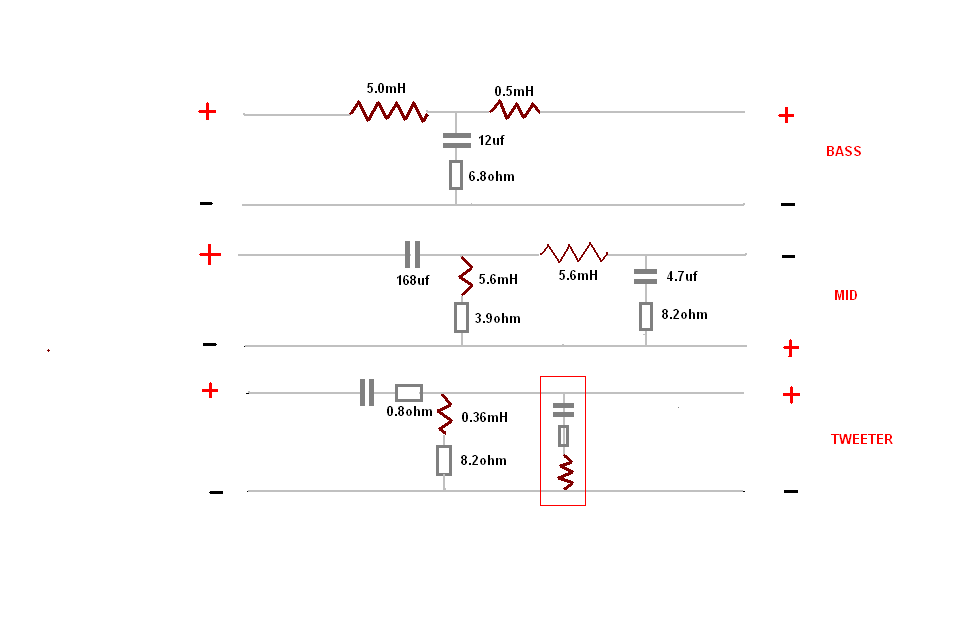

chasingame said:I need Re and Le. I assume I use Re/2 for two drivers in parallel. What about Le ?[/B]
Le also halves in parallel.
