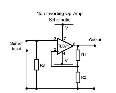

I've added a schematic below. Make R3=1M, R1=20k, R2=1k - 5k (vary gain roughly 20 - 4x) and add a 10u cap on the output.

on the output there is only one line, is that connected to the posative part of the output connector and the other end is just to the batteries negative terminal? cna someone explain how to piece that together? i know it sounds dumb, if i just get this then i will nkow how to connecte everything else. i know how to put hte resistors and all, but on terminal 4 on the IC, is htat to the negatice terminal of the battery also?(isnt that called the ground)
