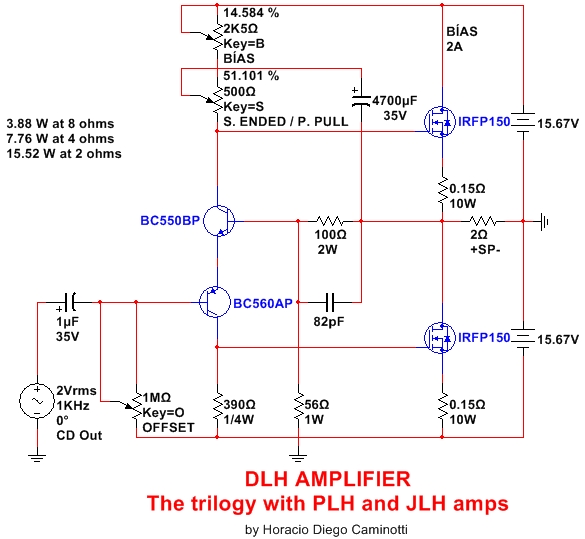

for those who are interested I have also now completed a prototype of the DLH. Yes it is extremely simple. Has only a few components, was made relatively small and performs okay.

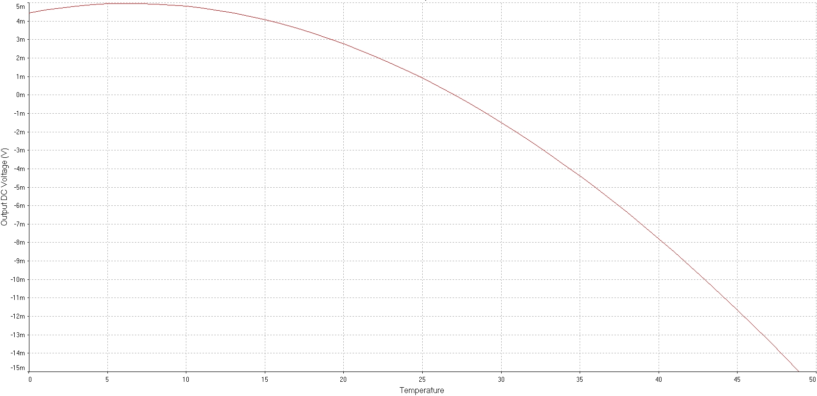

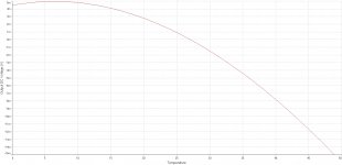

Unfortunately it is very unstable. The off-set runs all over the place and the amp will need some work using an auto off-set adjust if it was to be used in your installation.

Good assembly !. As far as I can see in your photos, there are notorious differences with the circuit of the first post. I can see under-dimensioning for the dissipation of some resistances. That could explain part of the displacements of the audio output.
I can also see that two trimpots are used instead of three.
Anyway, that defect has a cure. One possibility would be to use the compensating subcircuit (made from 2 bjts). Another possibility, although I have not tried it in practice, is to feed the base of the BC560C from the negative rail, through a simple adjustable resistance (whose value will depend on certain parameters of that same transistor). Although it is a solution that is not advised in other circuits, in this particular circuit would fit quite well. Here is how it would behave in terms of temperature variation:
I reiterate that the latter I have not yet tried. Maybe this weekend I'll prove it. Although in simulations does not seem to significantly alter the PSRR, I must test it in practice.
The subcircuit for compensation of post 11 has been tested. Although it works better compared to the circuit of post 1, in terms of offset, it has given me the perception that alters the beautiful sound character of the original circuit, since it introduces additional feedback around the BC560C.

I have not used trimpots in the final prototype I first adjusted the bias current then assembled it without trimmers.
Anyway I solved the fatigue I experienced by changing to Lateral Mosfets instead (2SK1058). The heat sink temp seems pretty much constant now and the off-set stabilizes when the heat sink temperature stabilizes.
I then adjust the off-set finally and it self stabilizes at operating temperature.
Not a bad little design after all. Always keep it simple then it works best!

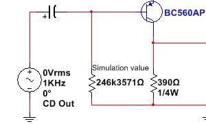

It has been successful to feed the BC560C base by a simple 1 M ohm trimpot from the negative rail. It has been necessary to do some iterations between the bias adjustment (2K5 trimpot) and the offset adjustment (new 1M trimpot), since there are dependencies between the two.
The offset has finally stabilized within approx. + - 20 mV, which is considered acceptable.
Although I could not measure the PSRR, there is no audible hum or noise even with very sensitive speakers. I use 6 capacitors of 4700 uF per rail.

As promised, I will include my modifications. Wrt the original design.Q4 has been changed to a npn buffer stage as Vbe is 0.6 volts and there is not as much variance as FETs. As the Nelson Pass Camp Amp is an inverting class A power amplifier, the input impedance remains at 10K. To bias the transistor replace the 5K trimpot with a 10K to set the DC voltage to Vcc/2. The IRFP240 Hex MOSFETS have been changed to Toshiba Lateral MOSFETS, as the transfer function is more linear. The 2SK1161 available on eBay. R1,R2 are in parallel and replaced with a wirewound 0.22 5W resistor as are R3 and R4 as this was a design simulated before construction.
The Power supply is a 19 volt laptop supply. Q3 and Q4 are BC337-40 devices. Low noise transistors are not required in this application as they provide no gain.
