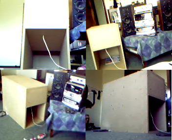

im living in new zealand,and there is only ONE event on a year i thought about going to,but it isnt my style of music....and its 1500km away in Auckland,, <its cheaper to travel to Australia ! >
so be thankful you can listen to music you like - ( on crappy speakers albeit )
:rolleyes: :dead:
hehe.
Id like to set up my own event
=eg an oversized party with my own hornsubs :smash:
30hz exponential horns coming up this month,im so excited for it LOL :rolleyes:
below=my first basshorn (40hz with an 8" )
Cheers all!
