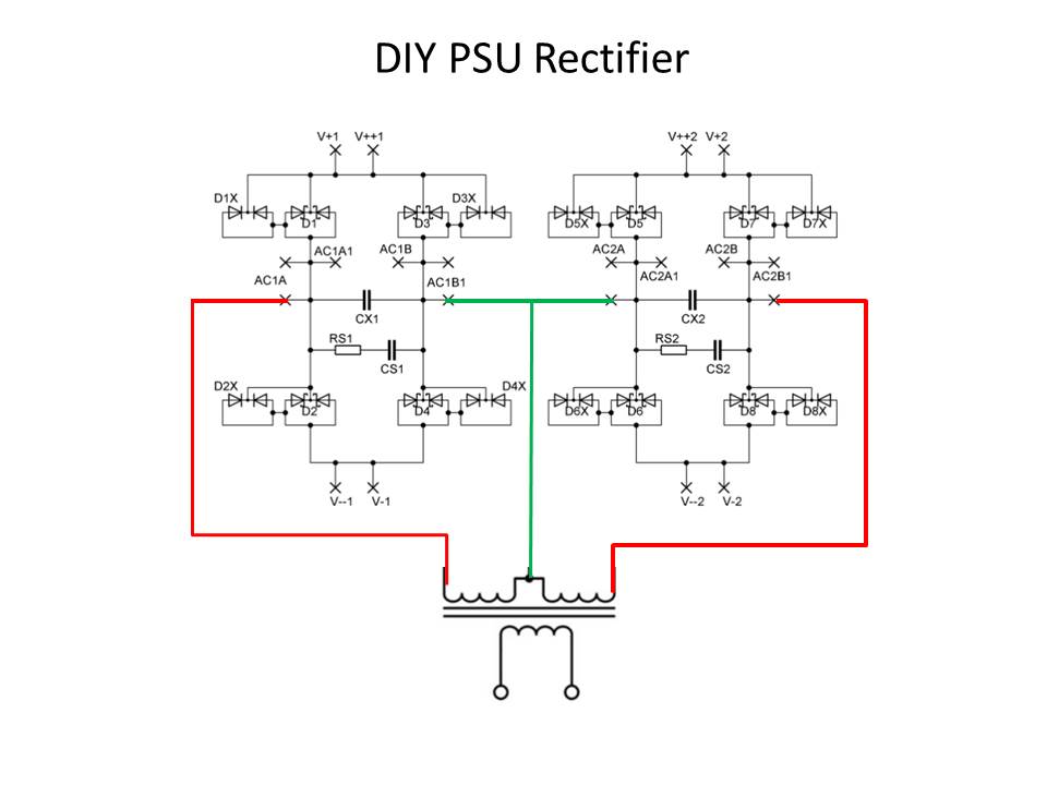

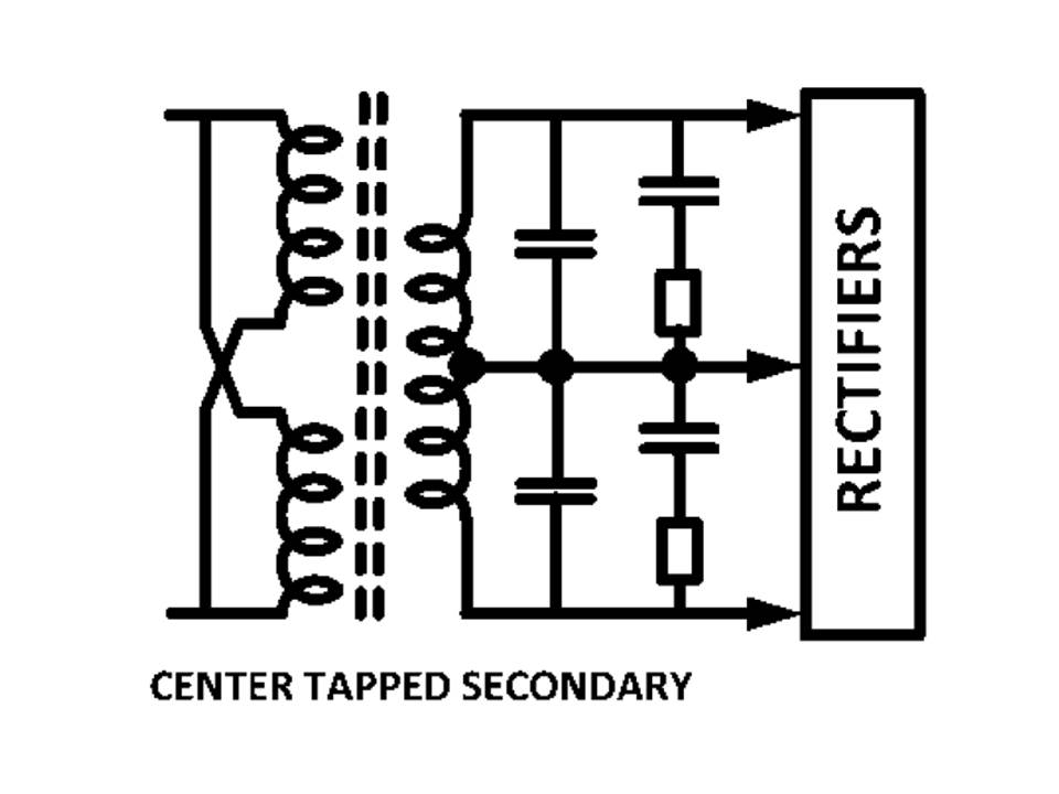

I want to use the rectifier stage of the DIY Universal PSU with a center-tapped transformer, and I want to snubber both legs against CT prior to rectification as shown in the attachment below. I'm pretty sure that the design of this board doesn't allow this--am I correct?Can someone confirm or deny my suspicion?
Thanks,
Ron

I want to use the rectifier section of the PCB for two +60 vdc rails using the MUR3020 diodes. I separated the rectifier section from the capacitor section.
Do I populate the rectifier board with all four diodes on each section?
Or do I populate the rectifier board with half the diodes on each section and only use the V+ on each board?

What transformer?
EDIT: Ok, now I'm visualizing what you are asking.
Stuff both diode sections with 4 diodes each.
DO NOT CONNECT GND together on the PSU.
On the D1 side, the connections will be labeled properly. But on the D2 side, the "GND" position will be positive and "V-" will be ground.
Is it a "true" center tapped transformer, with only three secondary wires?
Or is it a dual secondary transformer, with four secondary wires, but two of the wires are connected together to establish a middle connection?

See below. It is a "true" CT transformer--only 1 wire defines CT. If one is "allowed" to share the CT to both sides of the circuit, I would try to connect as shown below. But I didn't know you could do that. I'm happy to be wrong about that.
I should also mention that my application is a +/- dual rail supply for a class AB amplifier. I'm modifying an existing supply, not starting from scratch, so I don't have the luxury of choosing my transformer characteristics.

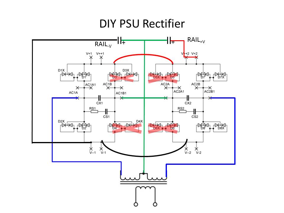

Or here's an alternate proposal, which uses fewer diodes, and seems not to break any rules. But maybe I'm making things way too complicated...

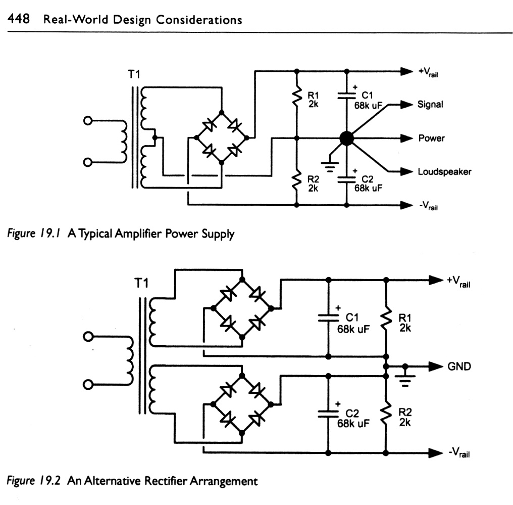

If you use a center tapped transformer (Figure 19.1), the center tap goes directly to ground. And there are only four diodes in the power supply.
If you use a transformer with dual independent secondaries (Figure 19.2), each of the two bridge rectifiers {eight diodes in the power supply} has an output connected to ground.
I am beginning to think you won't be able to use the diode board with your transformer; I am beginning to think you will have to create your own diode board. You can use the filter capacitor board with C-R-C. But not the diode board. The diyAudio Universal Power Supply PCB was designed with dual independent secondaries in mind.

Thanks Mark, I've been staring at those same two diagrams from Bob's book.
Did you look at my alternate proposal? It seems to like it could work with the use of a couple jumpers on the board.

The bodge / kludge / rig-of-the-merde shown in #1212 looks like it may work electrically, I have no idea if the required modifications are easy or difficult.
