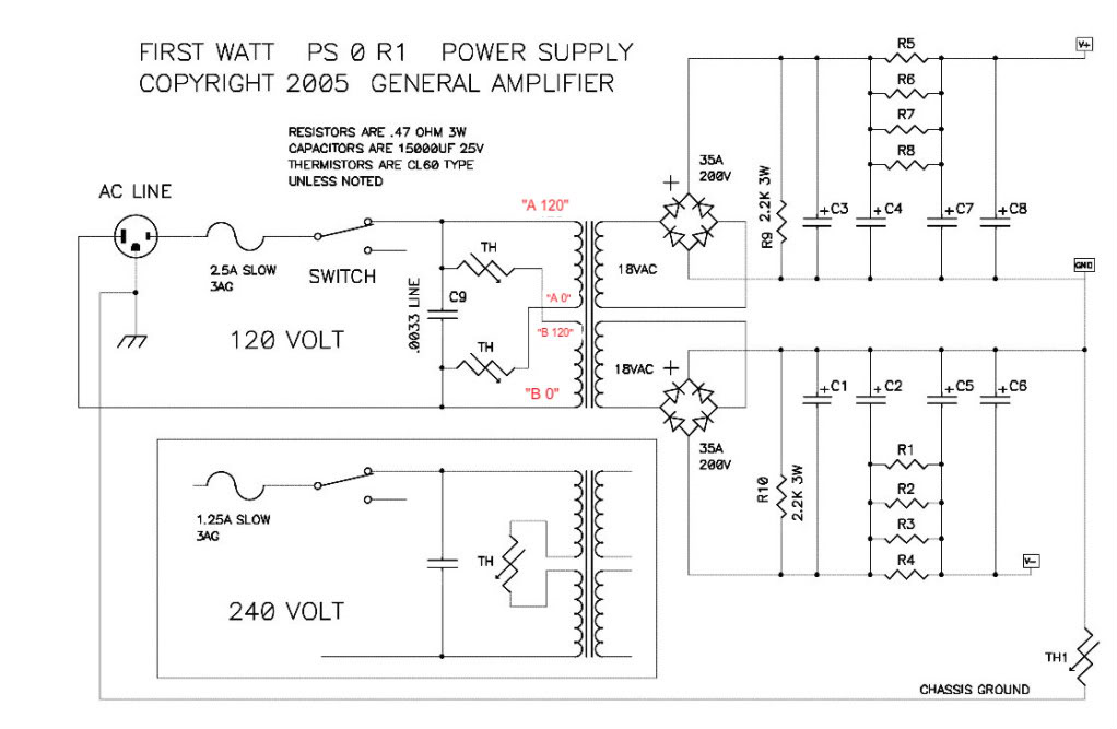

Few helps for Danilo (newbie)
Hello from Danilo (first post, newbie, Italy, Rome).
I've few questions... maybe someone want help me?
1) I would like to buy the Antek AS-4218 Transformer; how to get 18V from input AC =230V (and not 115V) ?? Is it sufficient following the 240V section of the attached schema?
2) I don't understand how to choose the capacity: In the web I can find both 10-15.000 uF and 33000 uF. How the output depends upon the capacity?
Thanks a LOT!!
Danilo

Man, Went through all these post. I'm Building a sneaky Pete M2 Clone amp in a Denon enclosure. I've seen two different grounding schemes. First: has all grounds connecting to the star ground on the PSU board including ground from the transformer on the Chassis. Second: Two different grounding points. IEC Ground to Chassis and Star on PSU everything else. Any preferences? Also I have an Antek AS-3218 transformer so ground (Purple Wire) always goes to the Star PSU ground on either Configuration? Cheers
6L6
Moderator
Joined 2010
Purple goes directly to the chassis. Same place the safety earth from the wall attaches. Do not connect to audio ground.
Starground on the PSU works pretty well, but the PSU ground should be elevated off the chassis by a CL-60 or a couple big diodes. CL-60 is easiest.
Check your PM
Check your PM

Question regarding the resistors on the PSU Board. R5-R8; it looks like the flow goes from the bleeder resistor (R9), to the LED, the resistor to the LED to R8 down to R5. Due to space constraints I only want to use the space for R6 for an Inductor. Can I jumper R8 and R7 so the circuit completes to R6 where the inductor will take over?
