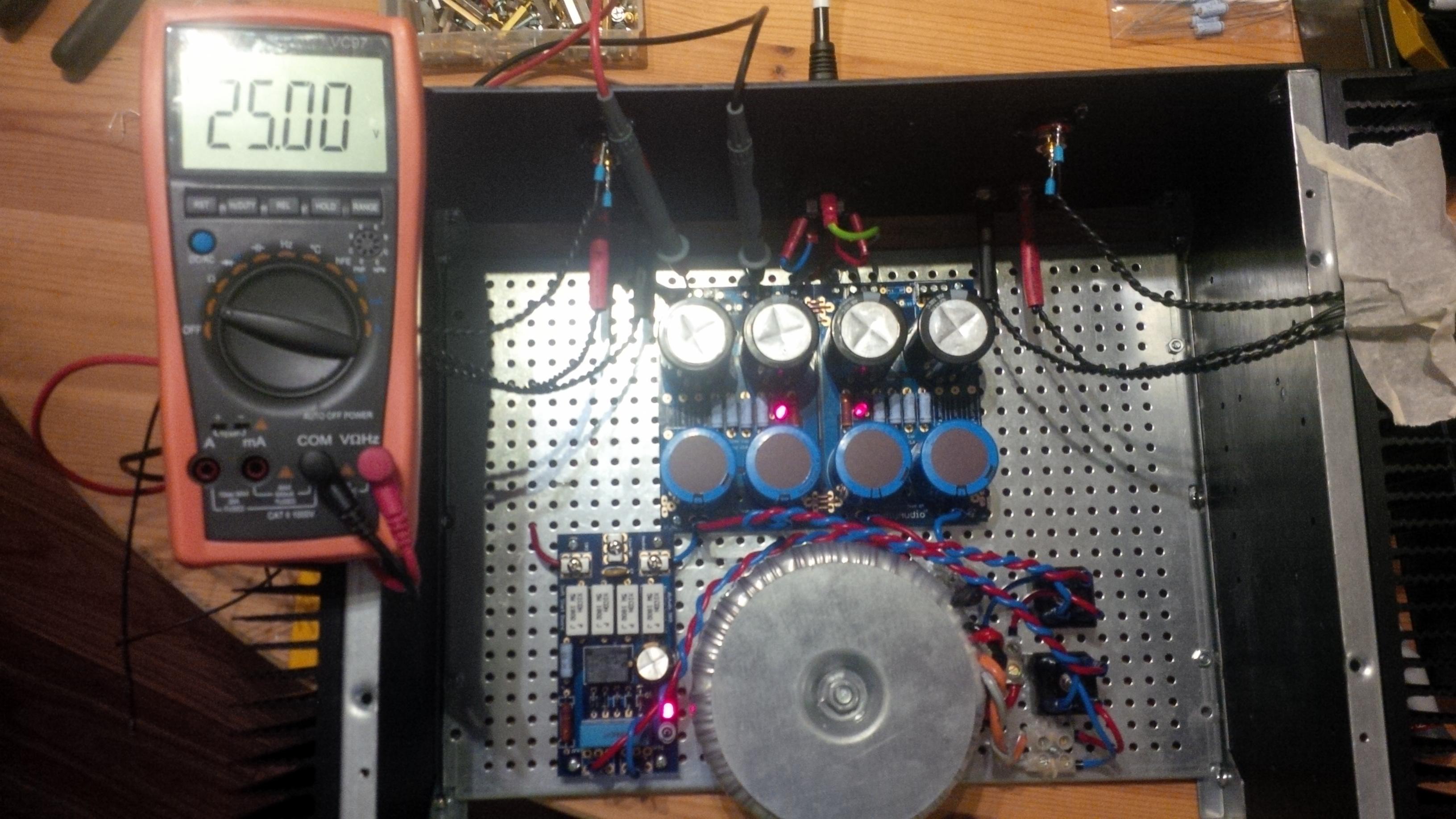

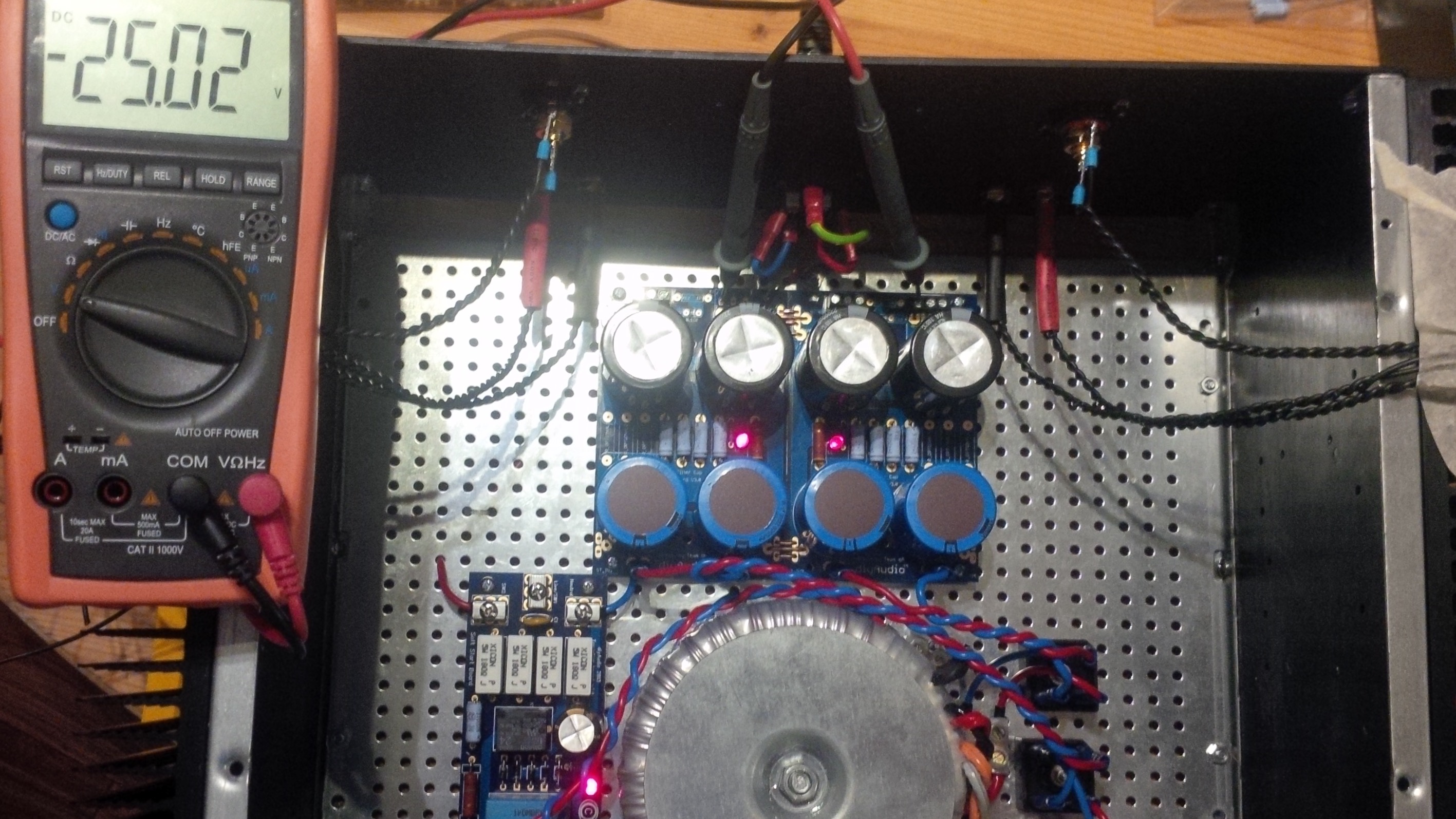

Just preparing for my Power supply boards to arrive, so I wired my transformer up and my bridge rectifiers and got a few readings I didn't expect? It's a 18v 18v 400va transformer , which shows about 19v on the secondaries but readings after the bridges are about 17.6dc..?? Is this normal? I thought the dc out was higher than the ac in?!

you have done the first part of your checking. Getting the transformer to power on without the bulb lighting up is good.Just preparing for my Power supply boards to arrive, so I wired my transformer up and my bridge rectifiers and got a few readings I didn't expect? It's a 18v 18v 400va transformer , which shows about 19v on the secondaries but readings after the bridges are about 17.6dc..?? Is this normal? I thought the dc out was higher than the ac in?!
Thanks.....
Now add on the smoothing capacotor/s and see if the bulb still does not light up.
