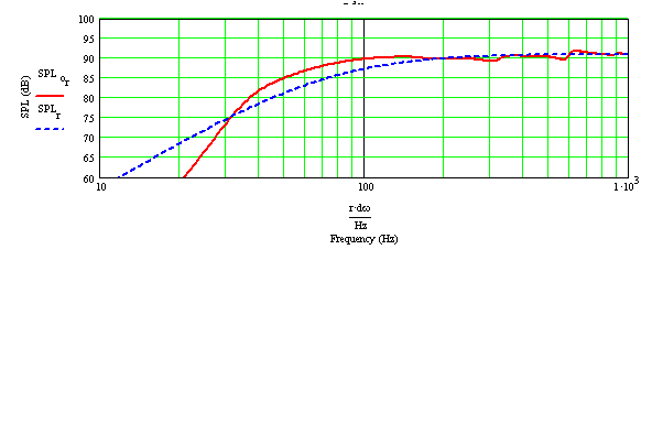

Courtesy Martin King's MathCAD worksheet

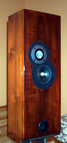

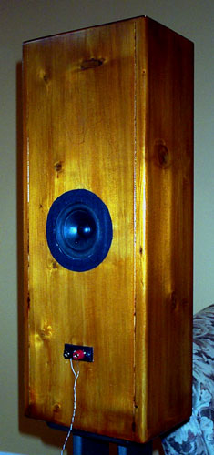

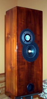

Timn8ter said:A straight BPTL would look similar to this.
as drawn we have put the drivers on what would be the sides of these boxes...
Note: the speakers Tim shows are inspiring... a real Frugal-phile(tm) delight (and giant killers)
dave

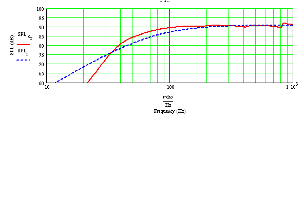

V0.1 plus 2" courtesy of Martin King's MathCAD worksheet

Timn8ter said:V0.1 plus 2"
These are the most recent posted both straight bi-pole & monopole, and folded monopole (folded bipole will need to be extended 1" at the bottom)

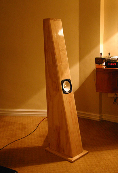

Another design concept for the bipole:
Rather than folding the TQWP, it would be nice to mount one driver on the slant face @ 50% and on on the back face right behind it. This would reduce the off set issue and eliminate the need for a stand. A nice slot port in the front and a granite base would be my choice. Thoughts?
This is monopole but exemplifies the concept.
