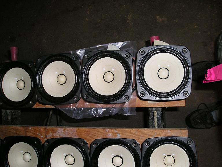

Godzilla said:The 127e has a slight ‘hysteria’ or excitability that I wonder if the modification cures?
Mark MacKenzie noted 2 or 3 resonances to tame and talked about high levels of cone talk. When we were developing the Fonkens, there was always something in the background that the FE127 putting a rough edge on everything.
Cone talk is something i've been dealing with for 25 years with puzzlecoat so that part was easy. Mark MacKenzie left a couple clues as to how to cure the resonances. I took what i'd seen in his other driver mods, my experience and the tools at hand, to try out a scheme on the 127.
We were gobsmacked.
There is more on the mod on my Fostex driver page with a link to the FR Forum thread where i outlined the procedure i used. I've refined that a bit since then and will be getting a page up with a more detailed & up-to-date how to.
I have no idea whether i've reached the the best attainable, but they do sound better. And they are prettier (certainly more interesting). The 1st ones are in the field now, so hopefully we'll have some feedback soon.
The cone mods require damar, puzzlecoat, applicators, and (optional) colourant if you want to change the color. Best if used with the felt & the ductseal tweaks.

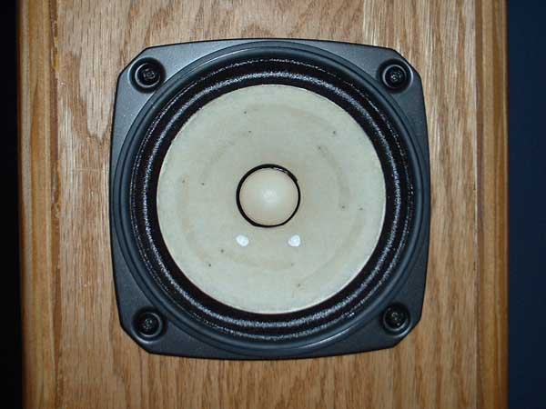

I have modified a few drivers so having a go at the 127e was not a scarry thing for me. Her is a photo of one of mine. I used an artist brush to get a thin line of damar. I made a guide to ensure I was in the region that Mark Mc recommended. After the damar dried I applied a thin coat of moodge poodge (a puzzle coat variant). I have not heard them yet but i have heard a set that Dave had worked on, and I was impressed with the out come. Once I get the final finish on my bipole fonkens I will have another set in the fostex fleet to listen to. Hmmmmm..... That makes seven sets of speakers in the living rooom! I will have to get rid of some of the furniture!!

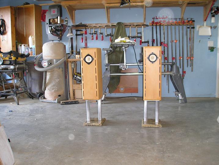

Here is a shot of the bi-fonken from last week. Things have changed a bit. The stand legs have been painted black and the first coats of the final finish has gone on the cabinets.
Listening session sometime in November?
