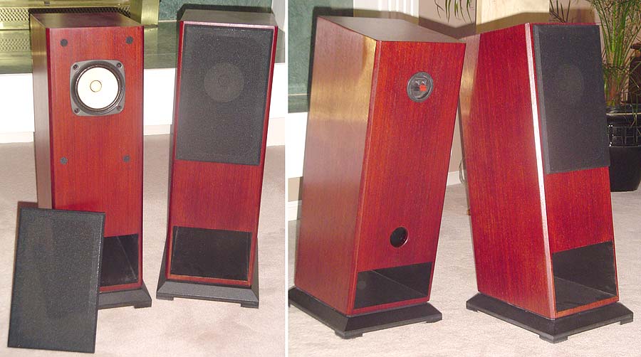

Better pics of the folded monopoles that we did for Chris' mom....
dave
