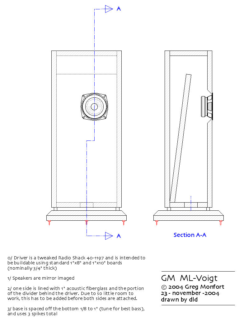

planet10 said:Something like this? I choose xSection breakdown based on minWidth and added a bit of a base... driver mounted on slantSide to keep minimum height....
dave
Pretty short huh? I like the base. Nice touch! It could be easily folded too.
Timn8ter said:It could be easily folded too.
It would... make a nice compact stand-mounter -- and facilitate a nice bi-pole too

Exactly what I was thinking. BTW, you nailed that drawing. Just like it came out of head and magically appeared in myriad little dots.

The vent/base design looks awfully familiar. FYI, the 126 with ~5 ohms (whatever gets Qts to ~0.403) looks great in those folded 40-1197 pipes, with 8 ohms yielding ~the same response/BSC compensation.
GM
GM said:The vent/base design looks awfully familiar. FYI, the 126 with ~5 ohms (whatever gets Qts to ~0.403) looks great in those folded 40-1197 pipes, with 8 ohms yielding ~the same response/BSC compensation.
It -- or the BD-pipes i've been living with -- inspired the port & bass. The 3 points are definitly inspired by your design.
A lite version of GMs pipe attached. He has donated the design to the transmission line speakers site with the intention that plans will be distributed on a "by donation" basis... even without having the page up or the details of distribution worked out i've already had one donation of $25 for the plans.

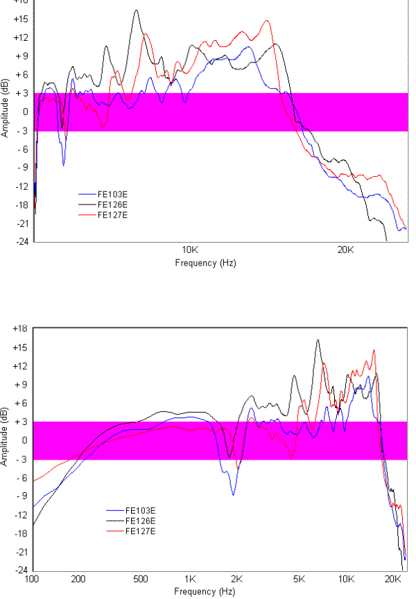

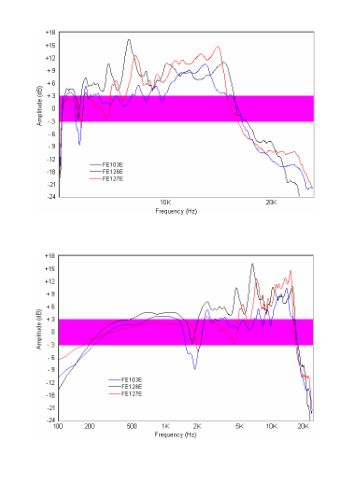

Tim Forman was the forum member supplying the FE127E driver. Thanks Tim. The FE127E driver arrived Monday afternoon, January 3, 2005. I have completed a comparison test series on the three drivers (FE103E, FE126E, and FE127E). I used a test bed I have talked about before. It was design to eliminate as many extraneous variables as possible. This is also a test bed with a substitutable driver mounting baffle system. This allowed me to swap drivers while holding all geometric arrangements constant between driver and microphone with a high degree of precision. In addition, driver levels and microphone gain were held constant across all tests.
There are a couple of items I want to mention before I post the comparison response attachment.
First, the phenomenon of psychoacoustics plays a part in evaluating drivers with music by ear alone. One psychoacoustic’s phenomena is how the ear/brain tries to compensate for large spurious vibration modes. Our ability to hear error in reproduced music decreases when the errors are extremely large. As the reproduced music comes closer to being error free, our ability to hear small errors increases. This produces a tendency to underestimate just how bad a really bad driver may be.
Second, the look of the graphs has changed since my last post. I am using a different analyzer system as a backup. Between December 22 when I last powered down the acoustic analyzer and December 27 when I powered back up, there had been a hardware failure in the front end/AD portion of the analyzer system. It is not going to be an easy or quick repair (even if it is repairable).
Until the main system is repaired, I will be using the backup (a portable system). I have done extensive work to validate the results from the backup system.
For now, to the limit of the extremely small sample size, the tests I post here are of an acceptable level of accuracy and resolution. While I post the first of the tests without comment, there is much we can talk about the performance of the three drivers.

I am posting a second attachment that should be easier to read.
Really better, thanks.
Considering the curves don't you prefer the FE126E now ?
