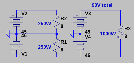

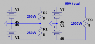

Does this illustrate your point? The voltage sources are equivalent to 250W-8R amplifiers (4R 500W in bridged case).
A bridged amp puts out the same total voltage into 8 ohms as it does un-bridged into 4 ohms because that is what it sees when bridged. An amp rated for 250W per channel will only produce 1000W bridged IF it can produce 500W per channel into 4 ohms in normal operation. Of course, then to make use of it you must have an 8 ohm speaker that can actually handle 1000W.
