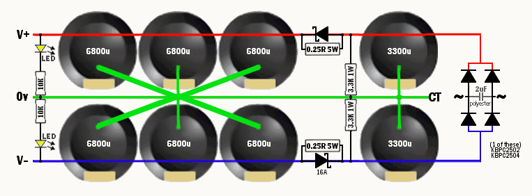

CRC filter supply for use with a high power amplifier that has a wide range of current. The resistor is for use during low/normal volume playback and the diode is for use during maximum power loud playback.Why do you include a diode and paralleled resistor in each rail?
The voltage loss of my power supply crc filter is diode limited to 0.3v, because low loss is quite attractive and because Honey Badger already has crc filtering at small signal.
A good question would be, if the 0.25R was reduced to 0.125R (without the bypass diode) then how much more capacitance need be added to maintain the same crc filter effectiveness? That probably wouldn't be an inexpensive compact supply; however, it would be an interesting comparison.
The loss of my power supply crc filter is diode limited to 0.3v, because low loss is quite attractive and because Honey Badger already has crc filtering at small signal.
It might be interesting to audition the amplifier at high and low volume levels with and without the resistor-diode combination bypassed.
Generally, halving the resistance in a C-R filter requires doubling of the capacitance value after the series resistance element to achieve this.

@currentflow
Andrewt asked for removal of the bypass diodes, and, that should not be ignored, so, I' d like to ask. . . what is the resistor value and how much is the tank/reservoir capacitance when the loss is not greater than when using the mbr1645 bypass previously posted? In this case, assume a honey badger amplifier and 36'0'36 transformer and an 8 ohm speaker.
In this case, greater capacitance, more bulk and higher expense is okay. In this case, I believe it to be a valuable point of reference. Best guess is most certainly suitable so long as it is likely to work.
And, thanks!

@Daniel
The value of resistance depends on several factors:...I' d like to ask. . . what is the resistor value and how much is the tank/reservoir capacitance when the loss is not greater than when using the mbr1645 bypass previously posted? In this case, assume a honey badger amplifier and 36'0'36 transformer and an 8 ohm speaker.
And, thanks!
a) The amount of voltage drop you are prepared to tolerate. More resistance = better filtering for a given capacitance, but with a greater drop.
b) The amount of current being supplied by the PSU. I assume you are using one PSU for stereo = 2 channels?
Taking the above into consideration, I would have thought a series resistor value of approximately 0.1 ohms or less should suffice. In practice, at a peak loudspeaker current of around 6A, the voltage drop caused by the average supply current would be imperceivable. I doubt that the PSU would benefit from adding further filtering capacitance, unless you intend to listen to test tones at near clipping levels

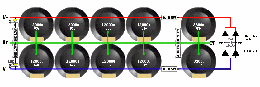

Thanks!...I would have thought a series resistor value of approximately 0.1 ohms or less should suffice. In practice, at a peak loudspeaker current of around 6A, the voltage drop caused by the average supply current would be imperceivable.
Then with the previous resistor at 0.25R, and the previous reservoir at about 20,000uF per rail, the difference in both cases is 2.5x, right? So, with 0.1R, the needed reservoir capacitance is then about 50,000uF per rail, right?
With the 0.1R, would it be safe to assume that for tank/reservoir, 4 of 12,000uF caps per rail would be close enough?
Do the first caps need the 3,000u size revised, upwards, a bit, as well?
Popular music at full blast--is that fairly close to the description?I doubt that the PSU would benefit from adding further filtering capacitance, unless you intend to listen to test tones at near clipping levels
Speaking of clipping and other hf raspies, do you think there could be some benefit to slipping a tiny little miniature ferrite bead over the pin of the 0.1R for getting a little more effectiveness without a greater voltage drop? And, if so, which end of the resistor would that go on?
If you want to filter to the same degree as with 20400uF and 0.25R, yes.Thanks!
Absolutely fine at 48,000 uF.With the 0.1R, would it be safe to assume that for tank/reservoir, 4 of 12,000uF caps per rail would be close enough?
This will have little effect on the low-pass filter characteristic (unless the wiring between the transformer to bridge and bridge to that 3000uF capacitor has significant impedance), so no change needed.Do the first caps need the 3,000u size revised, upwards, a bit, as well?
Sorry, I have no experience of the effect of a ferrite bead in this application. In any case, such a small inductance value would really only benefit RF attenuation.Popular music at full blast--is that fairly close to the description?

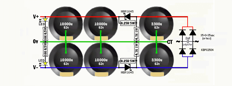

With or without the bypass. . .
Thanks Currentflow! This helps to make a more complete picture
A compact crc power supply with the bypass diodes
(For one supply per channel, such as monobloc, dual mono.)
-Or-
Without the bypass diodes here is an orthodox crc power supply with similar filter effectiveness
P.S.
To make it fit in the amp enclosure: Cable can be substituted for the 0.1R, such as using 2 boards (br board with first caps, then some cable, then tank/reservoir board, in which case the 0.1R-5W are not used), and that can help for easier layout but is also useful to heatsink the bridge rectifier for capacitor longevity.

Okay, I did. However, that made the supply much larger. It is so different, that the application may also be different. Perhaps the larger supply suits either a stereo amp or a dual mono amp with a Much larger enclosure to fit the bulky supplies. Else not enough room to install an audio amplifier in same enclosure....But delete that spurious diode in each supply rail....
Perhaps it just shows a good reason to get a big-enough amp enclosure.
