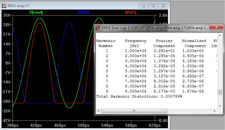

(below 1-2) is the output for a 30db gain Badger.

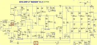

Schema is updated to reflect the exact V2.4 PCB.
(Attached) is the V2.4 LT(.asc), preset to show 10K THD @ 62ma OP device current.
Comments are included for gain,bode plot - add AC1 to power supply(s)
for PSRR (and more). :)
PS (edit) R3 , R6 =27K - lowers the gain....

I think an error has crept into your drawing: it looks that point R (where Q1-2 emitter resistors meet R14) is connected to the ground.
Also optional anti-saturation diode is not shown. It might be worth showing that optional connection in different colour on v2.4 circuit diagram.
Could you explain to me please how C5 optimum value (here 47uF) is determined? That part of my old notes got lost. Thank you.

Q1,2 were transposed with Q21,22 as well. R8 was supposed to be 100R.

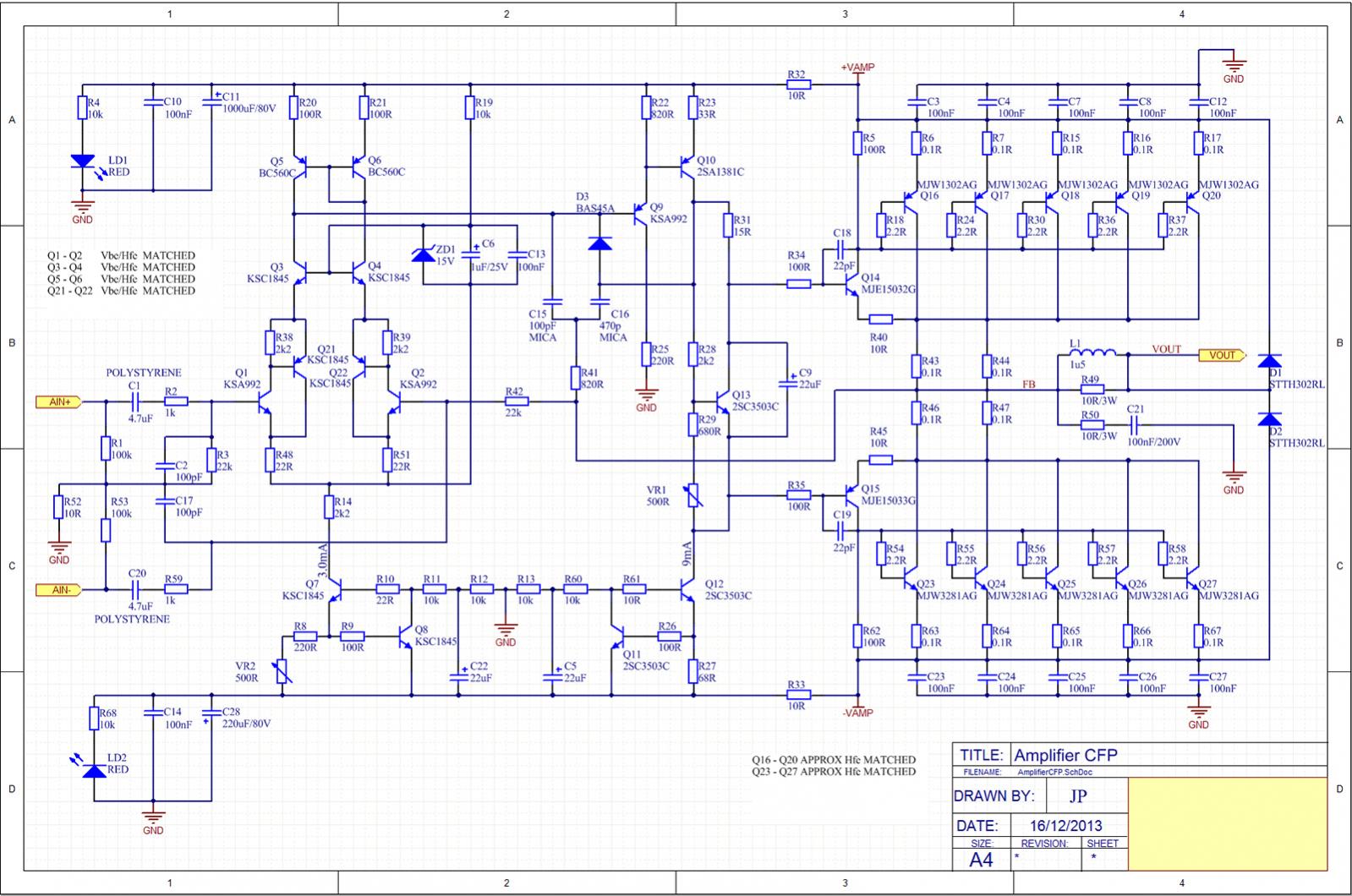

The values of the "emitter" resistors on the CFP output stage (R43-R47) have a direct influence on THD as sim'd by LTspice, hence 0.05R here. I have 5 x OP to remove the "need" for SOA protection (for the most part....) I note also that Self mentioned increased THD with the increased number of paralleled transistors in a CFP output stage. Something I have not sim'd myself yet.

With the wide selection (range) in global sourcing , a CFP would be problematic.
I would add a stable triple to the badger. 4-5 OP pairs driven by another
set of njw0281/0302's.
OS

Anyways, I have found (with simulation) of the CFP stage quite noticeable crossover artifacts at high frequencies which I cannot resolve. I am wondering now if this is due to the comments made by Cordell and Self in their books about turn-off issues with CFP stages and also being worse with more paralleled devices?

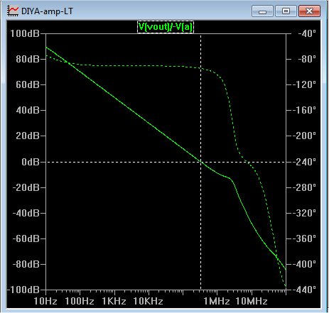

Increase value of Q1/2 emitter resistors from 100R to 220R.
And increase R24 (tmc feedback resistor) to 1.5K.
This compensates the gain of the IPS to offset higher beta devices.
It will lower the unity gain freq. to 327Khz , but this will not be audible.
Bandwidth is still way above 100k ! :)
Bode below .. rock solid.
Ps - 150R would also work well - 470Khz UG....
OS
