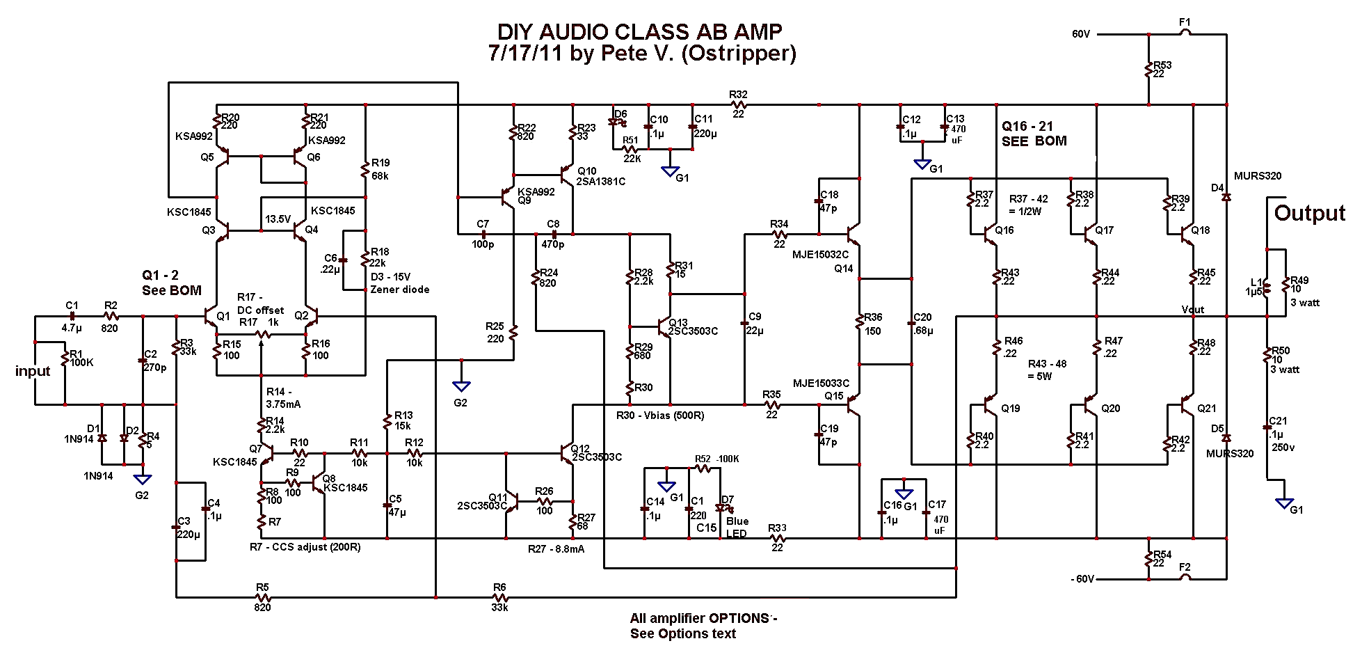

The original was dark gray background with dark red print--not readable on some printers), although you'll need some legal size (long) paper and print to fit. There was nothing I could do to make it legible at "birds eye view" (see all at once) on a computer screen, due to the large size schematic.
While looking that over, I spotted a few things:
There was a glitch in the original and Q12, Q10 labels needed repaired. I think I did it right, since the original was mostly readable, but please check.
D6, D7: Led's vary vastly, so the BOM needs a Fairchild model number listed. This enables the builder to check a datasheet to learn the desirable voltage curve and knee.
Parts availability challenges since July 2011:
KSC1845 and KSA992: That is not specific. I hope it means KSC1845F and KSA992F.
2SC3503C is discontinued. KSC3503C is discontinued. KSC3503D is not discontinued but I don't know if it is okay to substitute, and I don't know what other substitutes there may be for these low availability types.
KSA1381C is discontinued. KSA1381E is not discontinued, but I don't know if it is okay to substitute, and I don't know what other substitutes there may be for these low availability types.
SC3503 and SA1381 are a pair and HFE match is currently unavailable, but I don't know if that factor is important.

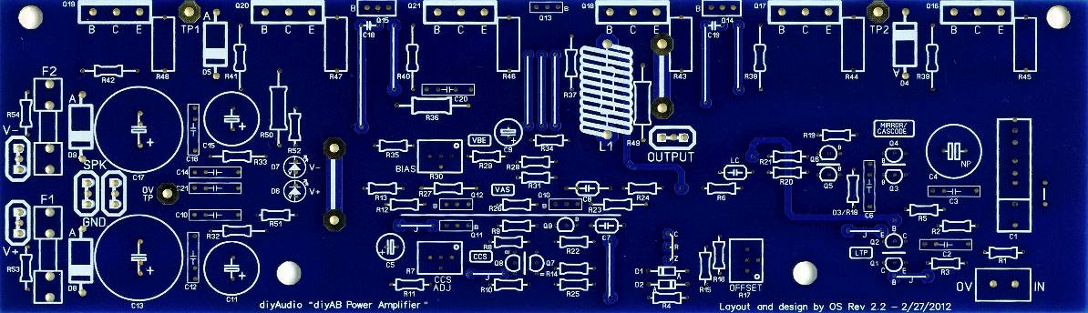

Although the schematic specifies some discontinued versions of parts, the rather beautiful board is not affected since it has numbered references. The only thing about this large project suited for beginners is that the nice board turns complexity into simple soldering. Good job!

That is the original schematic, no more dark grey since the boards are already out.
Q10 and Q12 seems to be right where they should be. I have built the official diyAudio Honey Badger prototype using the same files to test the validity of the board. If there is something wrong with the schematic/board label please feel free to point where the glitch is.
D6 and D7 LEDs are just there for indicating V+ and V- are up and running in the board, I believe there is no direct effect on the sonics of the amp and so any Red/Blue LED available at your parts bin or nearest parts shop should be ok.
As for the discontinued parts, most are still available elsewhere in the world, but in the spirit of making this "continent" proof, the official Build Guide shall have a list of potential alternatives which should be, again, available at your local parts shop or favorite online vendor.
