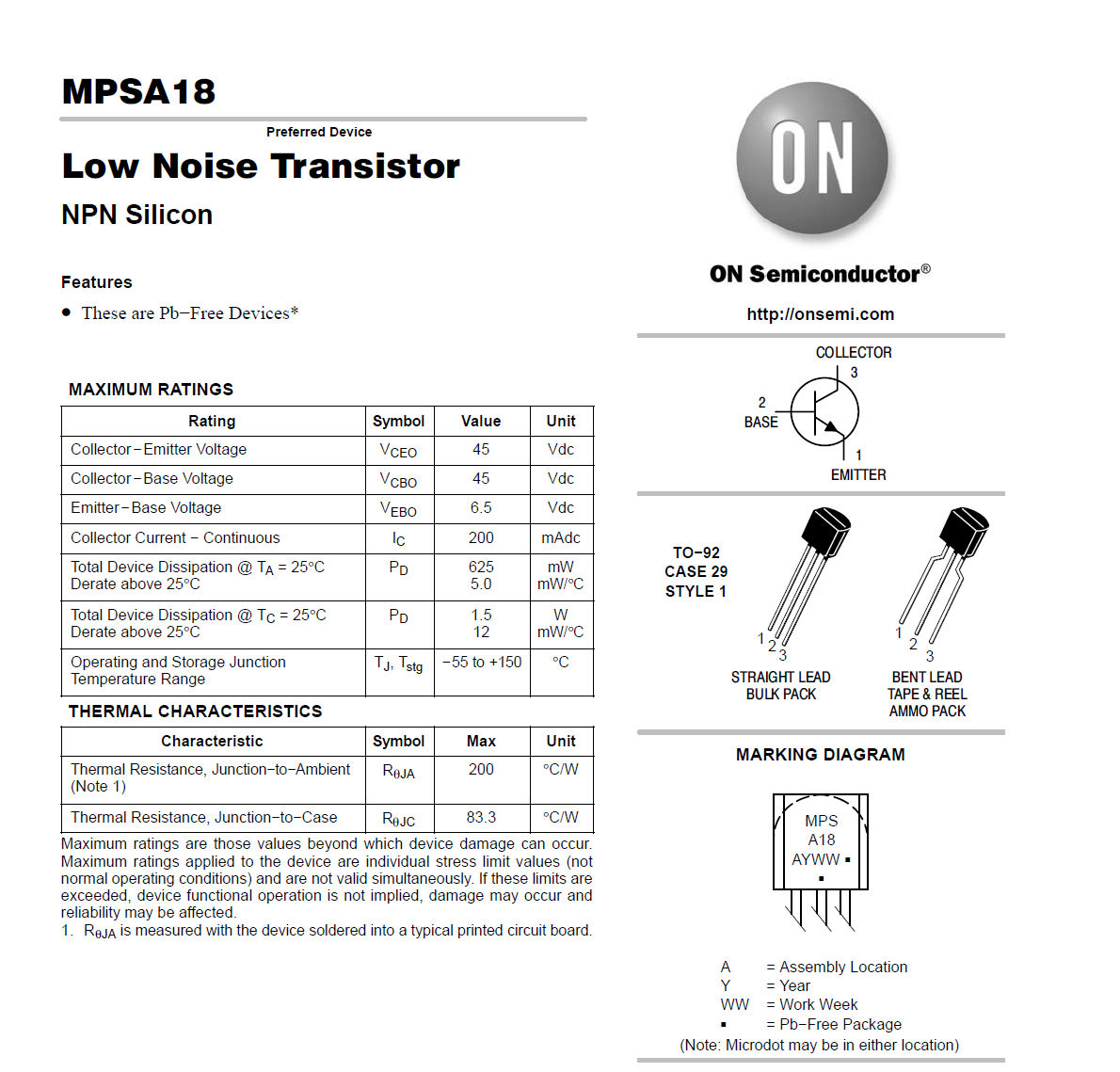

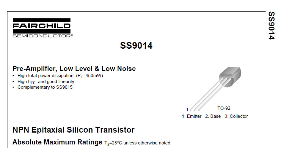

Now, since you are cooking those two resistors, and we have established that they are correct.... something is shorted or reveresed. There should be very little on 54-53. When you get it right, that voltage will drop.
Have a look here if you haven't already....
Okay, so how do I check for a chip installed worng? Well, we don't know what you used, so you need to look up the pinou of every chip used and then compare it to the schematic, to make sure the orientation is correct, and aslo that it worked right as it should diode wise.

After looking through the other pictures, looks like the outputs are correct if you didn't switch NPN and PNP.
I did notice that the small heatsink is fairly thick, make sure no leads are contacting the heatsink.
this happened to me, and the dim bulb tester saved the output trannies from frying....
so now, in order to avoid mistakes, i put red nail polish on the leads closest to the body for all npn's and white nail polish on all pnp's, and test them before soldering in...
taking extra steps helps in the long run, specially since the laser marking can be difficult to read with my 67 year old eyes...
