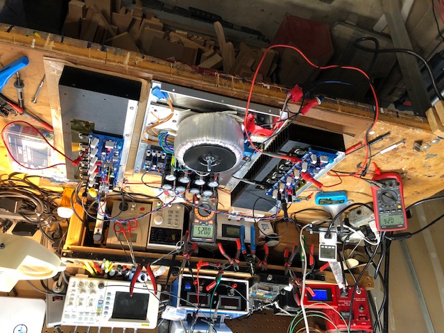

Making progress
I agree with both of you I suspect it to be a component because on the second board I am slowly removing and checking components and have not found it yet it still is acting like the first board and since I populated the boards together and they both had the same problem it has to be component issue unlikely a solder joint although **** happen s just glad making progress thank you guys!
both boards up and running
You know that’s what I thought too, but they all necked out we will see on the other board what I find!
Want to thank you folks for the help. Got them both up, I think I had one bad component that caused the issue, it was in the input stage and I am not ever sure which one.
I do know this I have a lot of spare parts. Now I am on to the next stage testing the sound and I already have built the box.
When I get it sound tested and in the box I will report back Again thank you all for the help.

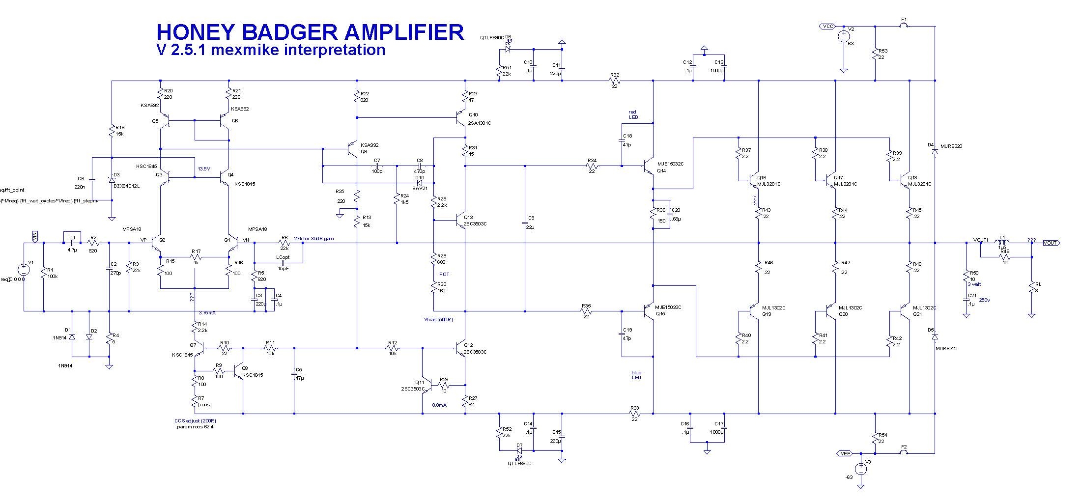

Just made a few changes as noted in the revision box.

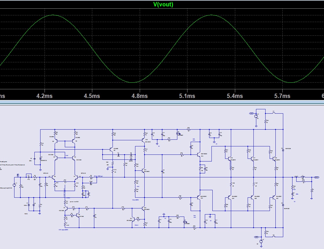

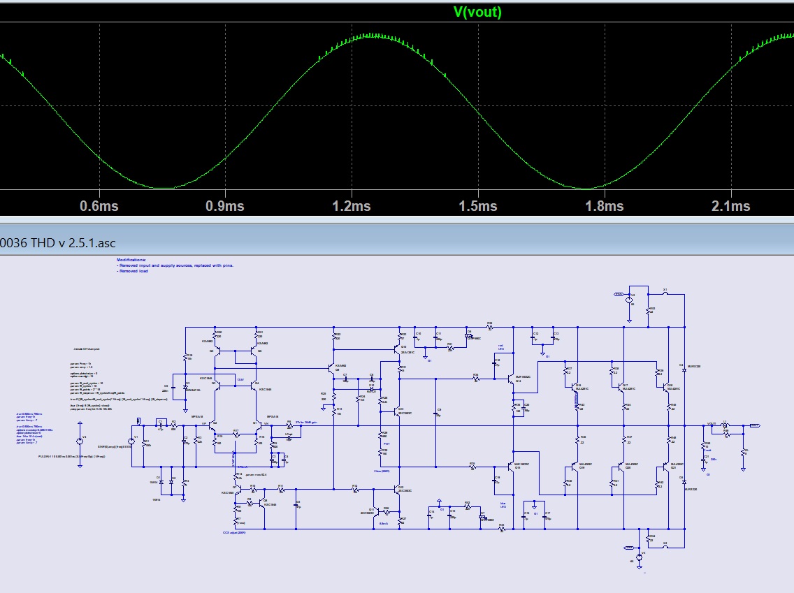

Hi stuartmp,
I liked your easier on the eye Honey Badger Sch - V2.5.1 schematic and pushed and pulled my LTspice sim around to agree with it (I shorted some of the caps for FFT analysis following a YouTube video I saw, so not permanent)
Connecting D10 and C7, as per your schematic, to Q9's collector gave some nasty results on the positive peaks of the output with 0.6%THD, which took minutes to simulate.
Connecting D10 and C7 to Q9's Base gave really nice results at 1KHz and simulated normally.
Harmonic Frequency Fourier Normalized Phase Normalized
Number [Hz] Component Component [degree] Phase [deg]
1 1.000e+03 4.025e+01 1.000e+00 -0.36° 0.00°
2 2.000e+03 1.124e-05 2.794e-07 122.52° 122.88°
3 3.000e+03 6.243e-06 1.551e-07 26.38° 26.74°
4 4.000e+03 2.804e-06 6.966e-08 118.63° 118.99°
5 5.000e+03 1.063e-06 2.641e-08 1.06° 1.42°
6 6.000e+03 1.296e-06 3.221e-08 119.89° 120.24°
7 7.000e+03 2.006e-07 4.984e-09 4.85° 5.20°
8 8.000e+03 7.658e-07 1.903e-08 116.16° 116.52°
9 9.000e+03 3.333e-07 8.281e-09 167.07° 167.43°
Total Harmonic Distortion: 0.000033%(0.000000%)
