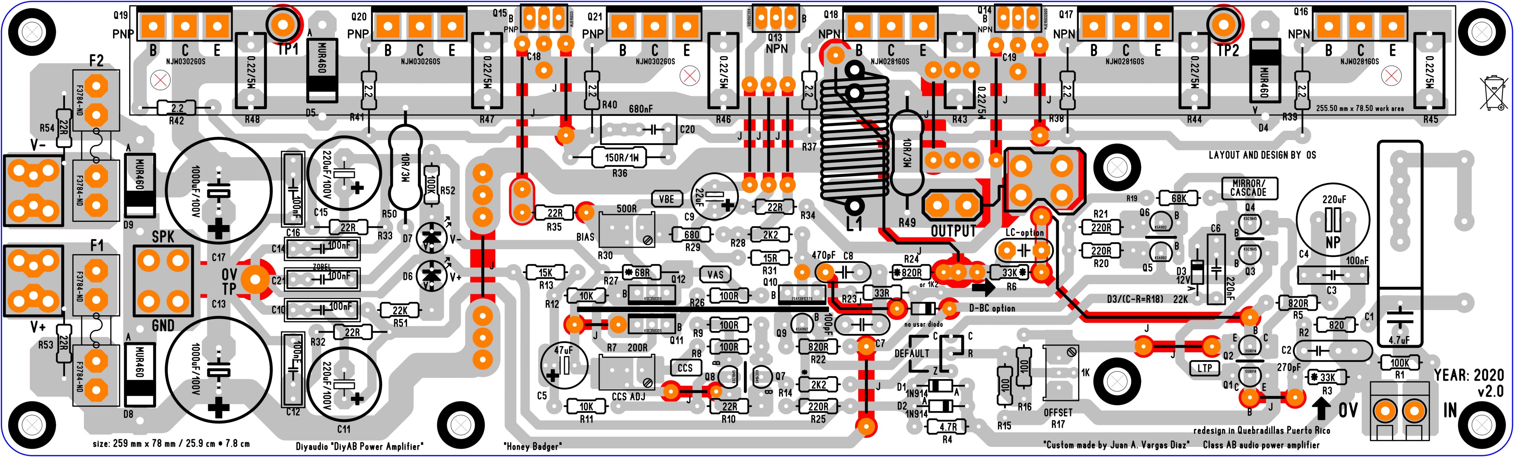

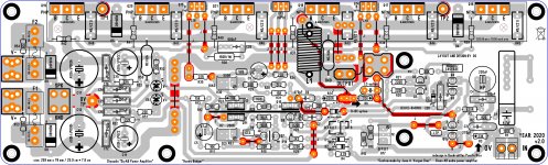

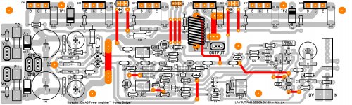

for what I see yes it should work for PDF transfer right?
  • HB PDF toner.pdf
  • HB PDF silkscreen.pdf

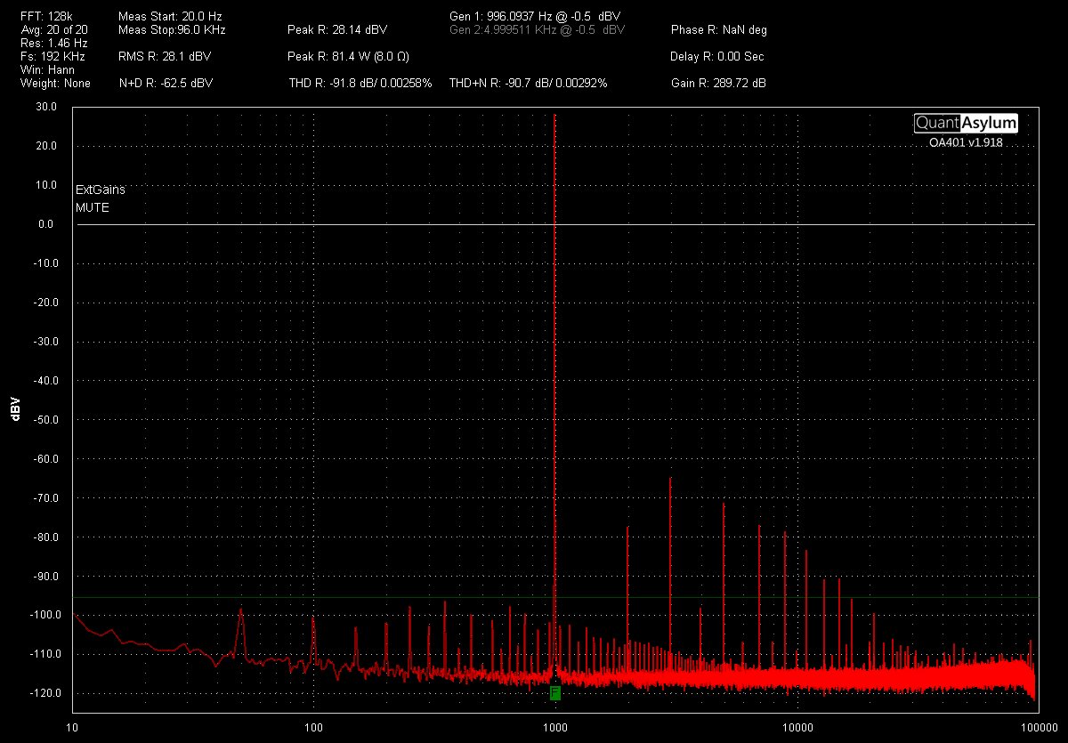

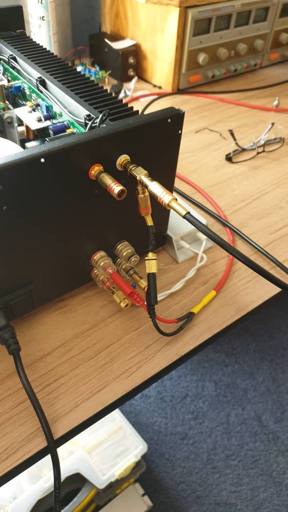

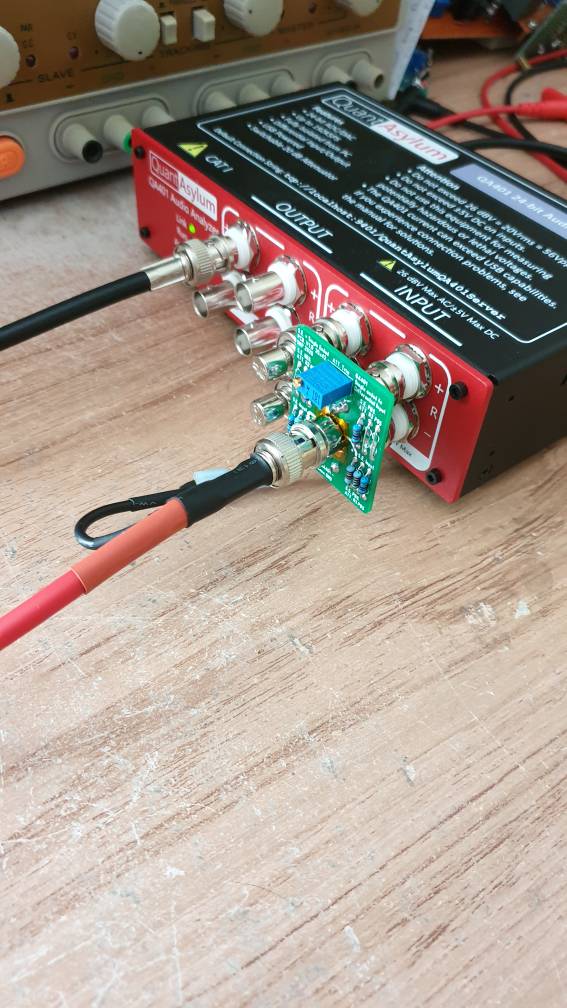

Hi All,
I've made a few improvements to my amplifier including Mu-metal shielding, correct power supply snubber network using the Quasimodo, 240v mains line filter. While also improving my attenuator and measurement technique. I think this is as good as it gets for the HB using standard components. I'm now looking into measuring the loop gain so I can see what the phase and gain margins are.
Then I can look at decreasing the competition capacitors to get more loop gain which will give me more negative feedback which should result in lower levels of distortion.
Stuart%20HB%20using%20new%20Attenuator%2010K%20Version%2080%20watts%201%20Khz.jpg 20201017_075636.jpg 20201017_075657.jpg 20200918_152607.jpg

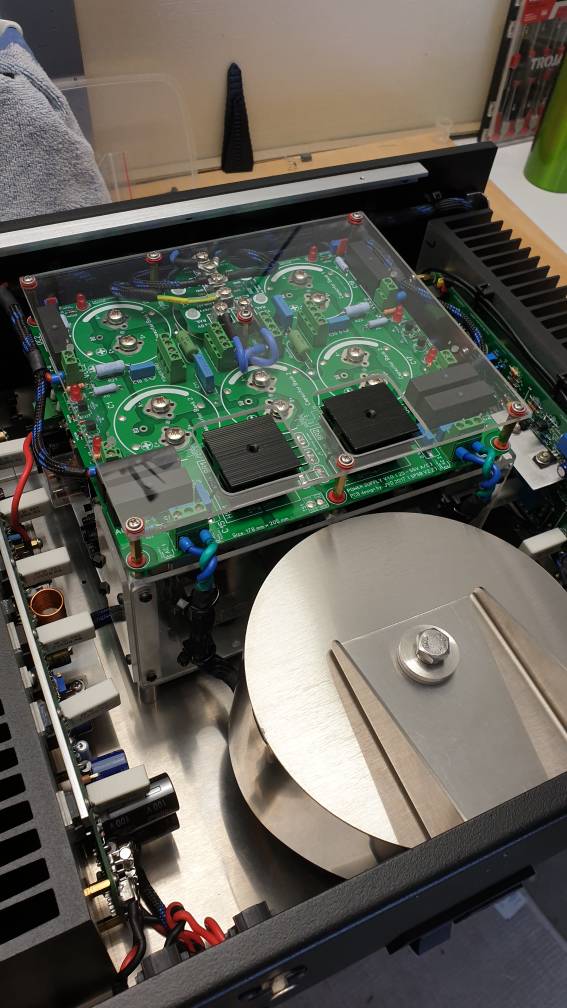

Hello,
I am a new member and have joined to ask for help with an Amp Camp Amp build I just completed. MY let channel audio is very weak vs. the right. I notice that when turning on the amp I hear the caps of the right charge up but not the left. the bias on both channels is 24.3. I have checked solder joints and see no grounds and both boards are the same. the amp is set up as stereo so bridging is not an issue. I suspect one of the caps is the issue but do not have testing equipment to check. I did check all the resisters when I populated the boards and all were in spec.
Any advise would be help. I have built several tube amps and have had now problems but the built has me stumped.
Thanks,
Herb
