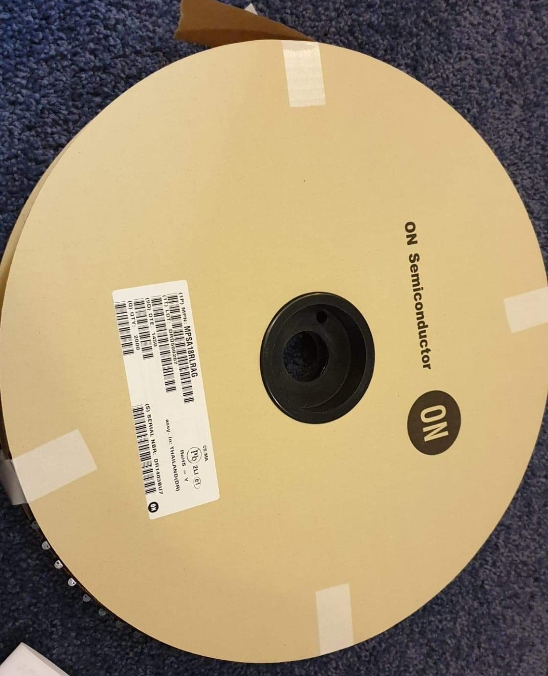

The only MPSA18's that are available that I know of not counting discontinued stock are the ones from Central Semiconductor Corp. The ones I bought from digikey had a beta of about 550.
I have roughly 1000 onSemi MPSA18RLRAG which I bought because I knew that they had higher beta then the Central Semiconductor Corp ones.
The onSemi ones have a beta of about 630. If anyone wants some send me a PM.

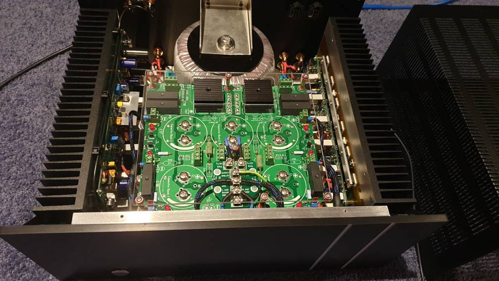

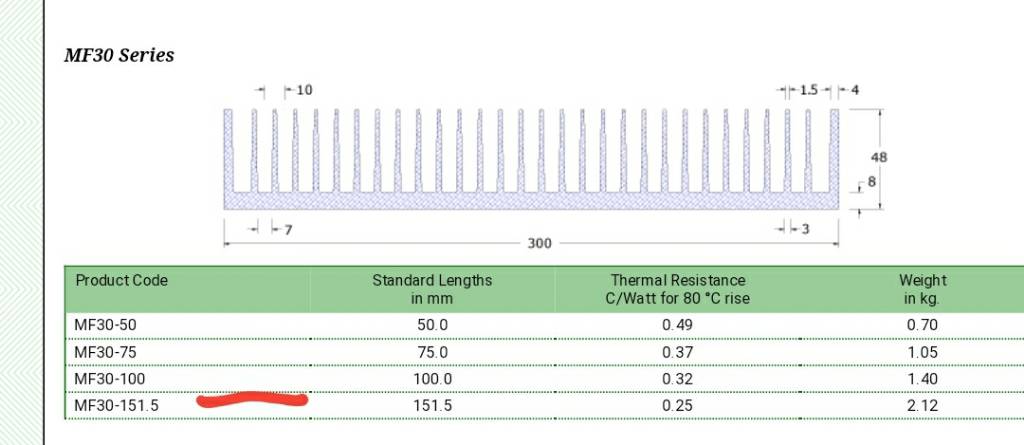

It not really about that it's about the size of the heatsink that you need to provide the right amount of heat dissipation.
Then make a case that will fit that and everything else.
My case is 430mm wide x 375 deep x 180 deep and as you can see it quite tight.
Conrad Heatsinks - Products

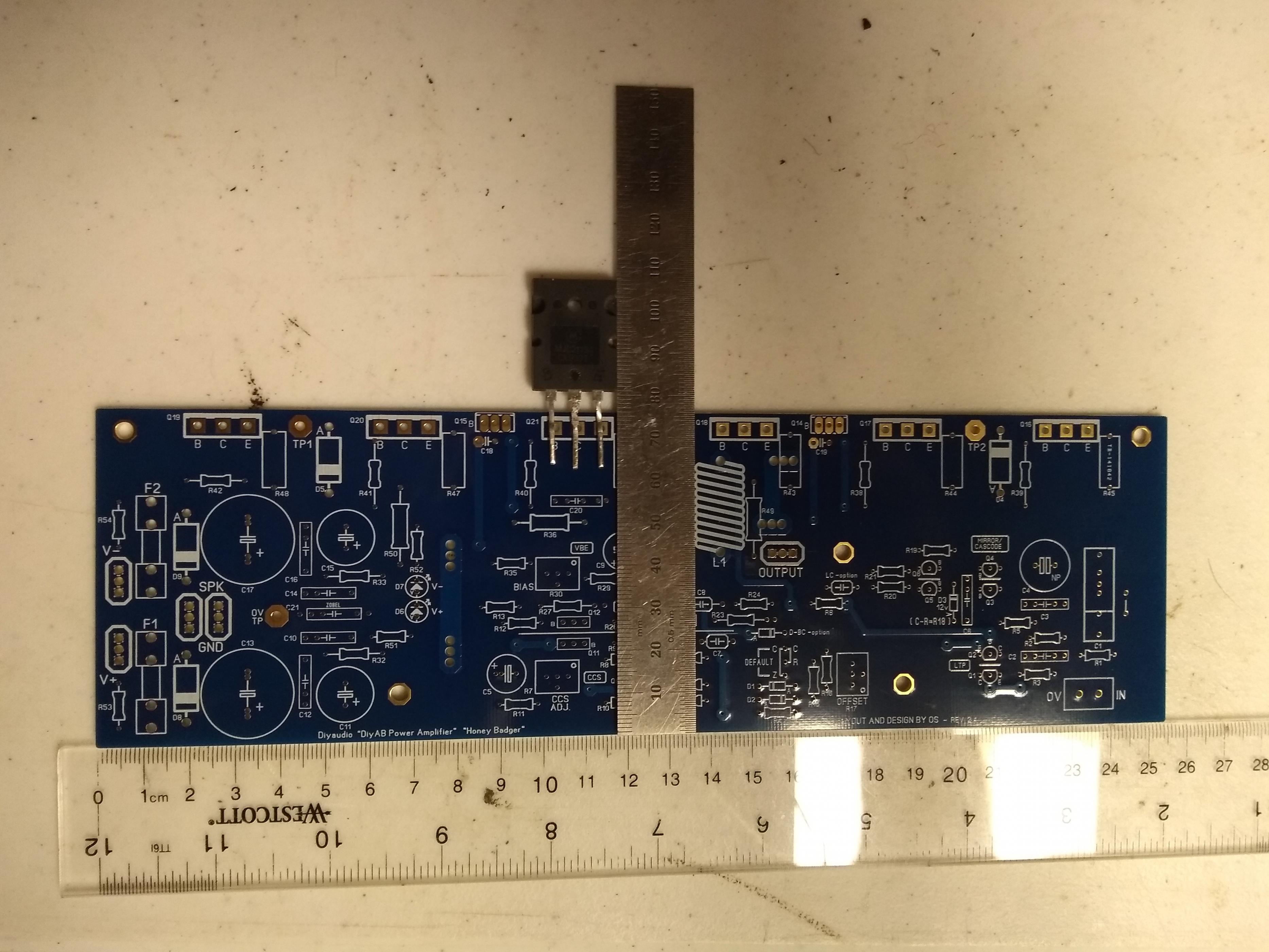

View attachment 858056 View attachment 858060
Hi , thx for the answers.
The format of the pcb will fit but the heatsinks are to small form the job?
Yes, Even the heatsink that I have chosen is not sufficient to run this amplifier continuously at full power using supply rails of 64v DC.Hi , thx for the answers.
Your choices are use a larger case so you can fit the heatsink that I show or reduce your supply voltage.
But be sure to caculate the heatsink that you need base on your expected output power.
3U300mm chassis will do the job just fine. I got 5 ch with 4U300mm sinks from modushop in one and the same chassis (inside the chassis) and have no problem with heat.
The differnce between 3U and 4U is minimal. If you dobble the hight (length of the sinks) you gain only 25% cooling capasity.
