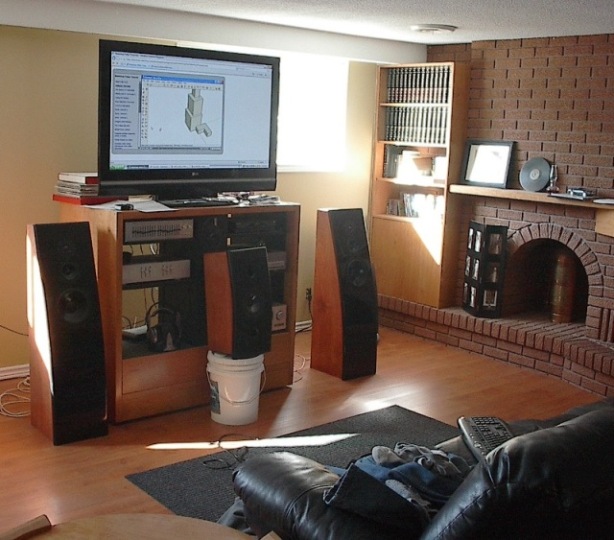

My setup has the centre channel going to the centre channel speaker. This is currently on a 5 gallon paint bucket, in front of the equipment unit that has the TV on top.
I wouldn't even consider sending centre channel to the left and right mains.
With 2 centre channel speakers, one on either side of the screen, the image is projected to the centre of the screen. Beautiful!
