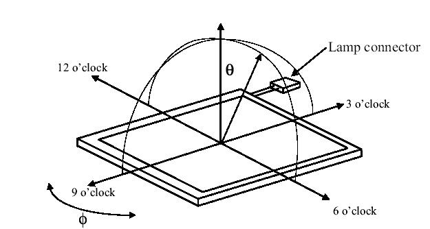

Optimum viewing angle
Just found that for many LCD's the optimum vewing angle is not a straight angle. Instead some datasheets list 6 o'clock or 12 o'clock optimum vieving angles. I'm quite sure my AUO M150XN05 has an optimum viewing angle at 6 o'clock. That means that as a direct view monitor you should look into it at some angle below the midpoint.
M150XN05 lists viewing angles U/D 40/60 which gives a hint to optimum vieving angle being at 6 o'clock.

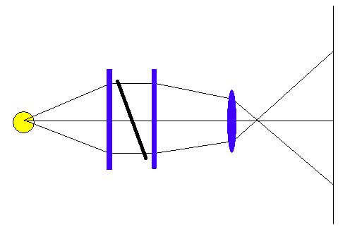

Optimum viewing angle (cont.)
So practically this means that the best possible contrast for a LCD panel is not achievable at 90 degrees angle but less, and the LCD should be tilted. However, that is not bad thing as you can watch your DVD anamorphic and let the LCD tilt take care of the vertical shrinking of the picture so there's no need for an anamorphic lense anymore.
Note that tilting the LCD is just an idea I haven't tested yet (will do it later). I hope that I could increase the contrast from about 400:1 to ~600:1 with my LCD using that kind of arrangement.
(btw. the LCD tilt in picture is for an LCD panel with 12 o'clock optimum viewing angle, you got to think it yourself which way you should tilt your panel)

Excellent catch. I am assembling shortly and will try this out.

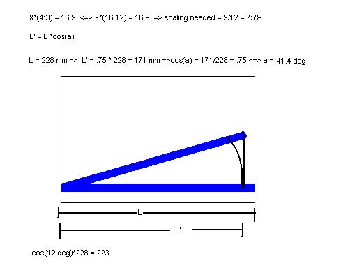

Tell me more about the software option for anamorphic. How come no one has mentioned this yet? I thought the anamorphic issue was more involved than just tilting the lcd?
Also what about focus eveness if we tilt the lcd?
That may be a problem, though in my theory you don't focus to LCD but to the fresnel on it (or slightly behind). However, if you tilt the LCD 10-15 degrees it's almost the same amount (also the same direction with M150XN05) as you do for the keystone correction with the fresnel.
You can view DVD anamorphic practically with all DVD (software) players (PowerDVD etc.). Some players allow you to choose almost any scaling. Maybe it's worth of getting some real test DVD for tuning or burn own test CD / DVD /DivX CD/VCD CD etc.

yeah ive thought in your ideas and still have a few tests to cunduct on the lcd tilting for contrast and brightness, i thought in tilting the lcd forward as then a brighter picure comes out but then the contrast goes and so does the colour, if u tilt it back then the screen goes the opsite way and gets darker and u get more darker contrast, personally i found 0deg the best as in looking strait into it but i think just off set u could be onto somthing here, as i said i havnt fooled with this too much so your da man in this, keep us posted and let us know on your findings,
as for those who dont know the front of a lcd is a vertical polarity and the back is horizontal, manufactures do this on purpoise because the veiwer normally sits right infornt of the screen and not to the side, how ever a lcd will work with the polarity in the oposite direction and some are projuced for certain aplications but the majority are as stated above.

I calculated that tilting the LCD 12 degrees needed for optimum CR with BenQ LCD will have little effect to picture height. It will shrink from 228 mm to 223 mm which is practically unvisible. For anamorphic correction (4:3 -> 16:9) you have to tilt the LCD 41.4 degrees which makes the CR to about 10:1 (really really bad). So it won't work but the 12 degrees tilt is recommended with M150XN05 as well as using split fresnel with this LCD. Going to test it tomorrow.
I can see an improvement in contrast when tilting the panel. Unfortunately I also noticed that my condencer lens was broken and had to take it out (in three pieces), it was propably too close to the bulb and couldn't stand the heat. As a result the image isn't as bright as it was with the condencer.

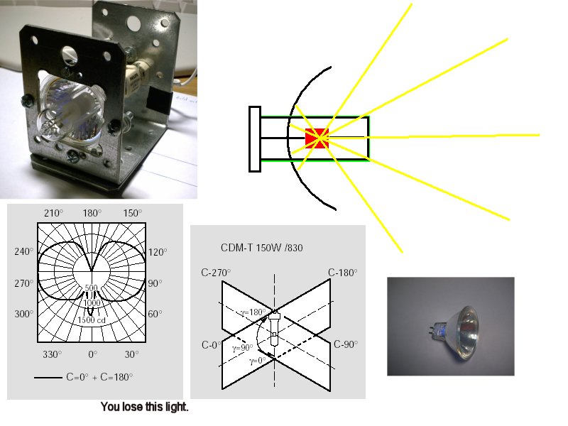

Just another point to support my view on this "pointsourceohitissohardtogetstuffbeforethelcdtowork"-subject:
My own projector project is based on a commercial projector (made by sony), and there is a glass/"lens" right after the lightsource, a similar glass to those that dentists have on their lighting, you know, those annoyingly bright thingies that they point at your face while drilling. Kind of a wavy glass with small squares... After that the light is hardly anything like a point source light or paraller or anything of that kind.
I think that in many setups on this forum the fresnell before the lcd does just the same thing, distributes the light evenly on the lcd. So, iI think that the whole setup before lcd is a very powerful backlight, nothing else.
Regards
HB
Regards
HB
I'll just keep going...
Do not think the LCD as an optical device, lens or some kind of a multicolored weird filter, as it is not. The LCD is the actual object that we are projecting, it is quite simple, there is a real object (LCD in the case of most here) on another side of the (projecting) lens, and a fake object (the image of the LCD) on the other, what is after or before this setup does not affect in the basic "operation" on this process of projection. If the real object is brighter, so is the fake object on the other side. If you know something about optics you should be understanding what I am saying...
Using a point source and fresnel, or parallel light source just means more of the original light is useful, the higher efficiency of the system just means that lower wattage bulbs can be used. I agree it is possible to use flourescents, etc. and still get a good result, but more of the light will be wasted.
Lower efficiency = higher wattage bulb needed = more heat generated.
Steve
Steve
