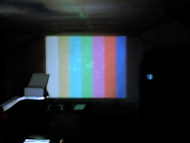

1st Trial Run......
Hi All,
"Happy new year to ya all !!"
I've did my first projector run on Tuesday, everything went fine i just need more wall space !! ;-)) LOL (Screen size 75")
Here is a picture........
Also the bulbs are used in most disco lighting equipment in the uk, would like to find a 400w bulb, but i haven't found any suppliers yet ??
Cheers 4 now
Cosmic023

Hi Verbose,
Yeah i know it's only test bars but then, i was in the process of setting everything up.
Soon as i get round to it, maybe@ the weekend, i'll post some dvd pics.........
Also the wall, the blemishes / marks had just been painted......so that's why there are bright blobs in the picture.
