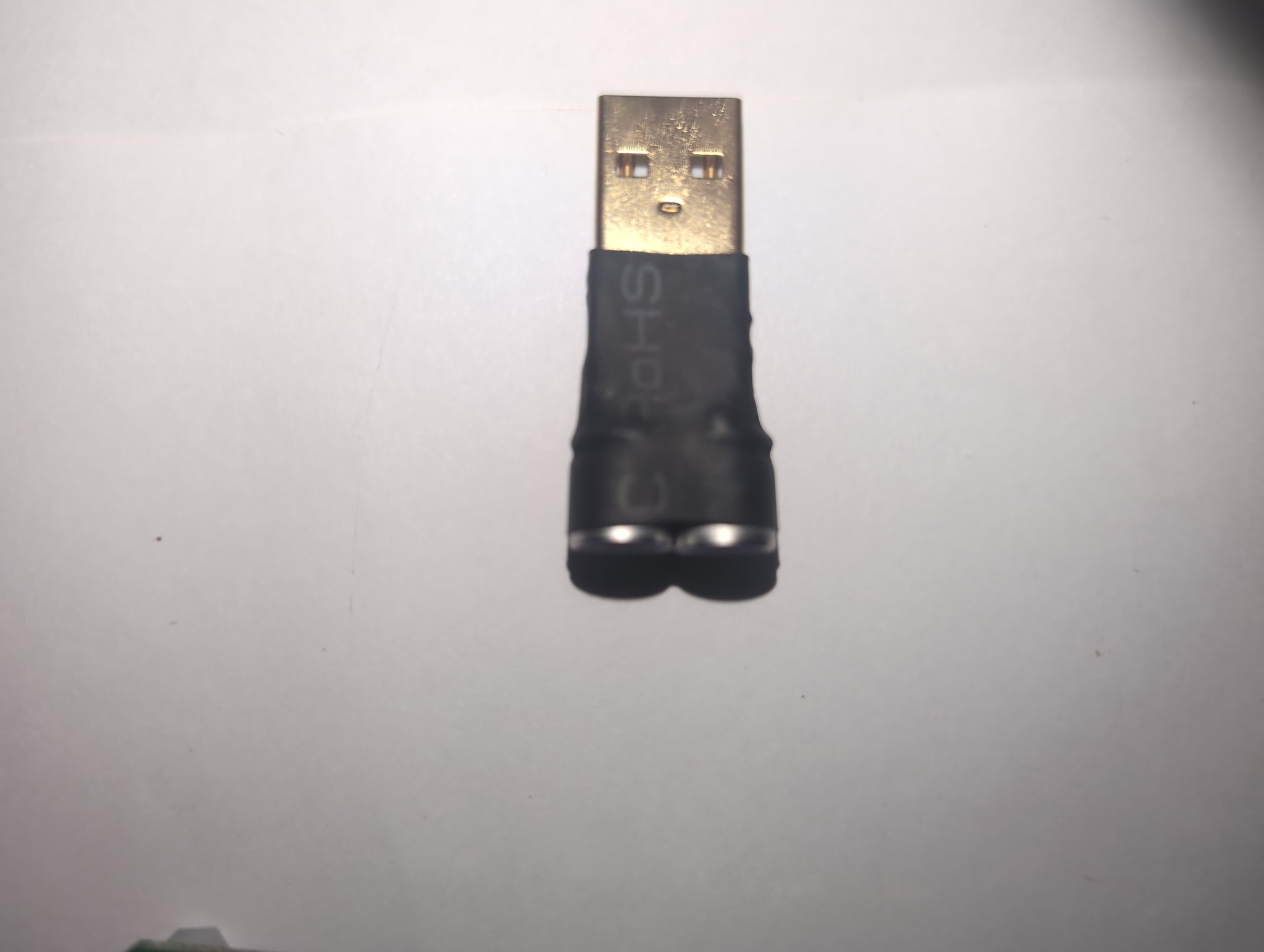

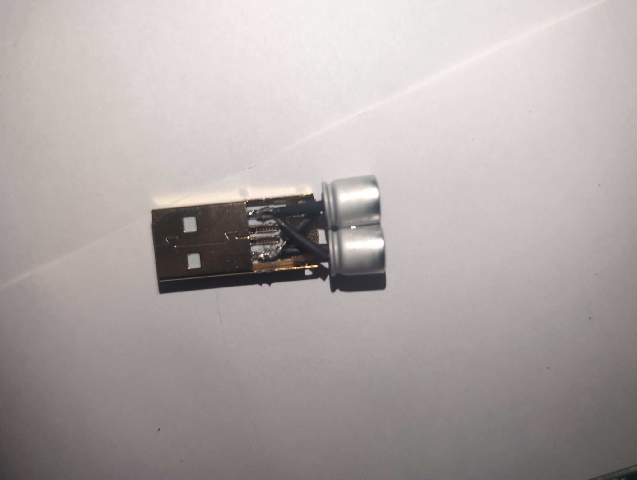

Just builded this with 2 Panasonic Oscon 470uF 16V (i think they are SEPF) to test things in the free pcie card usb slot ...
first tests seem to show that this one clearly beats the chinese usb power filter in the second (free) usb slot
i also fixed the capacitors to the usb port with UV glue... to make it somewhat usable
i will burn this one in for 24 hours and test again
i created yesterday a 1x 470uF version of the same plug, since there first version had uncured uv glue inside which kinda leaked out making a mess
comparison was done today like this:
Ifi isilencer unplugged, usb cable into one slot of the usb pcie card, in the other sockets i tested these three:
imo the chinese one doesnt do much good, ifi isilencer was best here but the 470uF cap connector wasnt far off imo and even seemed to improved bass response over the ifi isilencer, but audibly overall the ifi isilencer did a bit more
my guess is that shifting the frequency down a bit further with more capacitance might improve things but the 470uF cap seems todo already "quite alot" on its own with a cutoff frequency around 3khz
when i place the ifi isilencer before the usb cable than the differences in the filters in the second usb port were diminished (the chinese one pretty much inaudible and while the 470uF DIY plug still improved things (a bit) i would say the effect was diminished with the ifi isilencer in the main slot, which kinda makes sense)
Tho also the ifi isilencer did a lot more on the usb cable than in the second plug... since i guess it also filters datalines... i kinda wonder whether i can reach a point where the ifi isilencer doesnt improve things anymore

- 1x 470uF DIY plug
- Chinese "Quick Silver" power filter
- Ifi Isilencer
depending on how the ifi isilencer filters the datalines the filtration might even improve things in the second slot bringing the noise of the usb chip further down, so maybe thats some of the difference i heared

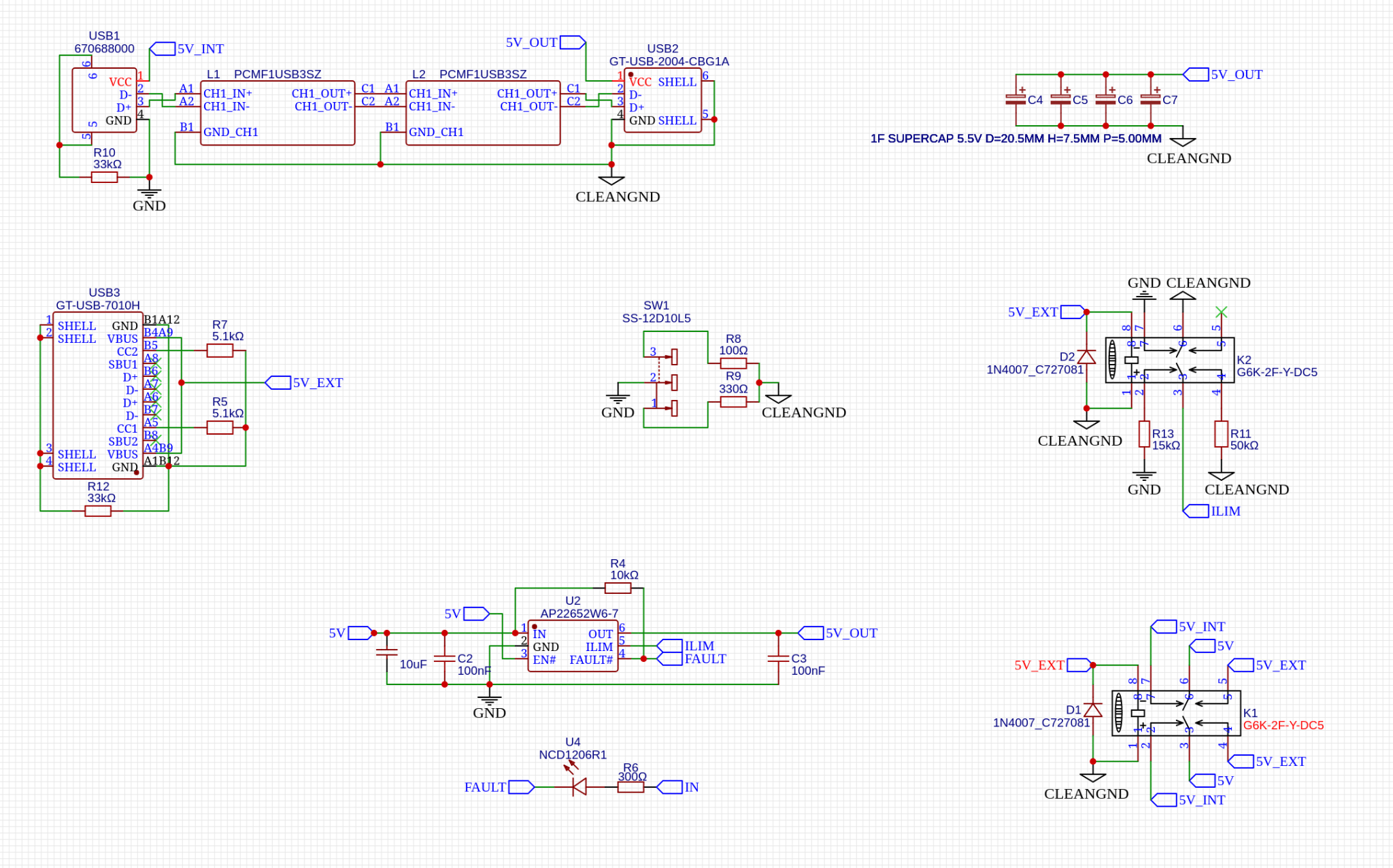

This new revision of the main filter should solve all possible issues in terms of user friendlyness
the two relais consume around 22mA each and get powered by a external power supply (where keeping the 500mA limit of usb ports isnt nessecary)
these two relais switch:
1. switch the current limiting resistor of the power switch from 1A-1,8A to 500mA
2. a GND / CleanGND passtrough (since its not always safe to use PC Power with resistance between grounds, the passtrough is disabled as the external power supply is plugged in)
3. switch from PC Power to EXT Power (these signal relays can do up to 1A, so i used both contacts of one relay for theoretical 2A with 1A - 1,8A limit)
then there is a switch (SW1) to switch between 100 and 330 ohms between grounds when the external power supply is used, for me with multiple dacs i was able to use 333 ohms reliably, so i think these are good values
the power switch, for current limiting, so we can use 4x 1,5F 5V caps with no problems, also with PC Power in theory
the thing i still question is if i should offer a "PC Power" option at all, since it also bypasses the ground resistance making the filter way less optimal imo
this was only a draft i did, so this is not final yet

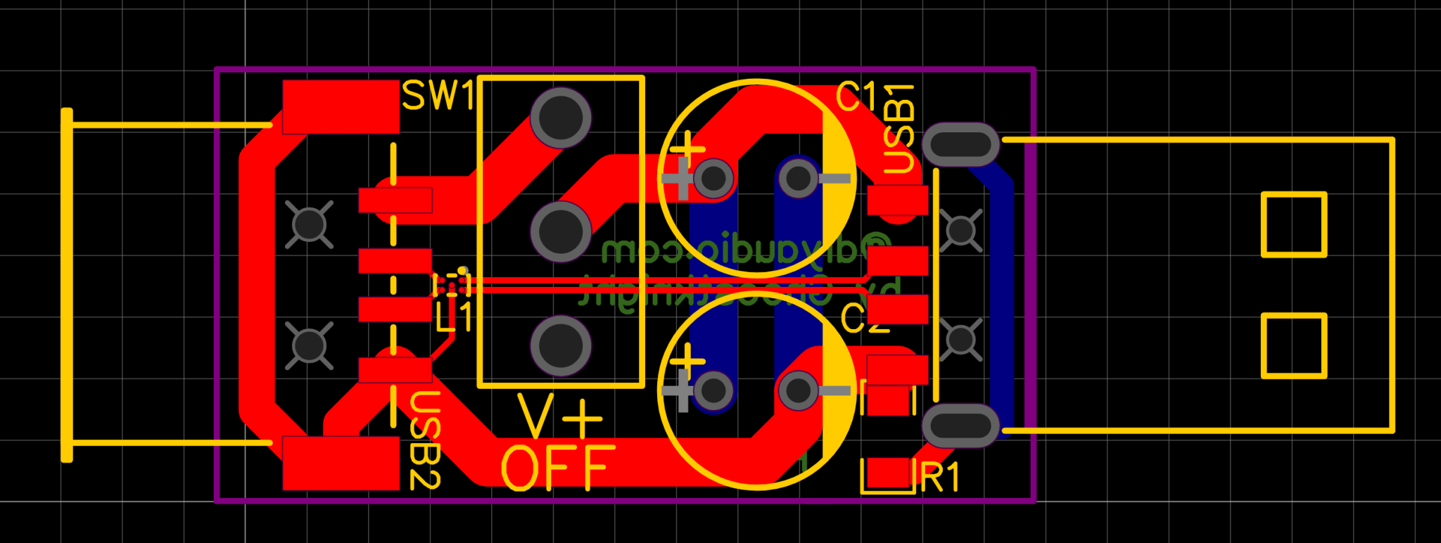

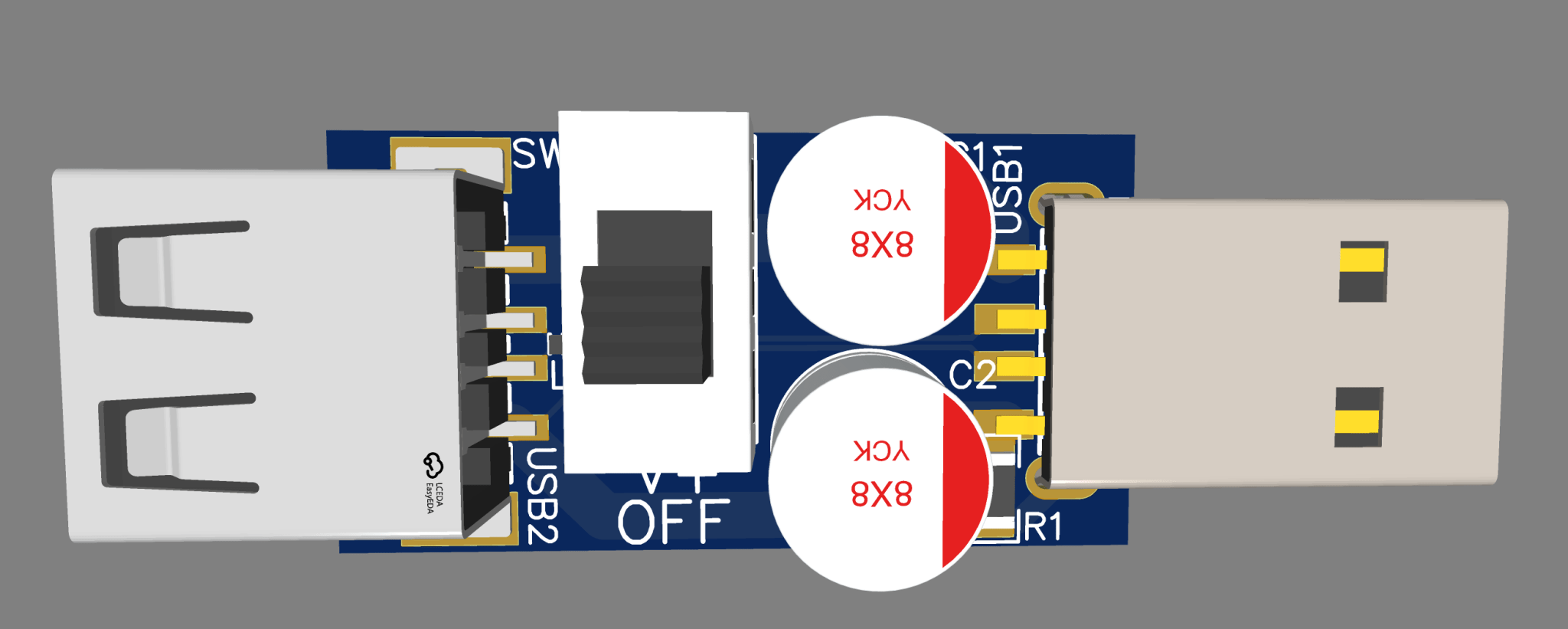

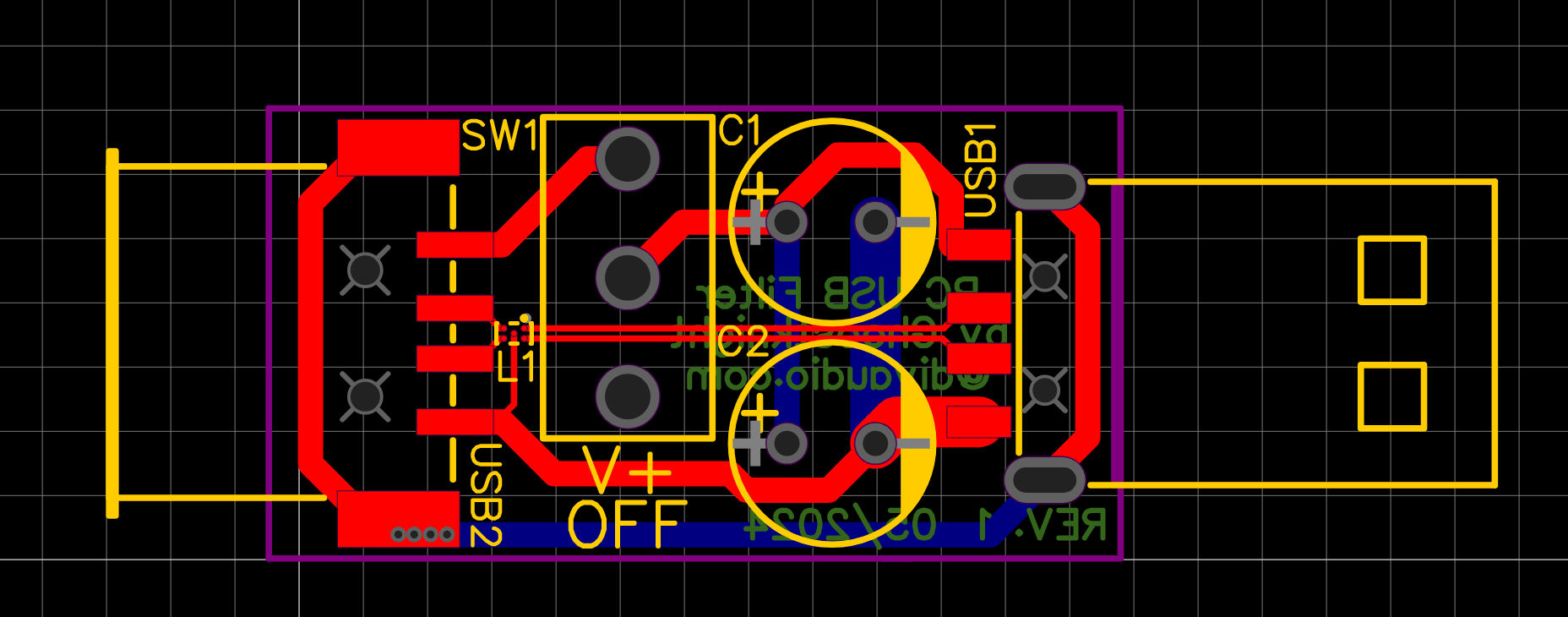

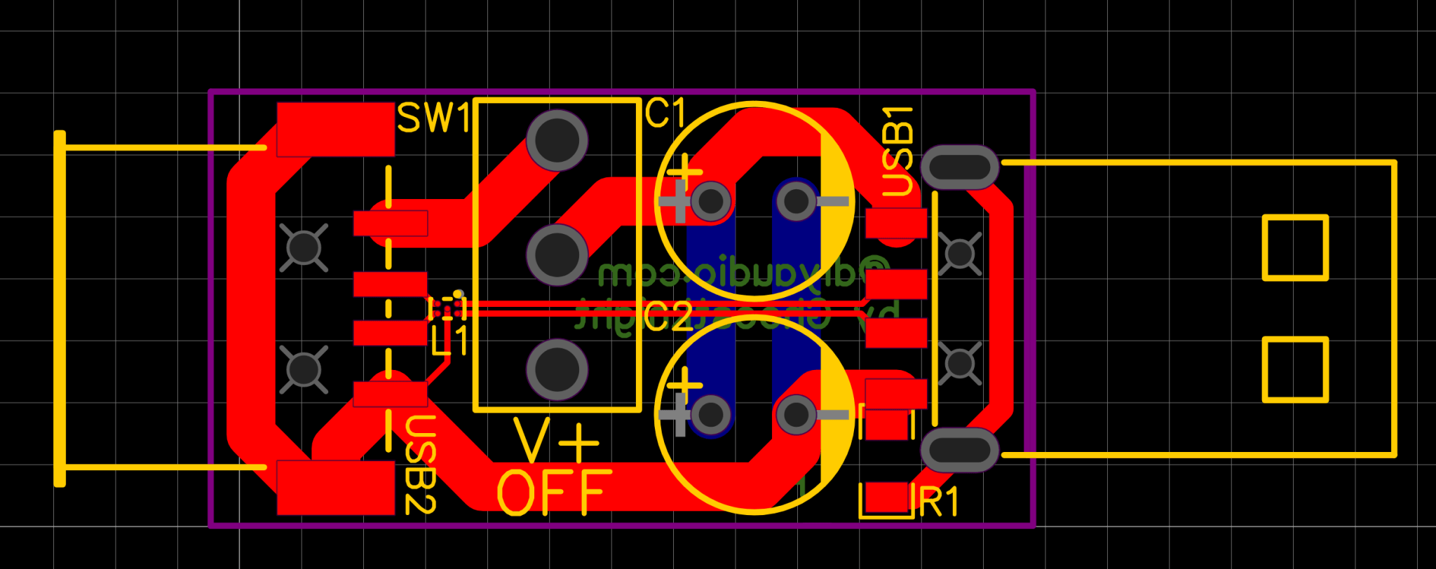

and one update on the sister board:
i removed the shield termination resistor and made this dongle "transparent" in terms of shielding scheme, i think this will be the better approach
main thing which made me think otherwise: the pcie usb card i bought explicitly connects shield of the usb connectors to PC case ground, with this dongle shield stays "shield" and is not connected to the "clean gnd"
termination on the other (dac) end is another thing tho
