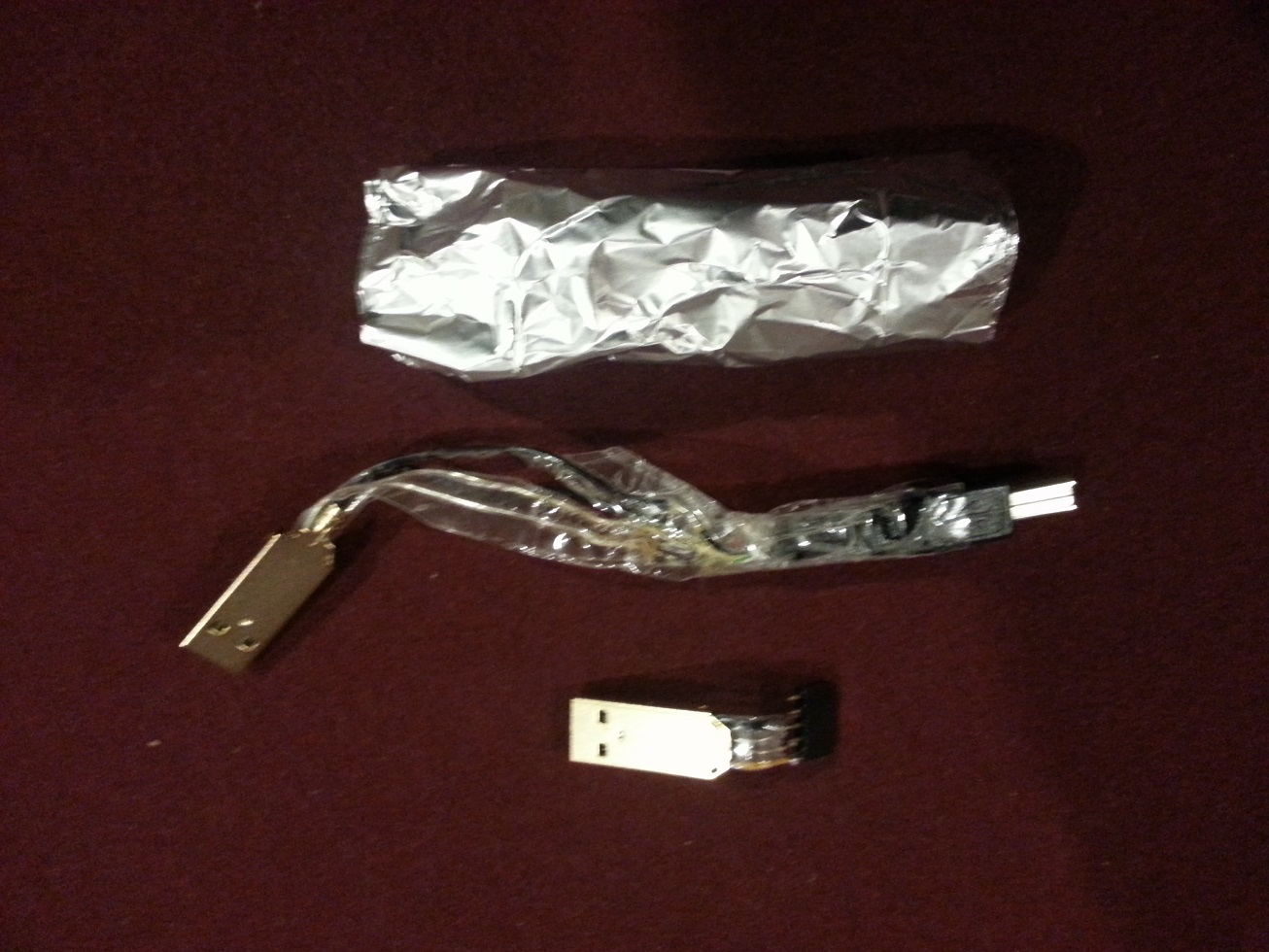

I had the 8" silver in the system. I set up a series of cuts and went through them a couple of times to attempt to understand it well.
I plugged in cable 1. the standard usb cable.
My initial thought was - ****, this is good. Maybe I did imagine this. Now this is going to be a bit embarrassing, but man up and take the heat. I listened to all the cuts a couple of times thinking, damn this is very good.
I put back the 8" copper twisted pair and to my surprise, clearly better. The effect was not dramatic but clearly a fuller presentation. Like when a picture goes up in resolution. Same picture, just fuller, more detailed and clearer.
I listened to all the cuts. Then put in the same length silver cable. Now here was a difference worth talking about. Be clear, I don't maintain its just because its silver. I realize as an experiment I have changed 2 variables, silver vs copper and and twisted pair vs parallel signal lines. The impact of the 'silver' cable is more of a jump to a different level. Stuff that was previously equally detailed now just sounds real. No other way to put it. You could wax on about air and separation etc. Stuff is just real.
Important to note that the cable with the parallel silver lines did not work properly without a shield. bare and open in close proximity to AC cables and a lot of big transformers it picked up some stuff. The result bare is a wonderful music but with some static that sounds just like vinyl that needs to be cleaned. You could swear it was a turntable, static and all. I tried wrapping it in aluminum foil and the static vanished but so did the magic. Not to be daunted I made a 1" tube of foil and ran the usb cable through it with space between the signal lines and the foil. The magic was back and the static was gone. So clearly there is some stuff to play with hear to get it in any way robust. Matters not for me because all this stuff will be inside an enclosure so YMMV.
My final test was to see if a very short cable would work, and if it is any good. This was a bit of a tough test as it required opening the DAC, and leaning the ALIX into it without any attention to EMI (without touching 170v B+). The ALIX locked onto the WaveIO immediately and the music was very good. Actually I left it like this for a couple of hrs and quite enjoyed the presentation.
Now I can imagine there will be many cases where none of this is of any use. For me in my configuration it works well. The suggestion that impedance mismatch and violating the spec does not seem to result in perceived sound issues. Actually quite the opposite. I fully admit the limits of my technical analysis. I do understand that redbook playback in general expects to have data losses and it is designed to do its best to create sound with what it gets. Clearly improvements in CD transports to get more of the bits to the sound chip results in better sound. Could it be we have a similar effect with usb? Does usb have a checkbit. Is it constantly finding errors and re transmitting? One would never see that in a digital transmission. At the end you would always get a bit perfect file. What you don't see is variation in throughput speed based on how many retries of packets to get the message through. I don't know just one thought. I know I keep my buffers as small as possible as the sound gets better with smaller buffer size. Is it possible the short cable is in fact getting a correct packet through in one attempt more often and as a result fewer packets dropped and better sound in the end after the dac happily works with what it has? It does not seem to make sense in an async usb2 world, but then again changes in the pc should not make a difference but it certainly does.

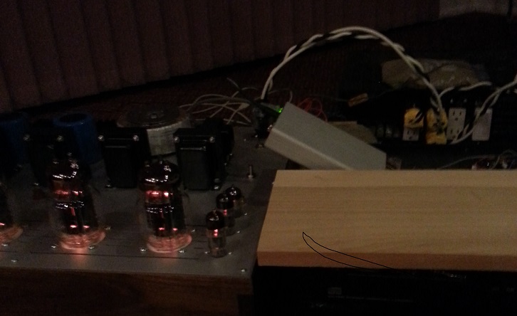

Final pics are the beautifully engineered cable with its fancy foil shield and then of the ALIX taking a dive into the DAC to reach the tiny little cable. Engineering at its finest.
Everyone please have fun with this. I am using the little shortty cable in my new music player and won't be taking this any further.
