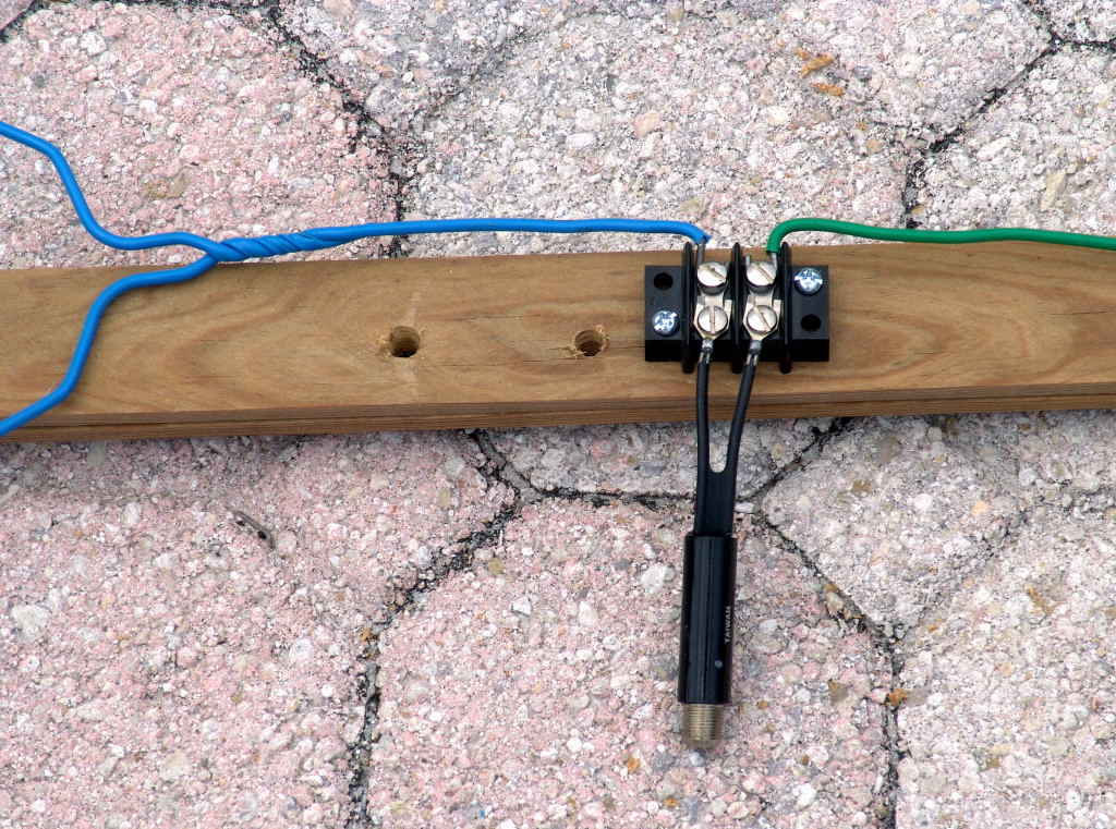

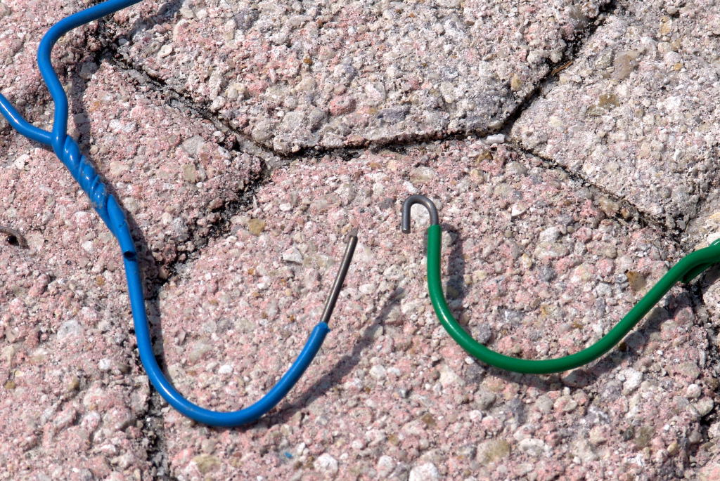

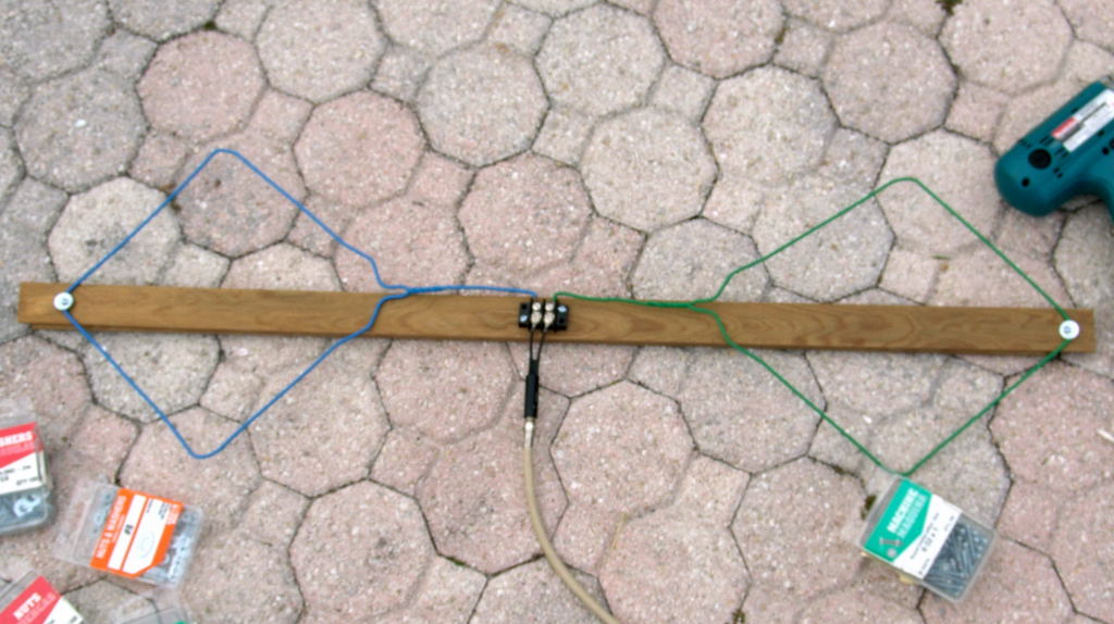

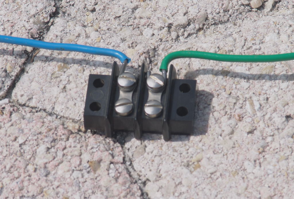

As you were not able to solder the hangers, just put them in terminal blocks, how do you think this will hold up to the weather? Will it make any difference?
I will find out eventually.....
There is a commercial ham wire antenna sold at hamfests everywhere called the "W5GI Mystery Antenna". I have been using one for about 3 years. It uses a "Euro strip" for the connection between the twin lead and the RG59. It is hanging in free space where all the salty rain water that runs down the twin lead drips off. So far so good. I think the center lead of the coax is going to fail first from wind abuse.
The old rhombic that I talk about used a black terminal block like the one on this antenna. All that stuff is OK the PVC pipe got brittle from UV exposure and broke apart.

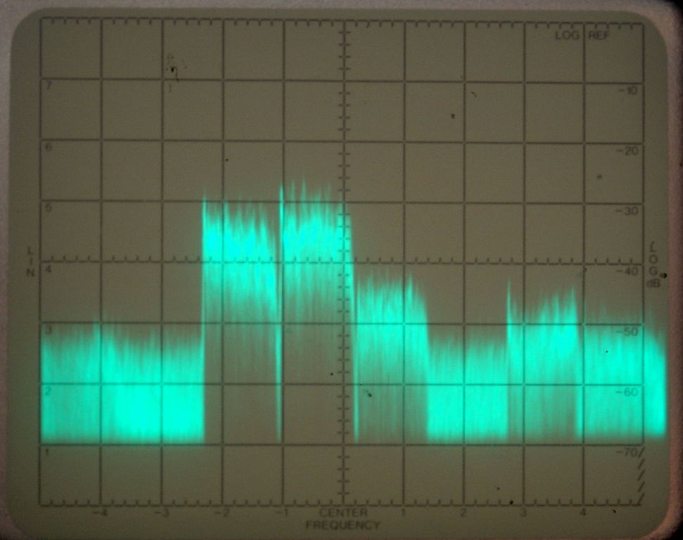

DTV is fine provided nothing in the picture moves!
US DTV allows the broadcaster to use his 6 MHz channel in several different ways. Many chose to run ONE single TV broadcast with 1080 lines and use all of the bandwidth to achieve sufficient data rate so that motion artifacts are visible if you nkow what to look for but not terribly obtrusive at full speed. DVR them and watch frame by frame to understand how the compression algorithm builds a total sceen change over 10 or 20 frames.
Other broadcasters run one 720 line TV broadcast, AND several 480 line broadcasts with low data rates. Our local NBC franchise runs a 24 hour sports channel featuring running, cycling, swimming, and other fast motion events. It is totally unwatchable. You can even read the numbers on the competitors jerseys or see who they are.

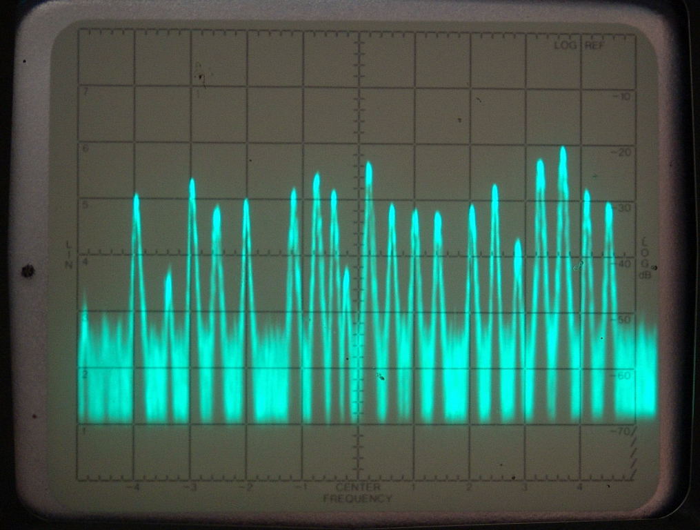

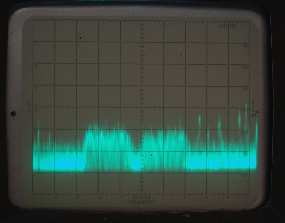

Fired up the breadboarded first stage of my amp today. Very simple circuit. RFMD SPF-5122Z chip, 4 caps and a coil. I think I can eliminate all but the chip and one cap once I switch to DC up the coax cable.
Performance is as good as the data sheet says. NF is .5 db at VHF rising to .6db all the way up to 1.3 GHz and hitting .9db in the 2 to 2.5 GHz region. Gain is a slope from 26 db at 100 MHz (too much, but probably OK with the low antenna gain at VHF) to 20 db at 1GHz and 11 db at 2.5 GHz. Measured with an Agilent N8975A noise figure analyzer.
IIP3 is +8dbm at 100 MHz, +15dbm at 400 MHz, and +19dbm at 1GHz. Measured with two Agilent E4438C ESG's and an Agilent E4440A PSA.
Input return loss is at least -10db across the TV band and drops to -8 at 100 MHz. Measured with an HP 8753 network analyzer.
I plan to test both amps cascaded with 40 feet of cable between them before deployment.

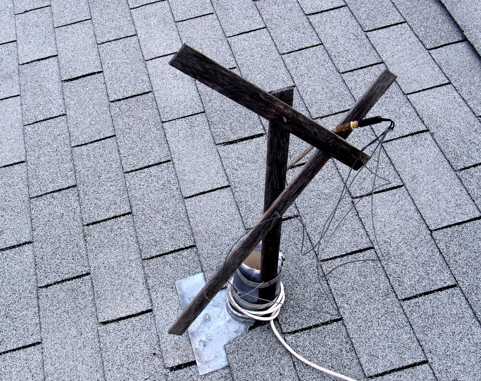

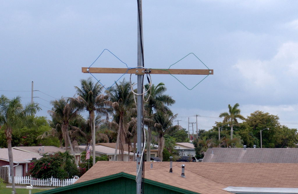

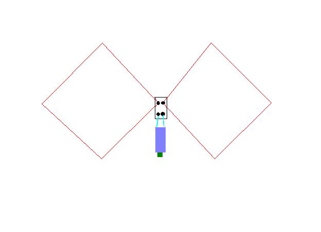

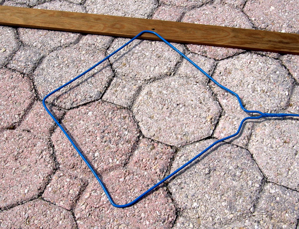

I made two prototype boards 4 years ago. One had a 4 to 1 balun transformer on the input, and the other didn't.
I stuck the transformer version on the coat hanger antenna 2.0 to see what it would do. It was mounted outside at the antenna so the feedline losses would not add to the system noise figure. It rammed so much signal into the Radio Shack distribution amp that it was overloaded with its gain turned all the way down. I removed the distribution amp and connected the output up to one TV. The low noise amp allowed excellent reception of the two TV stations in Port Saint Lucie that were previously seen on the spectrum analyzer, but too week to be decoded by the TV set. There were a few new weak TV signals visible on the spectrum analyzer that were not visible before. The Radio Shack amp with 50 feet of cable in front of it had virtually no gain above 700 MHz but cellular LTE was very strong at 720 Mhz and two way radio and cellular CDMA were strong at 850 MHz. The new amp displayed all sorts of signals with the twin coat hanger antenna up to 2.4 GHz. IMD products were still visible on the spectrum analyzer from the strong local two way radio and cellular signals, but they were weaker than those produced in the Radio Shack amp
I removed the outside amp and returned the system to its previous configuration because I had no suitable enclosure for the outside amp. Since then I have not used either of the prototype amps. I lost my 41 year job at Motorola last year, packed up and moved 1200 miles north.
