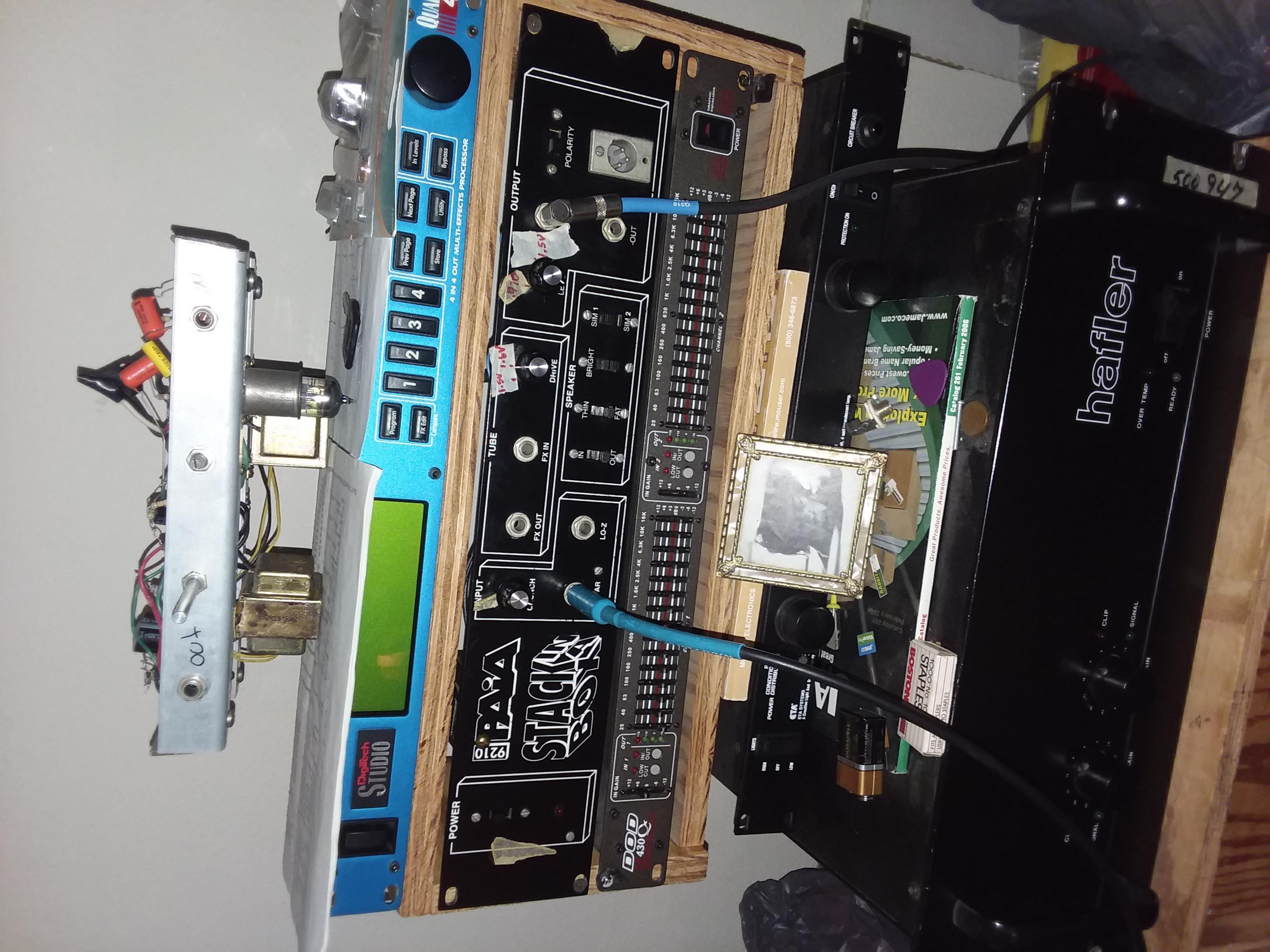

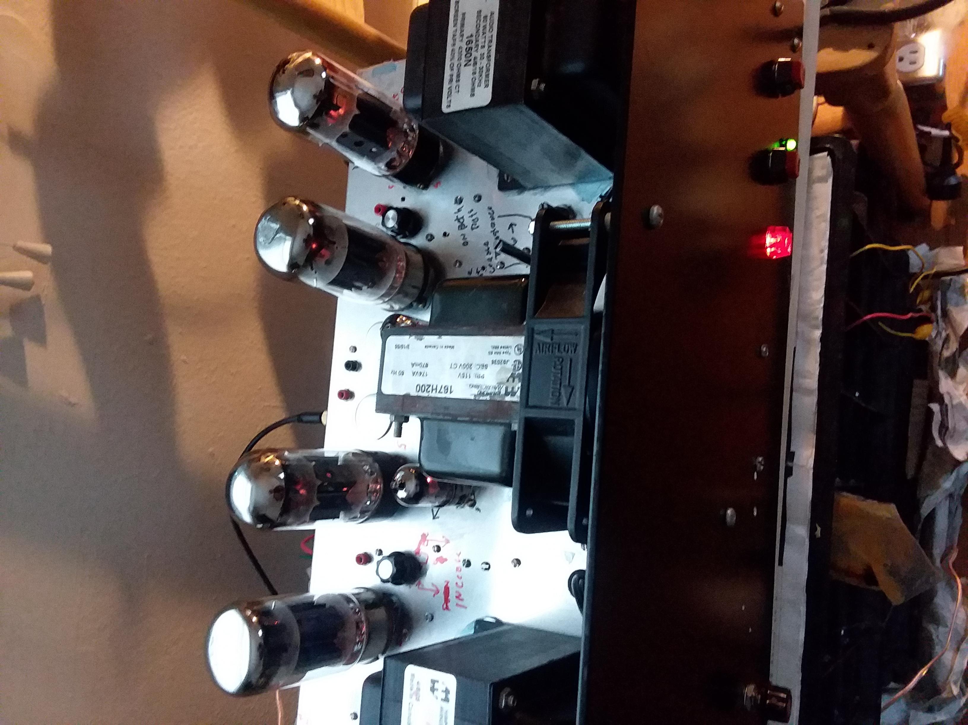

i have been using this 60/60 watt power amplifier as a test bed for different guitar pre-amps ( one is enclosed in pic) each channel put out around 60 to 65 watt rms. next i will build a tube stereo pre-amp to mate with the 60/60 monster dusk

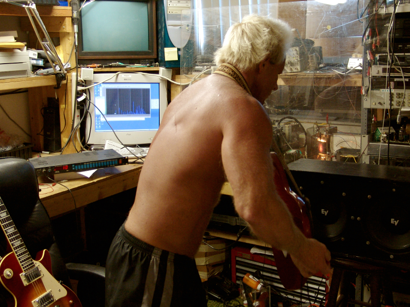

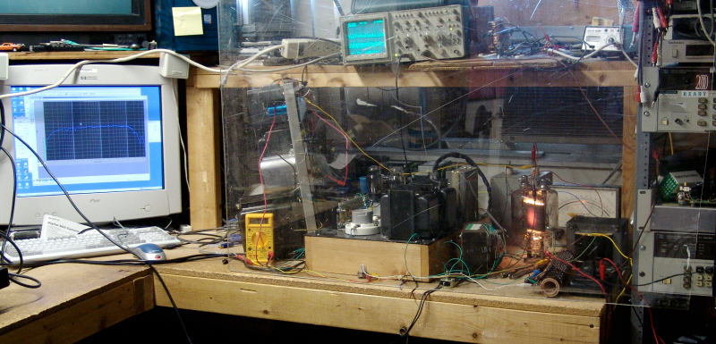

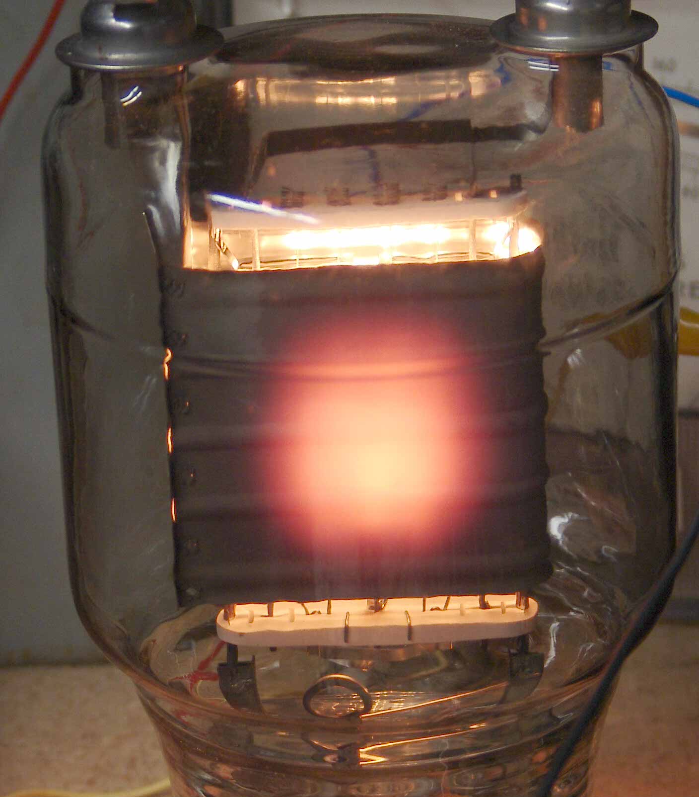

Crazy, no, crazy is wiring up a 1500 volt power supply to a (US) football sized transmitting tube (833A) with Radio Shack clip leads, connecting up a cabinet with a pair of EV-10 speakers, and plugging an ADA MP-1 and a guitar into it. The results could be heard for about 3 city blocks, especially when I held the guitar up to the speaker for some line breaker tripping feedback!
Note the unique tube socket. Hose clamps and Vice Grips. I made a real frequency response graph too at about 50 watts output. Power at 5% was about 200 watts. Power at overdriven clipping......don't know it blew the 15 amp line breaker.
