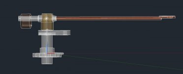

and drawing model DIY TA HD:
model used the HD arm bearing
Model used HD motor

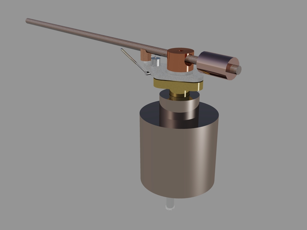

Model used HD motor
just discus only

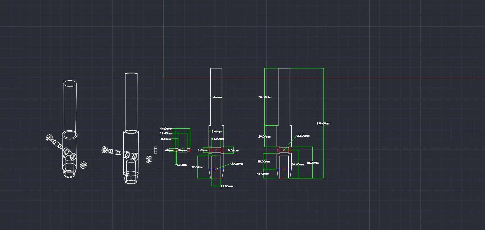

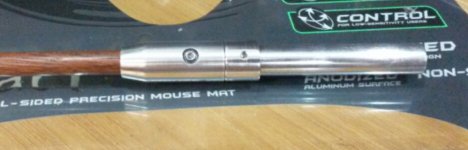

Used arm bearing from HD
dimension draw
make a pivot pole. HD bearing is used as a buffer for horizontal movement.
Bearing of pivot rod use usual. our can use a part of tamiya or other. for vertical movement.
dimension draw
suwaned,
The arm in the photo uses an HD bearing for the horizontal pivot and CD carrier bushings for the vertical. It works OK, but I prefer modern ceramic hybrid bearings.

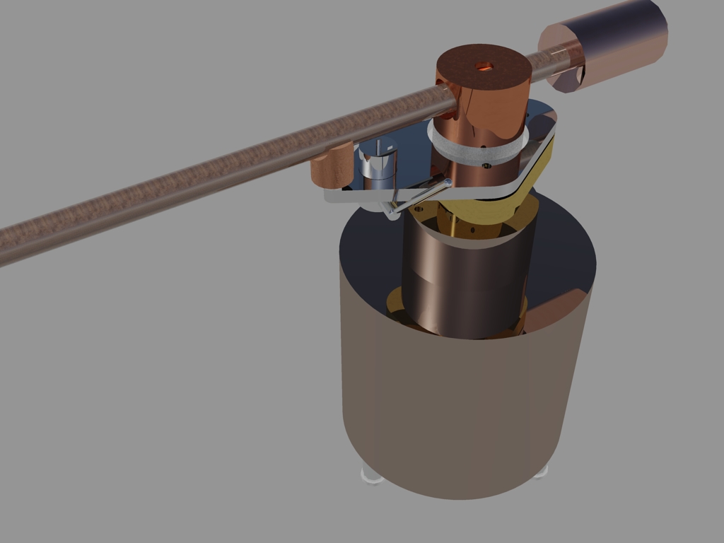

This is pivot , my first project I had made separate :

My dream to get a long tonearm, as I have already tried to modify the techincs arm to replace the aluminum pipe to the wood. i have a problem and I think must to made DIY TA.
In my first work this, later i wanted to make a simple to use HD bearing arm which I think is very good because there is no movement, but I have difficulty when making the pivot for vertical movement. So I tried to make a little complex.

I have already upload video , how are the pivot spinning?
It is stability
[Diy HD bearing tonearm - YouTube]. https://m.youtube.com/watch?v=8jtaDzs4cnE

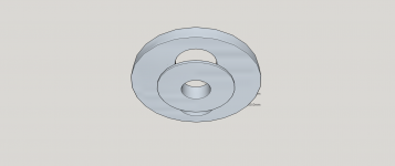

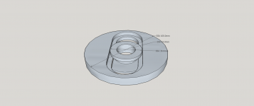

Here is idea I had for arm board for Rb300 threaded style arm mounts.. The center piece is solid and user drill for the arm.. The bottom washer compresses against the main piece..
