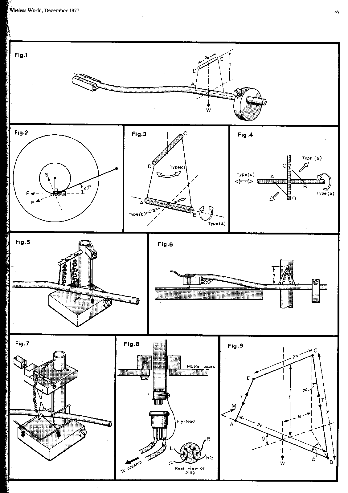

I see the Well-Tempered arm has been mentioned a number of times. Here's its progenitor.
